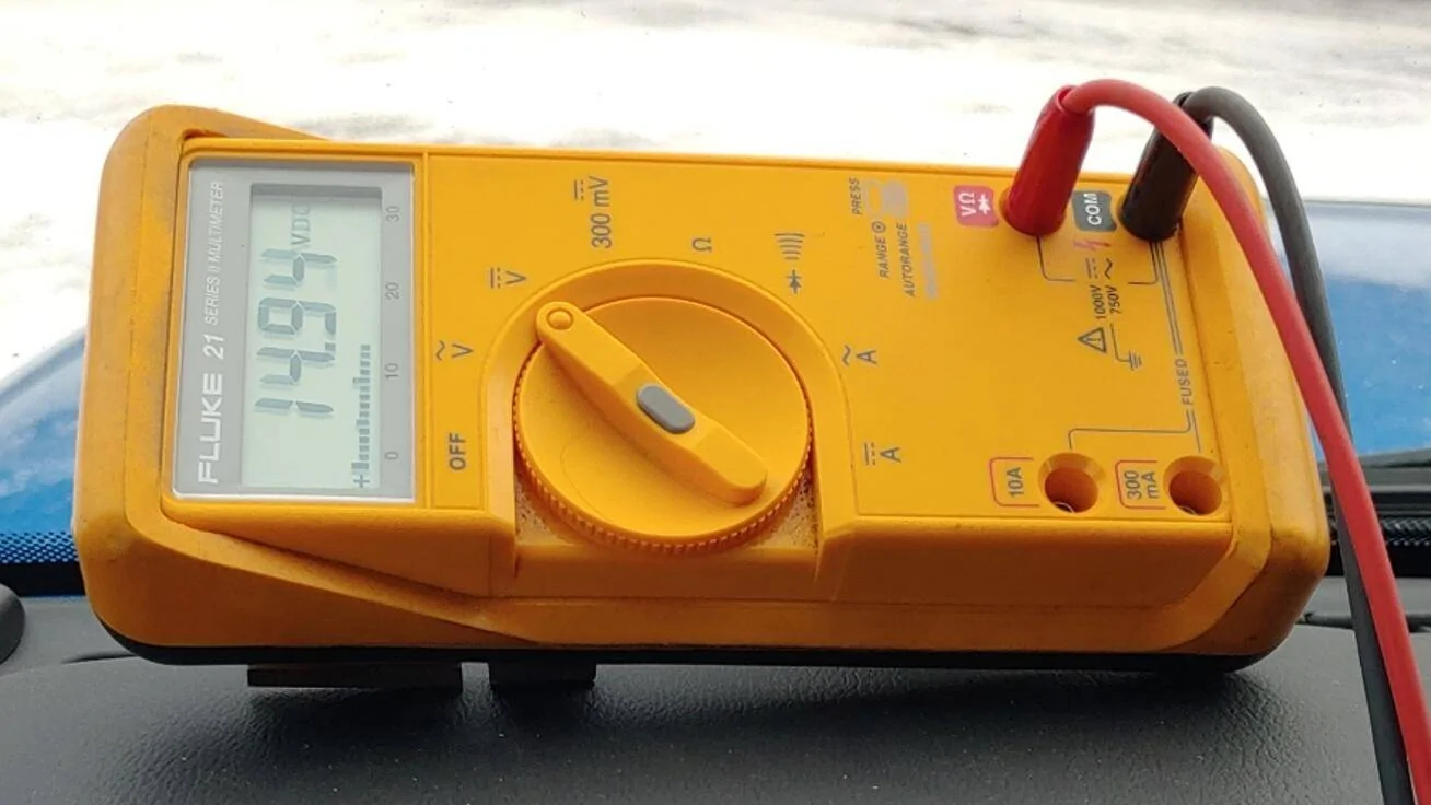

Mine is an antique 21.

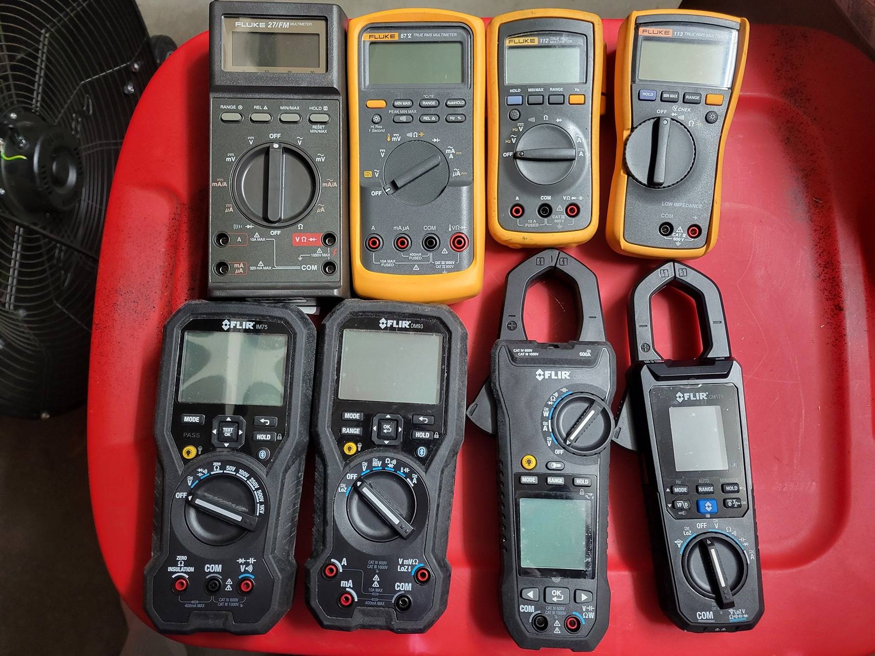

The rest are Micronta of various ages (5 of those) - then the small oscilloscope and a larger engine scope from the 70s.

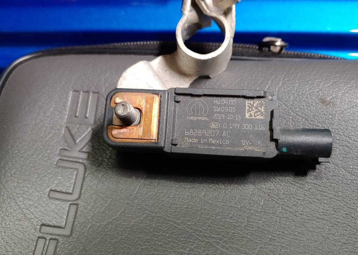

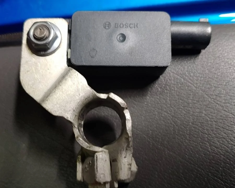

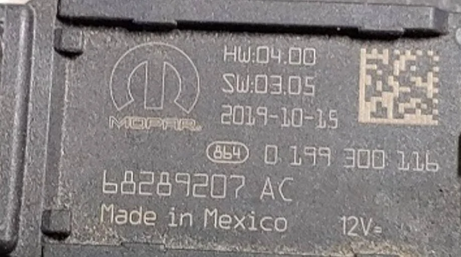

For $60 or so bucks for a IBS sensor, I wonder if its worth the try to replace before heading to dealership? Looking it up on OEM Mopar parts and this is the part number they say
68289207AC
That's the one. Matches the part number on mine.
Thank you. Ordered one and will be here next week. This is such a frustrating gremlin to diagnose. Even after I had the electrical check test load of battery and test loading of alternator, the 20 minute drive home, the voltage never topped over 14.4V and was mainly in the 13.2V range and never set any DIC messages for any issues. In fact when I got home for shits and giggles, I hit the key fob to do a remote start, and it worked. That hasn't happened in the last 2 days. It always had the horn beep once and nothing. Nothing on the DIC said why remote start didn't function like low battery warning etc.
No codes no nothing.
That series of FLUKE's were built like tanks. I had a FLUKE 23 green body one of the same series bought off the MATCO truck in 1992 that was my daily use for over 20+ years when I was a flight line Avionics Tech. Only multi-meter that I actually wore out. Even the Cal-Cert techs called me asking about it because they had never seen one that will used. Sad day when it would no longer hold calibration and was economically unfeasible to repair.

Went out to the truck today, remote start worked, blower motor worked, headlights didn't flicker and the voltage never fell under 13.2V at idle to 14.2/3 while at 1000rpm or at 3000rpm and no warning lights on the dash. Its like nothing ever happened. WTF???? If your broke, stay broke so I can fix you vs trying to chase a Ghost.

I have a couple 87's and a 77. They all collect dust and I pulled the batteries. I was too scared to loan them out when asked to borrow a meter. I purchased a handful of cheap Fluke 101's. Passed them out to all the kids and son-in-law a couple of Halloweens ago. So no matter where I am, there is a meter close. If I ever need an 87 or 77, I'm working to hard.

The FLUKE 87 is my primary. The 112 & 113 I picked up at the flea market dirt cheap. The 27 I bought out of nostalgia as that what was issued to me when I was in the Army.
The FLIR stuff mainly came about because I had a niche need for a remote meter with Bluetooth function.
Desk jockey now at work mainly so all of them see little use unless for home stuff. I do have a calendar reminder set for every 5 years to swap the batteries out though. :)
Funny you mention a FLUKE 101, that is my desk meter at work. I probably have another 4 or 5 cheapie meters scattered about.
I may have a meter hoarding problem.
