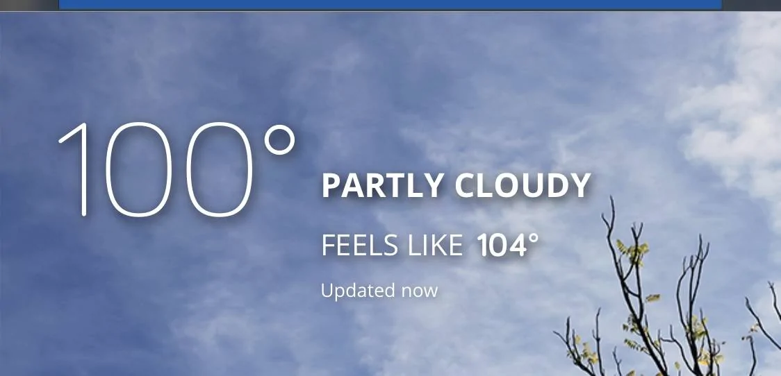

Well, it’s done. It was easy, but hard for me, as I am grossly out of shape due to recovering from a wreck earlier this year and this heat didn’t help. Interestingly, I have the tow package and Aux switches and I had the smaller factory main battery. I was surprised, as I just went and bought the big one. It fit with no problem though.
Jeep Gladiator Most likely time for a new battery? IMG_8197
