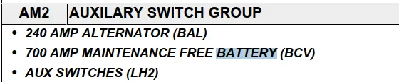

Any chance you have the correct battery number
40,500
54,020
My main battery is showing 12.7 volts at rest. But still getting the start/stop message of battery charging. Have not checked the voltage on the aux battery yet. Is it easier to take it out from the top or the wheel well? 21 Ecodiesel
You can check voltage by simply removing the aux ground cable from the top of the IBS and then measure at the end of the aux ground cable and top of the main battery positive (since they are in parallel the +'s are together electrically)
Diesel main batteries are bigger. Aux batteries are the same. You can upgrade your gasser to the diesel size battery by removing a piece in the bottom of the battery box.
Only if you didn't get the aux switches.
The gassers come with two possible main batteries. You get the largest that will fit the tray when you buy the aux switch package.
Without them you get the smaller of the two.
So my main battery should be the same as the diesel main battery.
It's the largest that can fit the tray - there's no spacer.
Because I don't know. Are the diesel batteries any different than the gasser ones?
Only if you didn't get the aux switches in the gasser. If you did, they are the same.
It's in the ordering info.
I've had one of each, my 2022 has the largest battery that will fit the tray.
My 2020 without aux switches had the smaller battery.

So I have the aux switches in my diesel. Non Rubicon if it matters. Again does anyone have a part number or the battery size number?
40,500
54,020
This is all I can find but I know I've got the sizes/group numbers of the batteries written down somewhere.........
