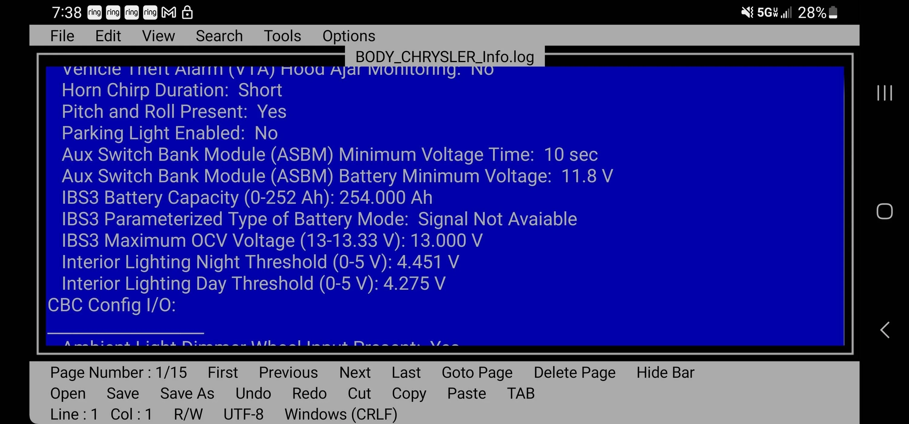

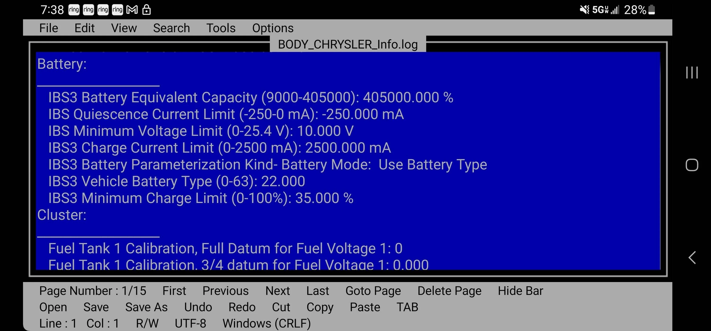

There's battery stuff in Alfa...I wonder if this can be adjusted?
Jeep Gladiator Time it takes the alternator to fully charge a nearly dead battery Screenshot_20230923_073837_OldSchool Editor
Jeep Gladiator Time it takes the alternator to fully charge a nearly dead battery Screenshot_20230923_073807_OldSchool Editor
