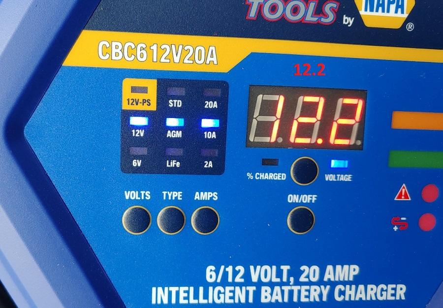

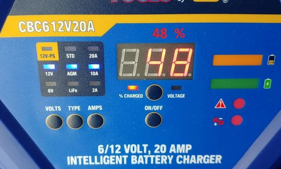

Here the charger says that 12.2 volts is 48% charged. That's pretty much in agreement with the chart below.

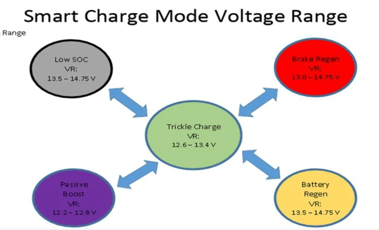

Here are some possible voltage ranges based on what the PCM has decided is needed. When you need power - the engine needs all it can muster, the field current may be cut briefly, dropping system voltage into the 12s (purple)
If the batteries are at or near 100% SoC, it may go into trickle charge mode just to maintain them.
AGM also require very different charging processes than standard flooded batteries.
This is from MOPAR tech documents -
