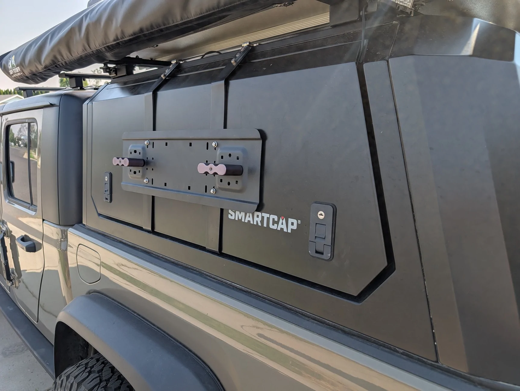

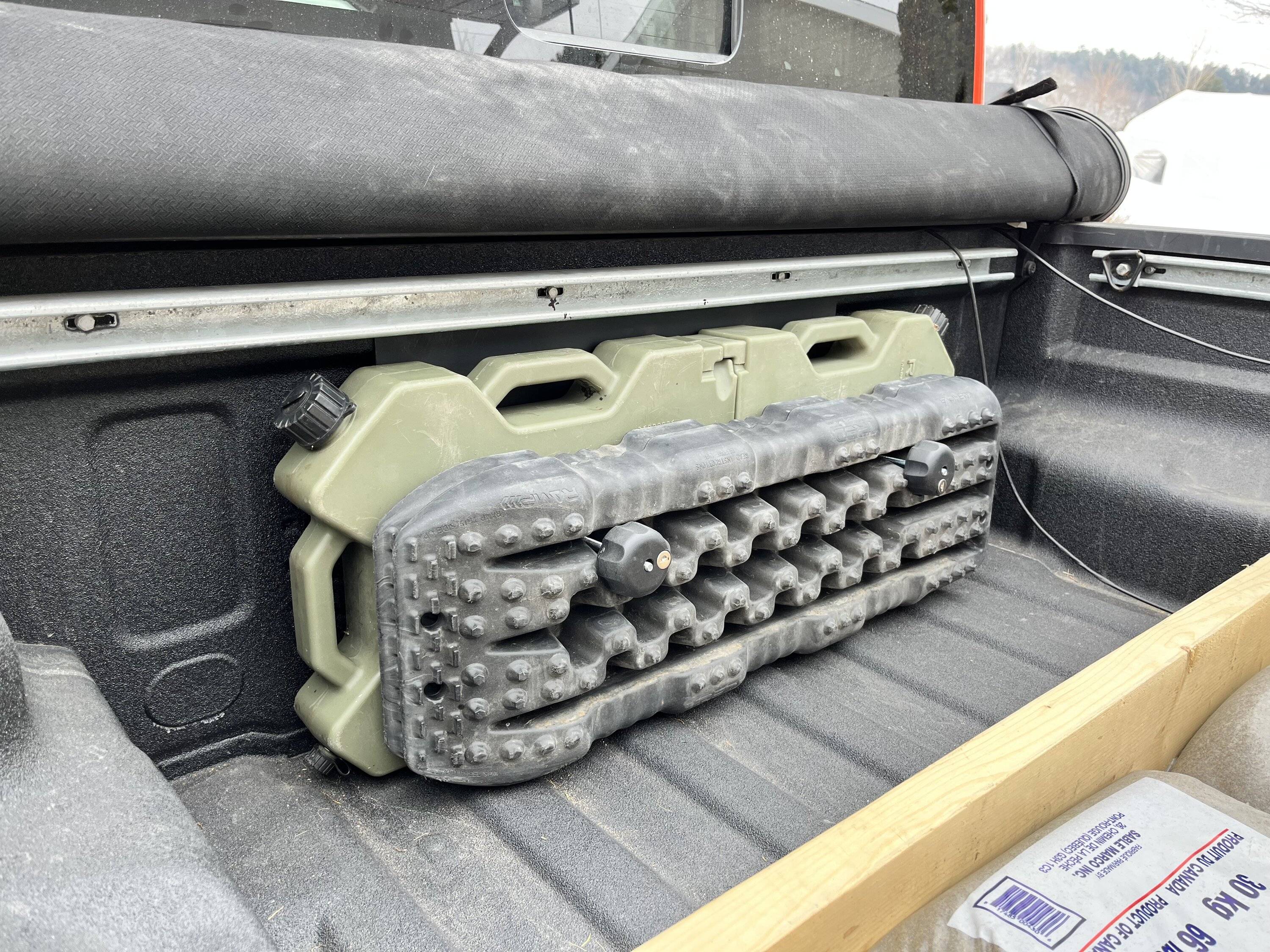

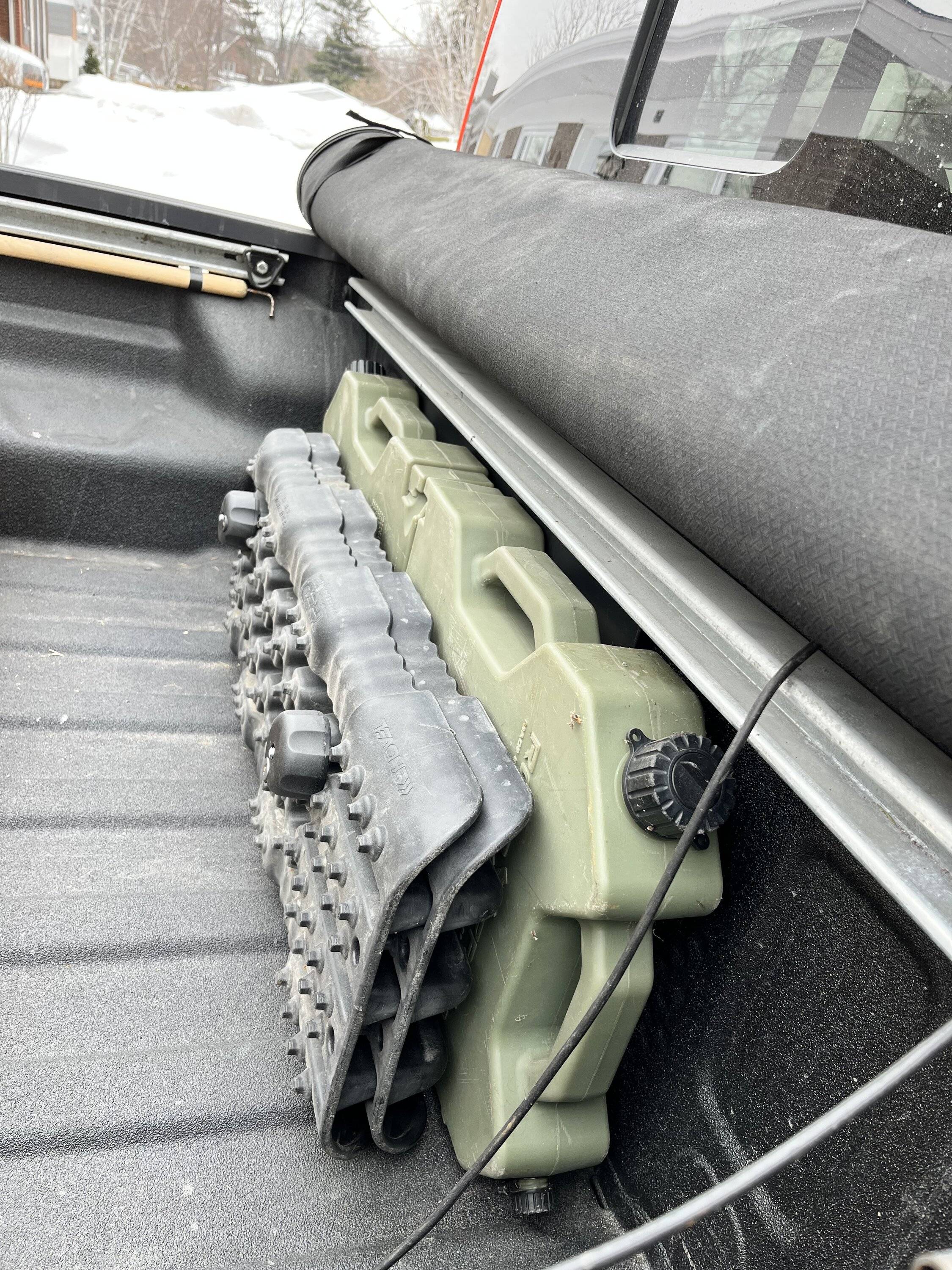

You could do like I did on my bed , it’s just a threaded rod and some bike rack locks!!

Yes, I have the Builtright molle panels inside my truck bed. But the truck bed is full of equipment. I need to find away to store traction boards and more fuel on the exterior sides of my Smartcap.

You can do the same thing but on the side of your cap, this thing is just a steel plate with the2 rods affix to it, you just need to fix the plate to your cap or screw the rods direct through the sides

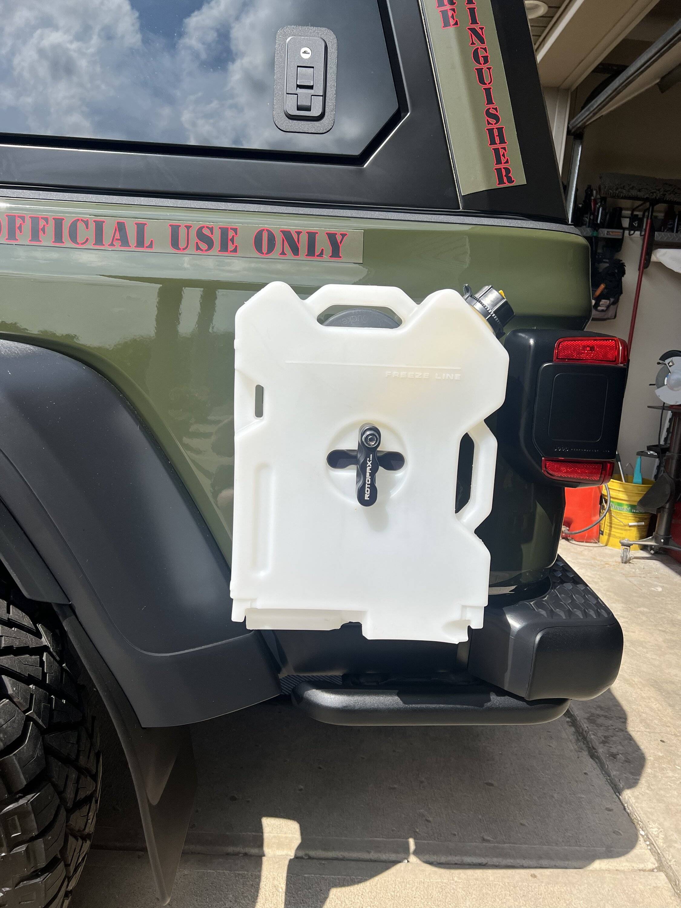

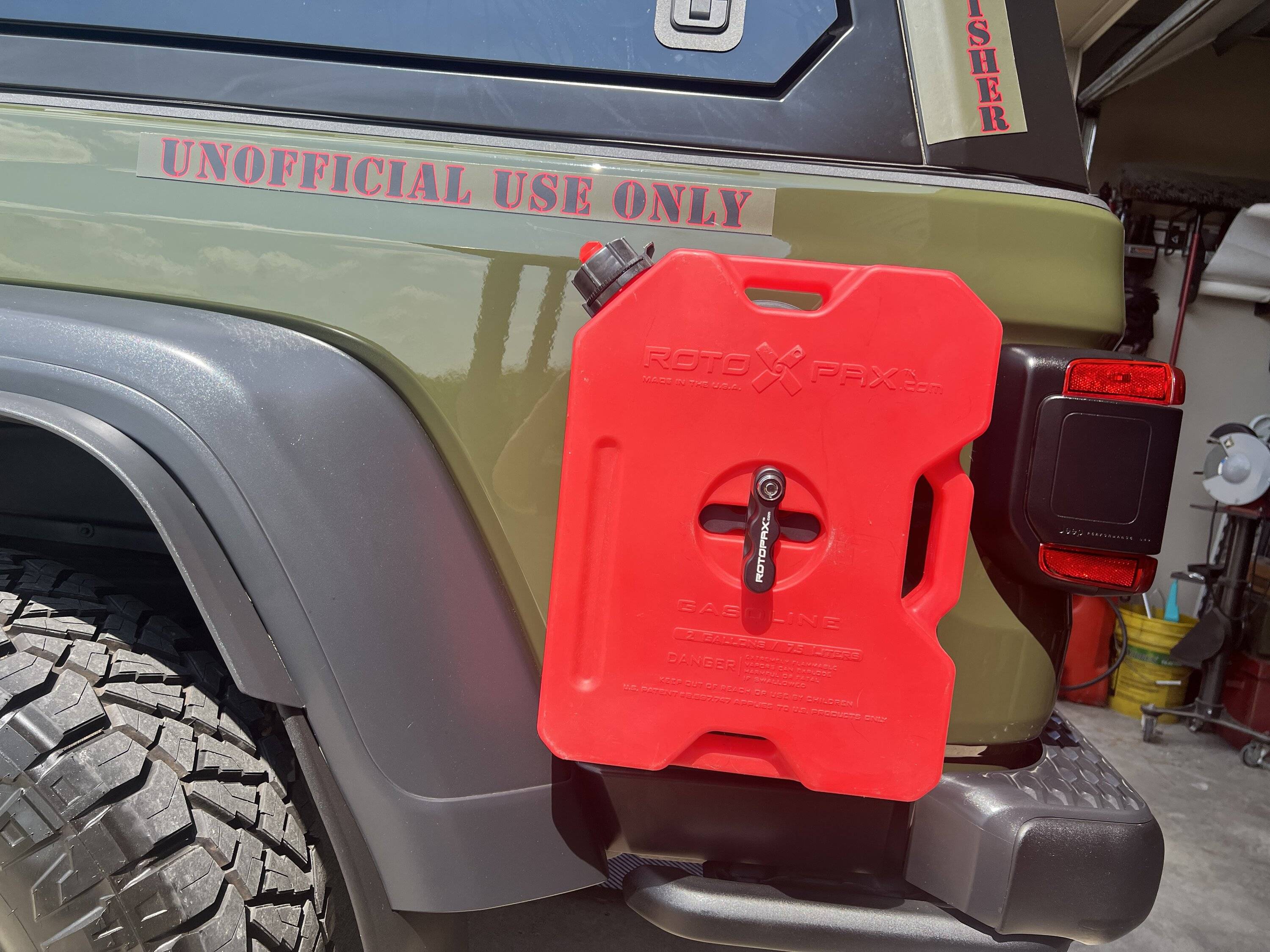

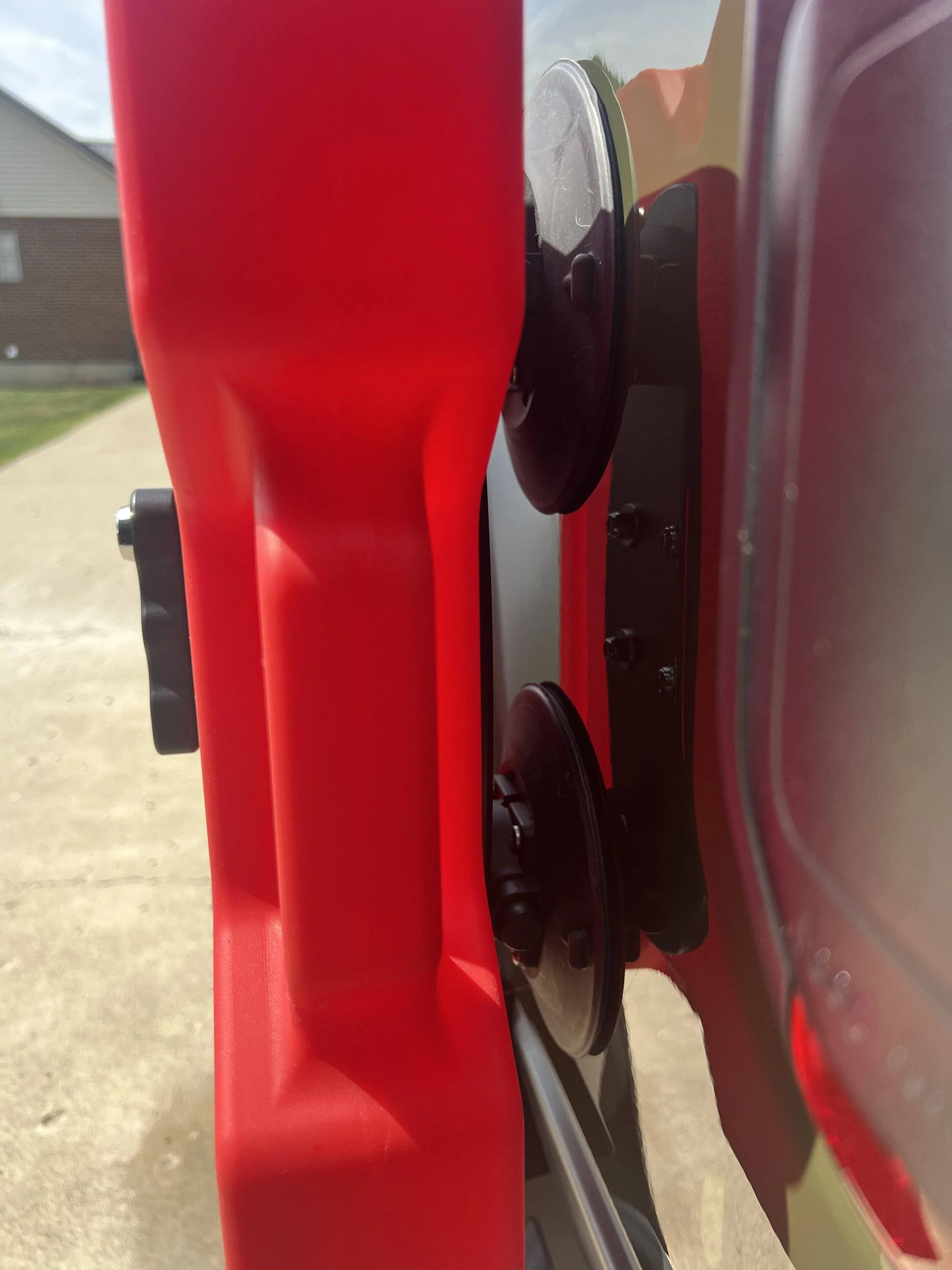

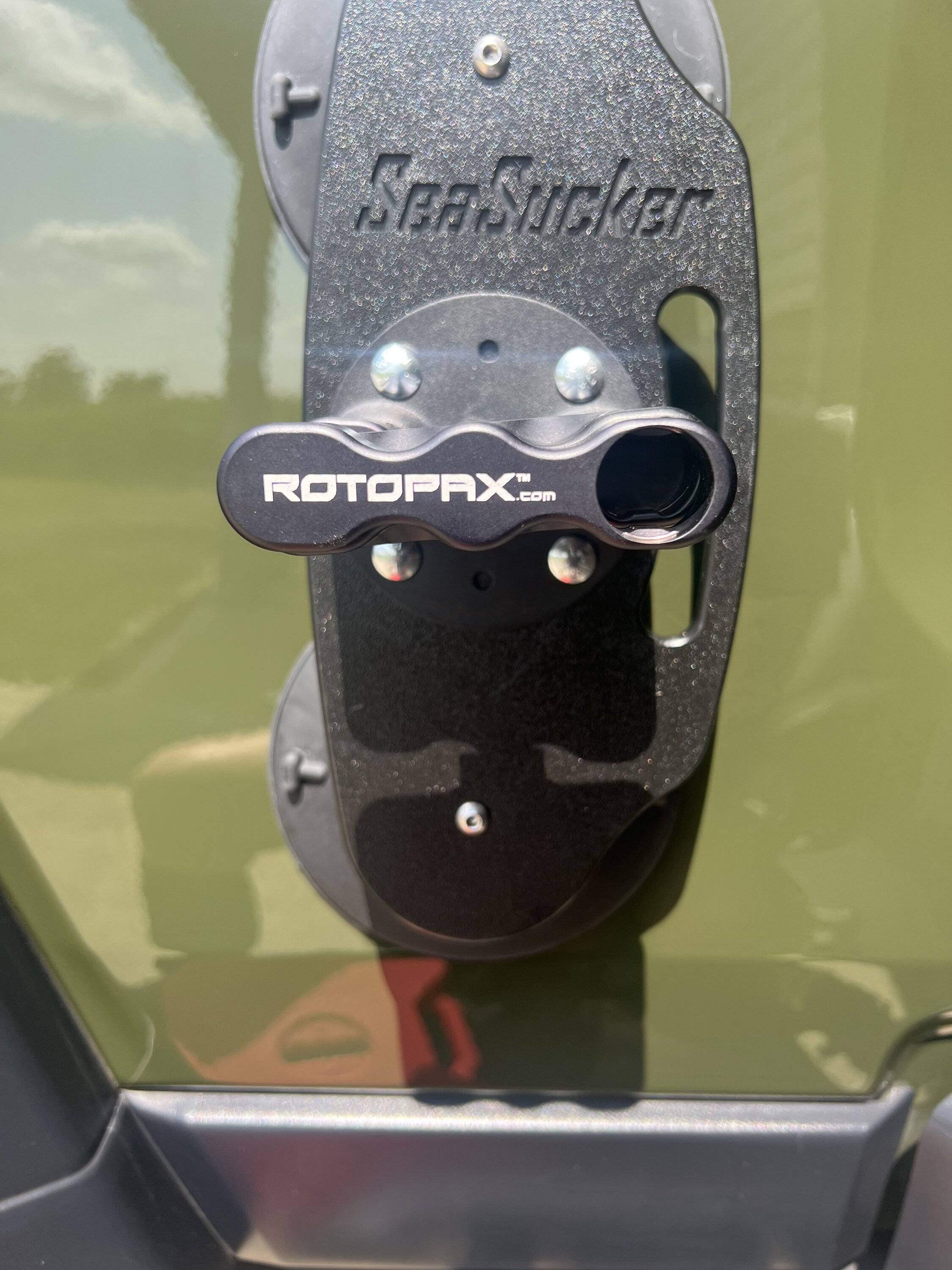

UPDATE: After RSI ( maker of the Smartcap) suggested that I consider the Seasucker mounting system as a means to mount Rotopax fuel containers on the exterior of my Smartcap. While at the Great Smokey Mountain Jeep Invasion, I was able to see firsthand the Seasucker mounts. I was very impressed with them and purchased the Rotopax mount and a system for mounting traction boards. Today I had time to assemble and mount the Rotopax mount. I am extremely impressed with the Seasucker mounting system! If anyone wants to carry extra fuel, water or other gear on the exterior of their rig, you really should look into the Seasucker mounting system.
NOTE: I have no relation ship with Seasucker. I paid full retail for the mounts that I am using.

I noticed in your pics you have the seasucker on body of the jeep and not the Smartcap gullwing doors. Have you tried it on the Smartcap doors and if so do they hold well?

The Seasucker mounts do hold well on the glass panels of my Smartcap however, I have been reluctant to put more the one 2 gallon Rotopax on the glass as im afraid of breaking the glass. I’m just being extra cautious. I do not leave the Seasucker mounts attached on a daily practice, just when I know that I may need more reserve fuel then my 4 gallon Rotopax that is inside the bed at the front.

I have not done hard off-roading but I do live in rural Indiana and frequently travel very rough country roads and rougher gravel roads with occasional forays out into fields. Even during the winter with temperature swings from the teens to the 50s they stayed secure. Highway speeds (70+mph). No problems. I did check the suction indicators every few days.
