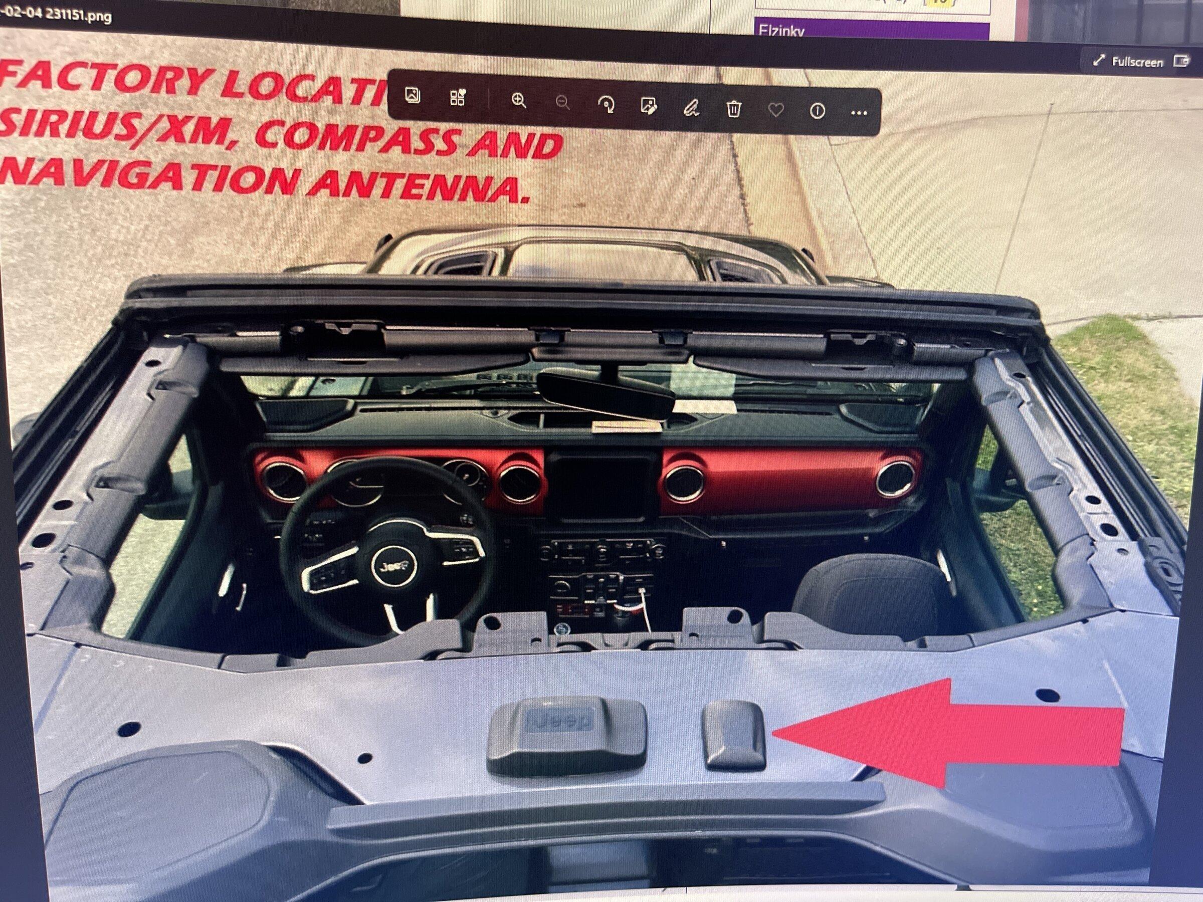

Bump having just put on our Alu-Cab. It looks Like that is something we need to add to the list. Anything come up about doing this as far as options now? Looking at using the Maximus 3 Satellite Antenna Relocation Bracket.

Self installed , Mopar part #. On stock roll bar location (topside, above sound bar). Premium Soft top. Mine works exceptional. I should look for the instructions because I thought I did see a short easier solution under the front dash. Maybe you hard top owners need that???

The thing is the factory location is pretty much there if I am not missing something?? Looking at moving mine to above the front driver visor.
Jeep Gladiator Move XM ANTENNA image
Wrong, that's the GPS that can go on the dash. This kit has GPS and Sat Radio antenna. Radio Antenna can go external.
https://www.infotainment.com/produc...atellite-radio-antenna?variant=11937743077412

I replaced the factory radio in my JKU with a Kenwood stereo a few years back. At first I tried the Jeep factory satellite antenna but the reception was spotty. I ended up putting the standard small puck style antenna under the dash, just above the gauge cluster. It worked well and was an easy install. Later while doing some other mods I moved it to the wiper cowl to see if it would work better. I didn’t notice any difference so I put it back under the dash a few months later. There are several on Amazon and elsewhere.
If you go this route, you will need the FAKRA adapter mentioned earlier. Together they would set you back about $35. Maybe get the dealership to look at it first?

Wrong or the other 5 things I have read where misinformed about the factory location of the GPS/Satellite Antenna?
I would not mind personally even having the possibility of designing and having fabricated a Antenna Box to mount on top of my Alucab canopy camper.

Seems like a war of the “wrong” might be starting here for some reason. All I will add to my comment is I had both my GPS and Satellite antennas under my dash above the right half of my gage cluster for several years. There was even a nice flat spot for them to sit on in the JKU. Worked well for me. YMMV

My issue is that I have a Camper right over the Middle Sports Bar. So receptions is terrible now. Given that from all available things I have seen put the stock antenna location about the middle rollbar, usually not an issue except when you have a roof rack or camper there. So two options for reception would be moving toward the front of the vehicle or relocating on top of the Camper top with my Cell phone booster antenna.

I just think its miscommunication. I have not replaced the radio, and having now a aluminum camper body on there blocking the signal. It something I need to work on to be able to have good functionality.
