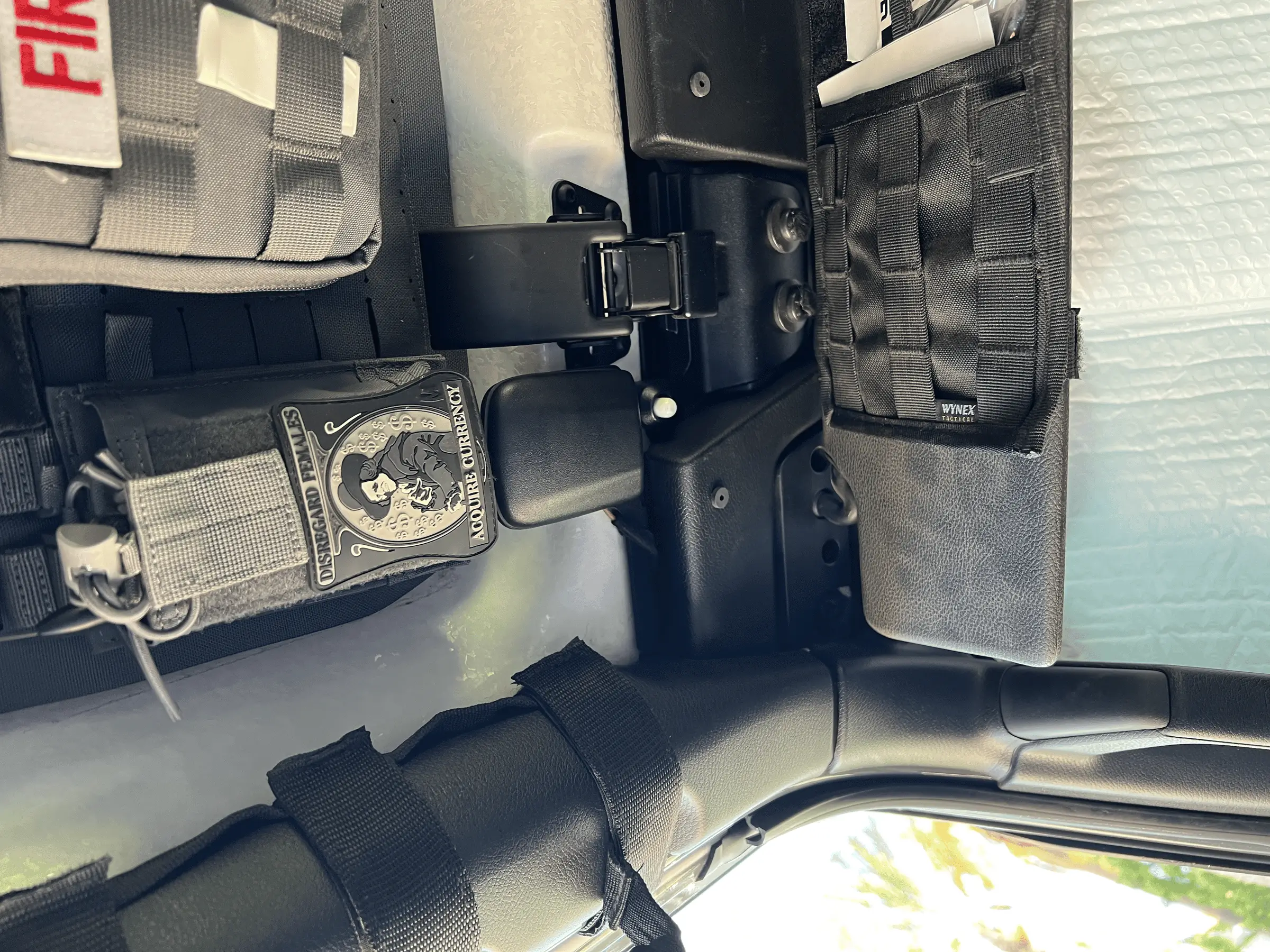

I just installed the Maximus 3 bracket in mine today, only took it for a 15 minute drive after but the XM reception was significantly better than before. Thought I would have to move my radio pouch but didn't even need to.
Jeep Gladiator Move XM ANTENNA tempImagebhXdHP
Pretty cool!
However, I am curious if anyone knows what sort of impact this may have to the body now that the transmitter is much closer to your head on a constant basis.
Yes - I realize most don't care but after having a brain tumor on the side I used to use my cell phone I am sensitive to that situation.
Were you able to remove the XM antenna without removing the hard top?

I have the alucab canopy camper on my JT. Just had the antenna moved using the Maximus 3 relocation bracket. Works great
