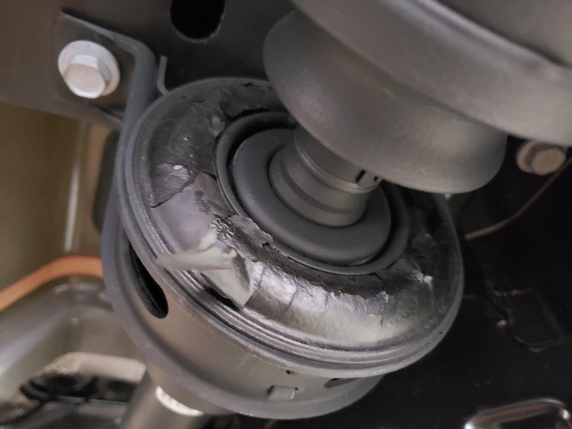

been to the dealer 5 times now first two were po300 codes third was evap. all they did was test the motor clear the codes and tell me all is well. keep getting auto stop start unavailable on and off the whole time. last code was p105d says intake valve stuck in up possition. Been in the shop this time for two days so far no updates. i also beleave i have a bad drive shaft or axle shaft somewhere as I get an annoying vibration at low throttle imput.
There is a recall and a Stop-Sale order from the FCA regarding the driveshaft. See link below.
https://www.google.com/amp/s/www.cn...ep-gladiator-truck-recall-driveshaft-problem/

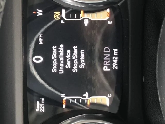

So, I picked up my JT last week after 30 days at the service department, today the Start/Stop service light is back on!
Jeep Gladiator Multi cylinder misfire 752DB3EA-A7F3-484A-A5A5-3F2F1469E7D5
