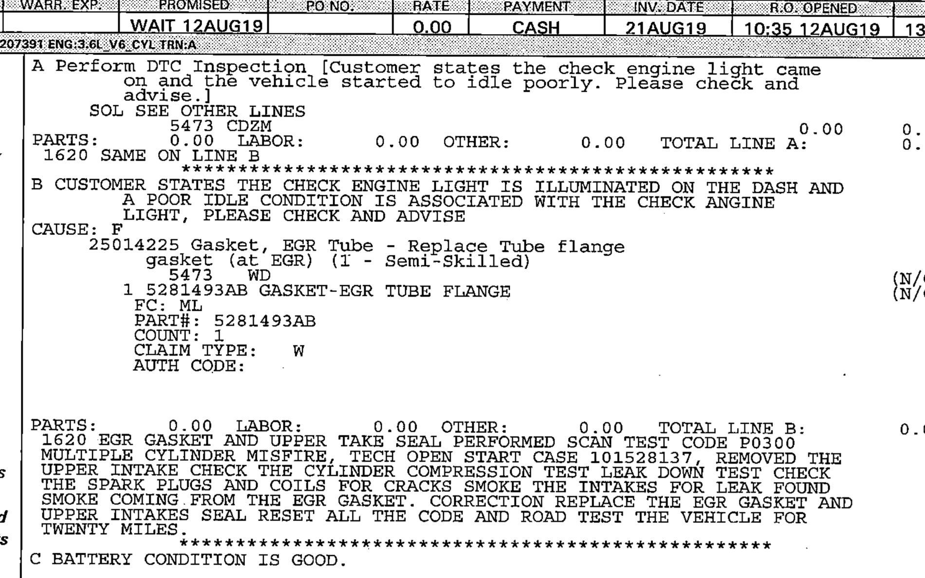

I will try and add the work order when I get a chance. Truck is still in the shop and it is unclear what the fix will be. I will say so far the FCA folks and JeepCares have been very helpful and actually seem to care (which is nice).
I tried to upload the video but it would not let me, will try to add work order shortly, though I'm not sure what you will learn from it.

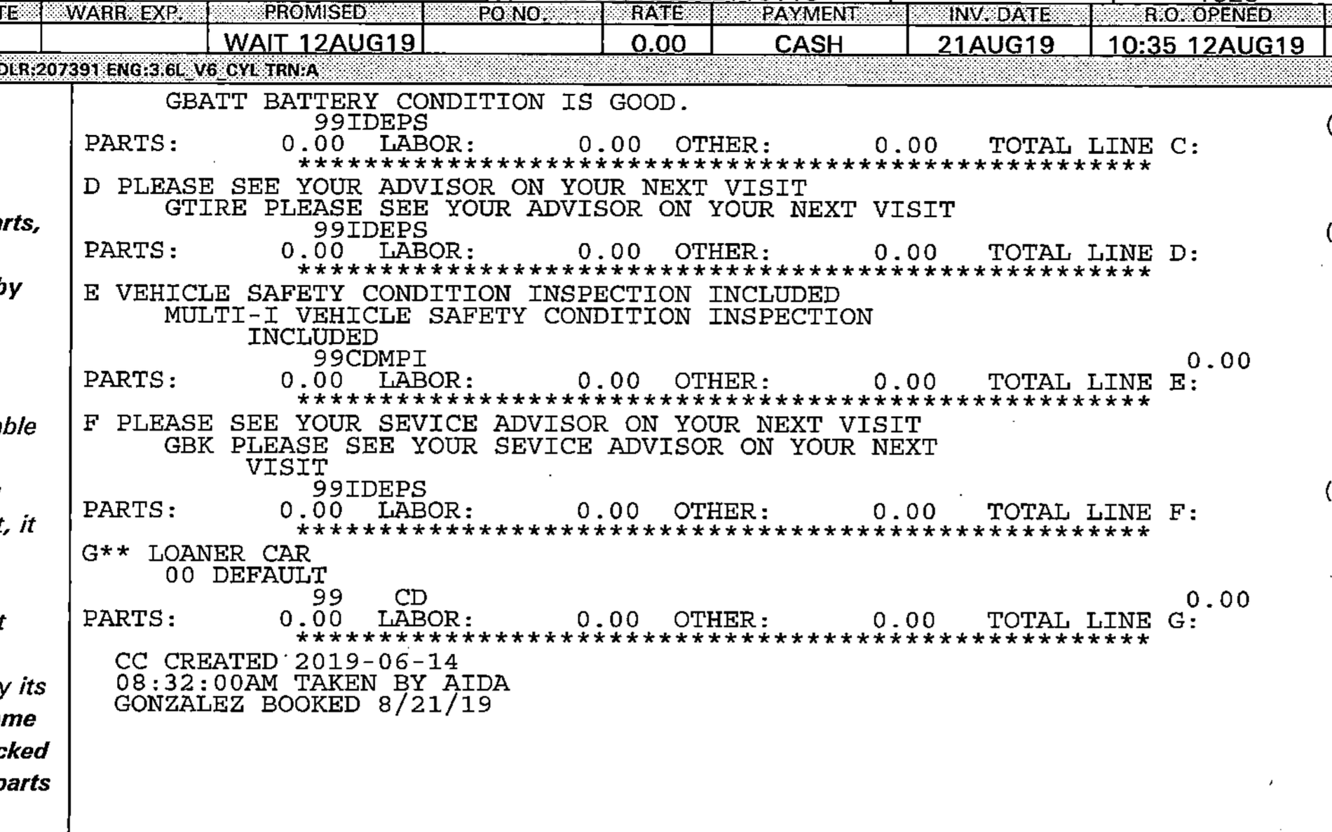

To you guys that were bashing and seem to know everything, I look forward to your thoughtful insights now that you have seen the most recent invoice.
Please note it's still in the shop, which is why I don't have much to update.

Post the part with the vehicle information with the last 8 of the vin# redacted
ETA: Did you post because you want help, or because you are looking for someone to commiserate with you? To help you we need to see what the dealer is and isn't checking, the codes it is throwing, etc.
That is why I'm asking for the work orders, when you repeatedly ignore that then post a portion of a work order without any of the pertinent information and simultaneously get puffy eyed because some dared question you, tells me you don't really want any help.
So I'm going to oblige you.
Good luck.
