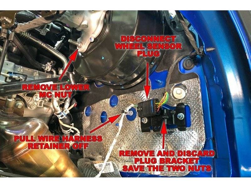

If that bottom nut is missing, when you press on the brakes the force of the rod pressing into the back of the master cylinder *could* make the master cylinder deflect upwards, thereby allowing less pressure to be applied to the fluid. It wouldn't take much movement at all to make a big difference in braking strength.
IMO, about the only way for it to deflect enough would be to bust the top mounting ear. Even moving out 1/4" on the very bottom means only 1/8" out in the middle because it would be still mostly attached at the top. 1/8" is not a lot of movement - should still have brakes.
I'd look very very carefully at the master cylinder mounting flange - that sort of movement isn't great for aluminum or zinc alloys. CRACK.

I still had brakes, but diminished.
Ill definitely inspect for cracks. but I can say that now its stopping just fine.

You probably lost the seal to your booster. There is an o-ring that holds in the vacuum between mc and booster. it can be a pain sometimes when installing a new master. That would explain loss of assist and no abs light. Loss of brakes can really get your attention! Glad replacing the nut got the seal back and the o-ring didn't get distortated.

That was it, before heading out I put a bolt back on and bingo, I have brakes again. crazy/scary how one tiny bolt could make such a difference.

Putdown your pitchforks, this very well be because of something I did but I can't figure out what.
Yesterday evening I had to uninstall my ARB compressor that I have mounted in the wheel well. to access it, I had to remove my falcon shock as the reservoir butts up against the compressor almost. to remove the shock, I lifted the driver side of the truck up to allow it to droop. the entire operation was pretty seamless, and I was don't in about 30 min. is there a chance I pulled the break line? I've done plenty of off-roading and have stuffed the wheels more than once in full flex, could this be any different?
I'm running the Falcon 3.5 premium kit that I swear came with extended break lines.
my breaks felt fine until I got to the stop sign at the end of the street, the first half of the press felt normal, but as I pressed harder, the brake felt as if to push back and the truck stopped slowing down. I had to pump the pedal then put all my weight on it in order to stop.
there is no puddle in my driveway and the first thing I did was check the brake fluid level and the reservoir is full.
any advice?
Had a Jetta with no brakes first thing in the morning. Hard pedal. It was a vacuum leak within the master cylinder. Dealer never figured it out. New master cylinder fixed it.
