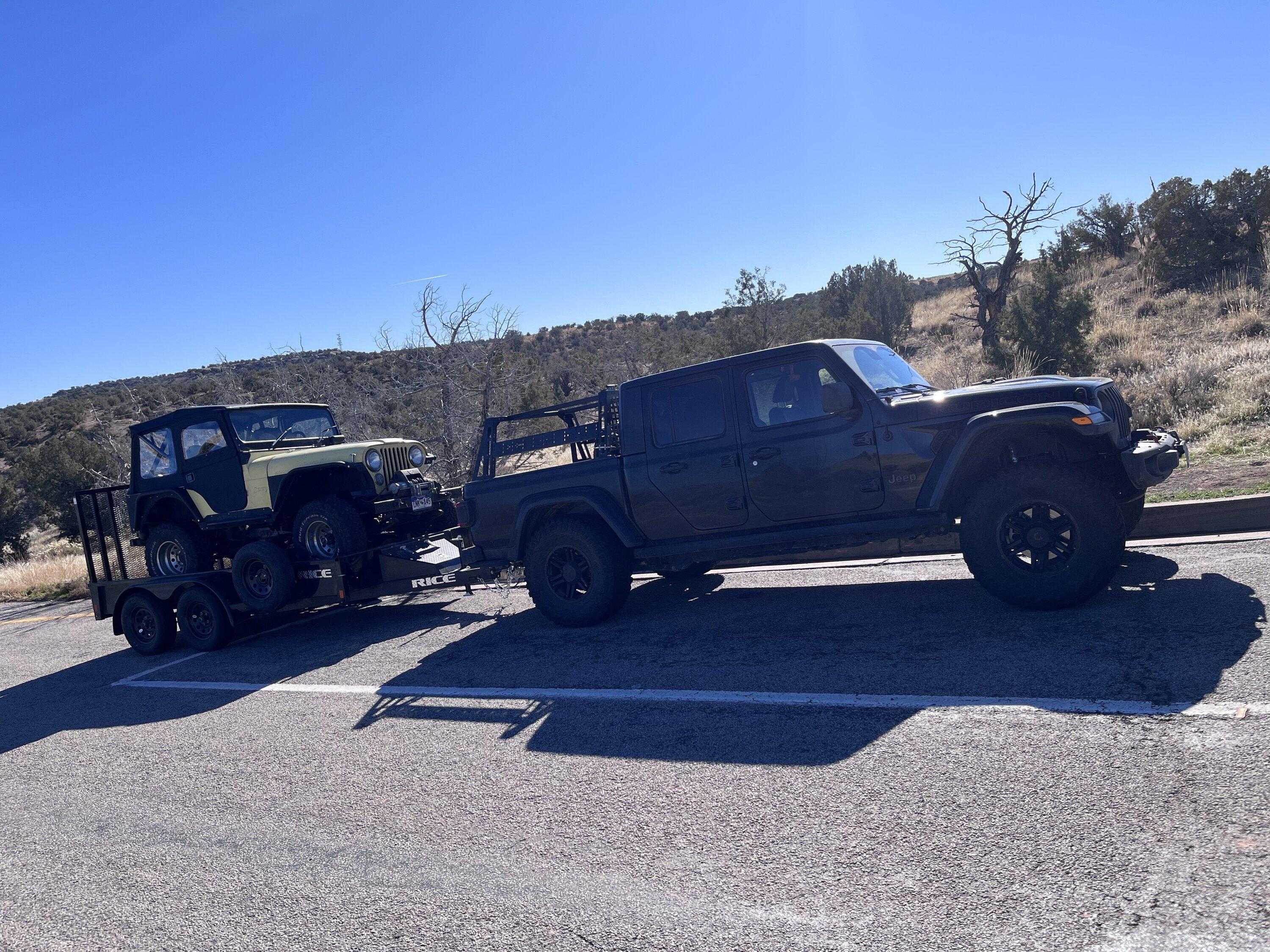

Hey all,
I read dozens and dozens of posts on here about towing trying to figure out what I should do. So, I thought I'd throw one in as well for the next person.
Anyhow, I've got a 2020 Rubicon with a 2.5 spacer lift and some 37's on stock gears. I wanted to tow my 73 CJ out to Moab from Denver for a few days to play around and wasn't sure how the Gladiator would do. I ended up getting a Curt Echo. Not perfect for the brakes, but good enough.
The drive wasn't too bad. I averaged about 9.5 mpg. On the climbs up the passes I had a lot of troubling keeping speed. I'd bounce back and forth between second and third gear at between 45-50 mph. Other than those 10-12 miles each way though, I held speed just fine.
Anyhow, that was my experience - thanks a ton for all the others that had offered suggestions on here!
