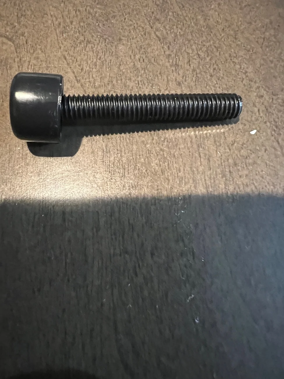

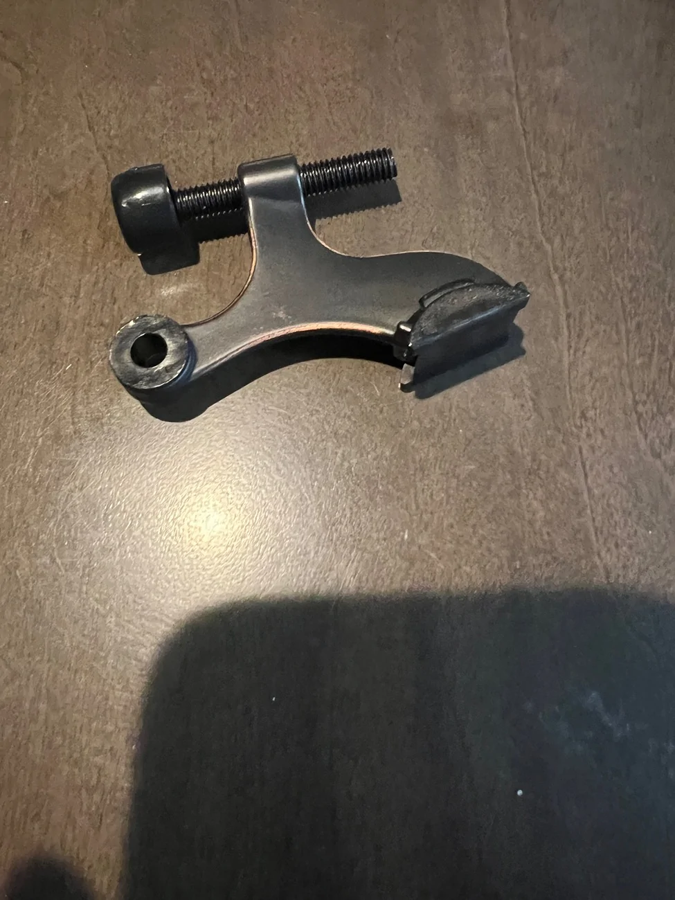

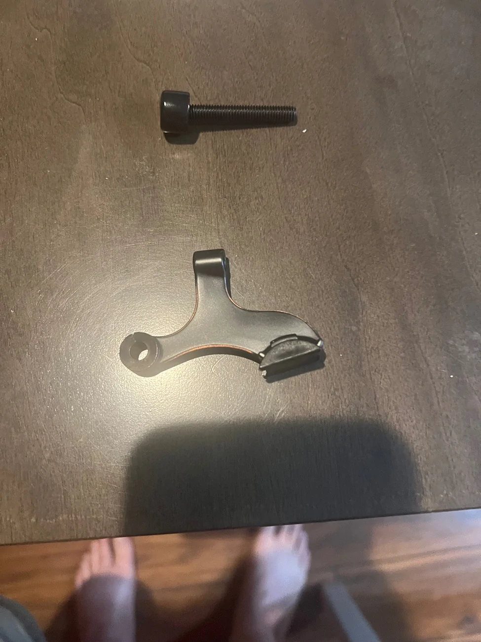

I have the older tube doors and found inside “Hinge Pin Door Stop” from Everbilt purchased at Home Depot, the screws are the same size and thread count, just need to cut them to length, works great
