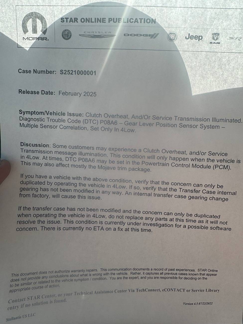

I called jeep care and got a case number and took it back to the dealer a 3rd time this was to investigate. And learned some jeeps will trip the high temp clutch alarm in Low range. The paper they gave me was dated February 25 they claim to be working on a solution with no completion goal date..
I joined this group to see what types of solutions people have come up with. I don’t believe that the new recalled clutches are much better if at all. Watch the video from south bend clutches on the intermediate plate being hollow heating and warping eventually causing fire or explosion. This issue is easy to fix because there are at least 3 aftermarket options available, ACT, center force and SBC, maybe more: if I put an ACT in my Jeep I’d never need a clutch the rest of my owning it. I’m pretty confident in that. The trouble is that doesn’t fix the issues with the computer tripping out. I am very interested in any solutions people have found to fix or get around this without voiding warranty since my jeep has 7000 miles on it.

here’s a copy of the letter. I’d encourage you all to test 4 low if you haven’t for 5-10 minutes and see if you have the same result if your still under warranty report it so we can hopefully get a solution
