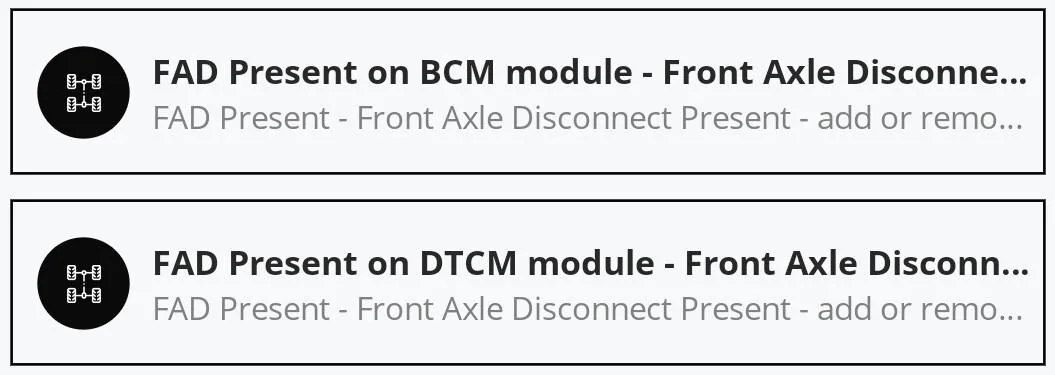

Can we get some opinions.... does the FAD delete require computer adjustments to eliminate dash warnings or even codes? Can the Mini Taze do it and what other devices will do it? TIA!
Been thinking about RCVs or even a complete new front axle that has the FAD delete.

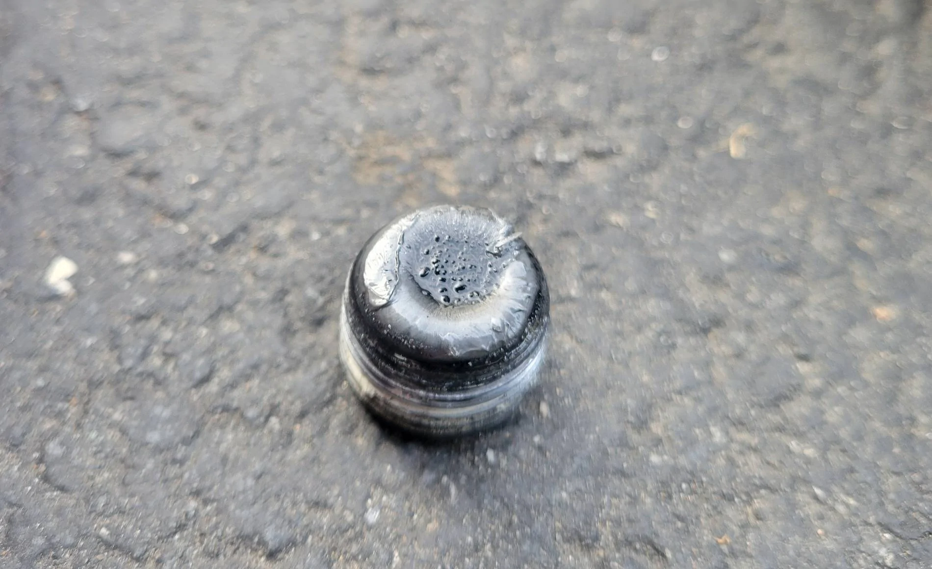

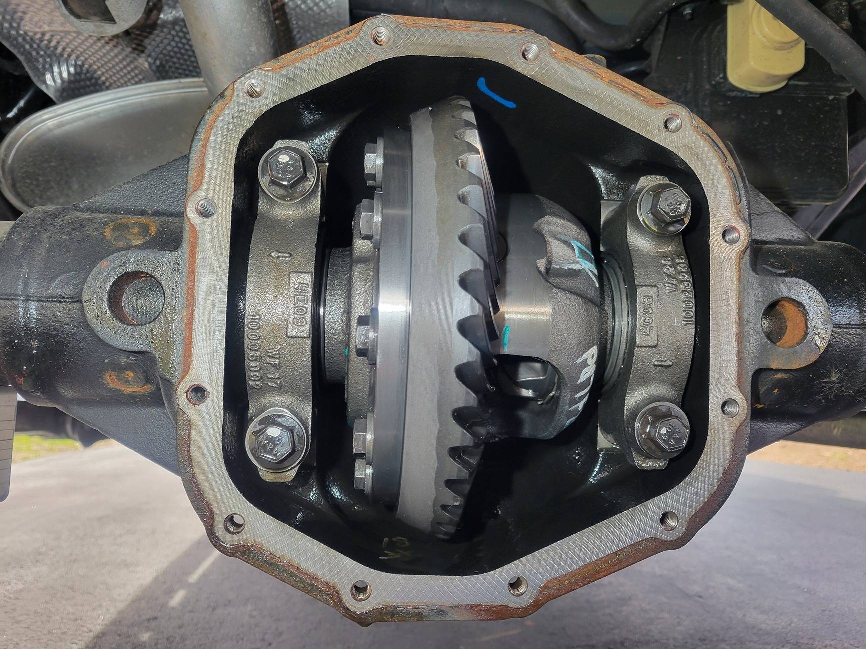

Holy smokes @Janster and @Hootbro you guys were spot on about checking my differential fluid levels! I was able to add about 8 ounces to the front diff and about 10 to the rear! Thank goodness I only have 280ish miles on them.
Check these out:
This is the front diff plug. I wiped it before I took a picture, so my finger is included:
Jeep Gladiator New 2024 Jeep Gladiator - Possible FAD or Transfer Case Issue 488583754_1644429789551351_7978032423047107918_n
Here's a few of the rear. Woof.
Jeep Gladiator New 2024 Jeep Gladiator - Possible FAD or Transfer Case Issue 487744680_974029518178805_2217860079040537165_n
Jeep Gladiator New 2024 Jeep Gladiator - Possible FAD or Transfer Case Issue 487774294_2230370280730061_1113266359597322792_n
Jeep Gladiator New 2024 Jeep Gladiator - Possible FAD or Transfer Case Issue 489069652_9901115486600310_2753678743552873061_n
I didn't really feel like removing the front diff cover (my Gladiator isn't lifted, so I'd have a tough time without removing the front track bar) since the oil looked pretty good and the amount of debris on the magnet was minimal. So I opted to top it off and roll the dice. The rear was pretty heavy on material and lower than I'd like on fluid. I haven't done it yet but I plan to check the transfer case fluid to be safe.
There is settings that have to be adjust on the presence or delete of the FAD system. JScan can do modify these settings.

That really is about what I would expect with 300 or so miles as you originally stated. You are still breaking in. So long as there is not actual chunks and just that fine paste sludge on the plug magnet, you are fine. I would not get spooled up on what you have.

As always, thanks again for your input, appreciate it. The front magnet was what I'd call mostly paste, whereas the rear magnet had paste with fine metal shavings, but nothing I'd say is super alarming or actual chunks.
