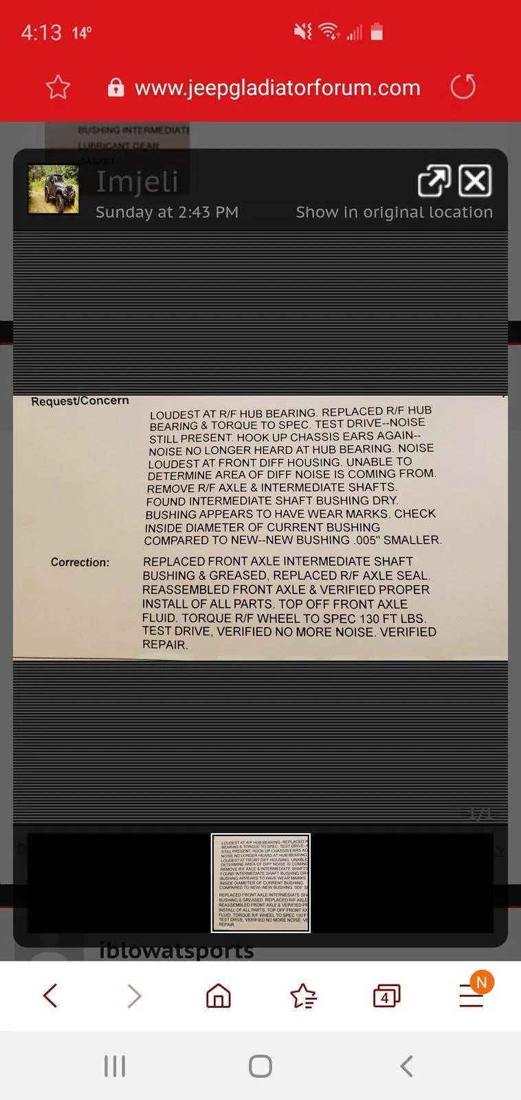

I've been having a similar issue as of late. It seems to have started once I tried out the lockers on a snow bank. Now I get a random vibration from the driveline somewhere. Its random and lasts about a second, kind of like driving over rumble strips.
I'm taking it into the dealer Friday to have it looked at.

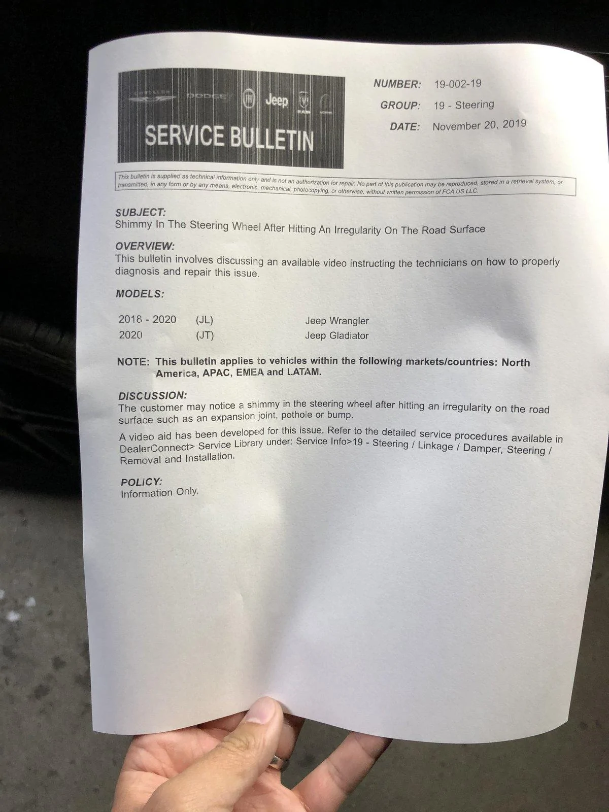

Took it in and was able to reproduce the issue with one of the techs.
Foreman took the case over and was not able to reproduce it himself. He did find SB 19-002-19 in FCA STAR platform (attached below) and replaced the steering dampener.
SB talks about a “steering wheel shimmy,” which makes it seem way less intense than what I experienced, but it also mentions the symptoms coming on at spring 55 mph, which is consistent with my experience.
I’m not 100% convinced it solved the issue, but I haven’t experienced it since I got the truck back, so maybe it did the trick. Time will tell.

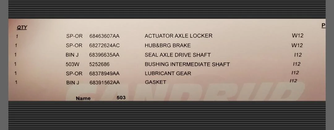

Was told it needs a new actuator. Should be done on Friday. We'll see
Did the new actuator fix it?
Day 8 at the dealer with the exact problem on my Gladiator Rubicon with 3k miles. Apparently they deliver parts via wagon train. It took them five days to figure out what the issue is. Obviously, this is becoming a common problem on these.
What did they say it was for yours? On mine, they replaced the steering damper and it seems to have solved the issue. Imjeli above says they are replacing the TC actuator and the OP said replacing the side axle to eliminate play finally solved it. Same problem, many solutions?

It looks like they're replacing the axle shaft and axle guide. They said originally that a seal was missing in the front differential and that caused the problem.
