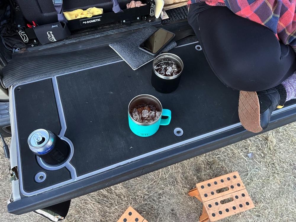

Just spent a week off grid and the BillieBars Tailgate cover performed as expected. In and out of the back, seating, cook platform, etc. ACES!! It is comfortable enough to sit on that i will likely forego any type of extra mat/pad/etc.
Cheers @BillieBars!
