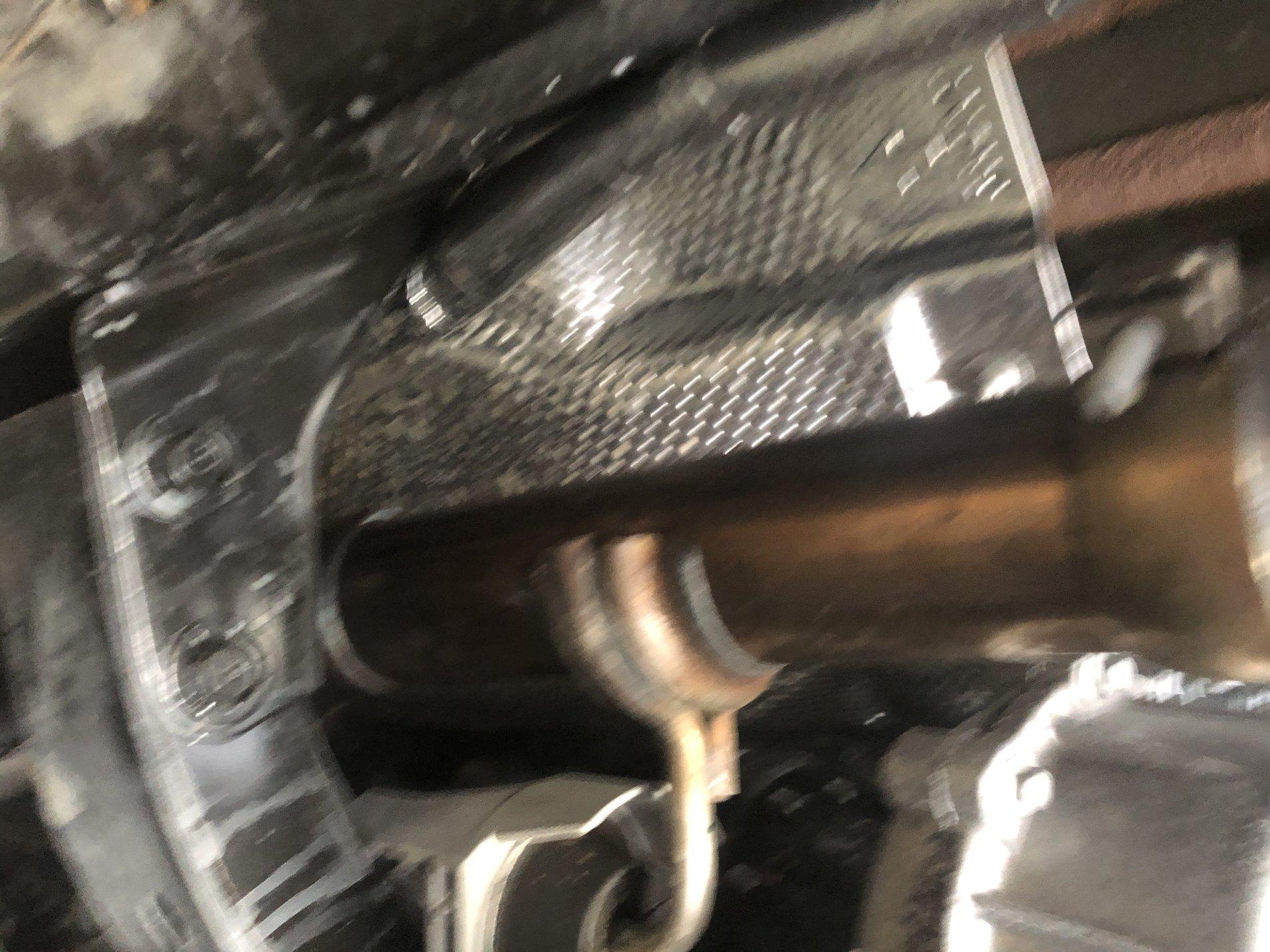

Well, I wouldn’t hesitate to take it to the dealer to check it out. Wondering if this could have been from a heat shield not making it into the truck? Only thing I could think of to cause that catalytic converters can get extremely hot. Rich fuel mixture will cause that as well. Take a picture of the underside of the truck directly below where you are experiencing the heat.

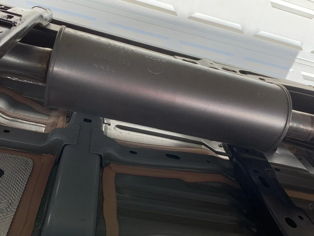

Thanks for your response. I’m getting heat all the way down the driver side which by the looks of it has some heat shielding on the front but not so much on the back. Would be interested in your opinion if this is correct. See photos attached.
Jeep Gladiator New Gladiator - hot floors 3A1FDAD2-79A9-4036-98F4-296877B5DA74
Jeep Gladiator New Gladiator - hot floors A8EAA655-0DD8-4994-9126-AC7D90EF7214

Old school fix:
Wrap that sucker with some heat shielding exhaust wrap from Jeg’s, NAPA etc.
Done son.

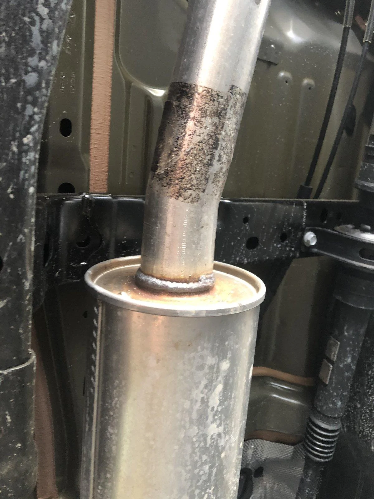

I just looked under mine and it looks identical so I don’t think any heat shielding got left off. I can say that I have not noticed mine getting what I would consider alarmingly hot but I also haven’t checked. Here is a picture of mine. I would have the dealer check it just to be sure the converter doesn’t have some type of defect but if they come back that there is no issue you could wrap it in heat shielding like previously suggested.
Jeep Gladiator New Gladiator - hot floors 0255B2A6-9E70-4A2C-9527-D4E5380ADD9A

Take a reading of your floorboard with an IR thermometer. I just now completed a 420 mile road trip in mine, with no complaints from the barefooted kids in the back.
