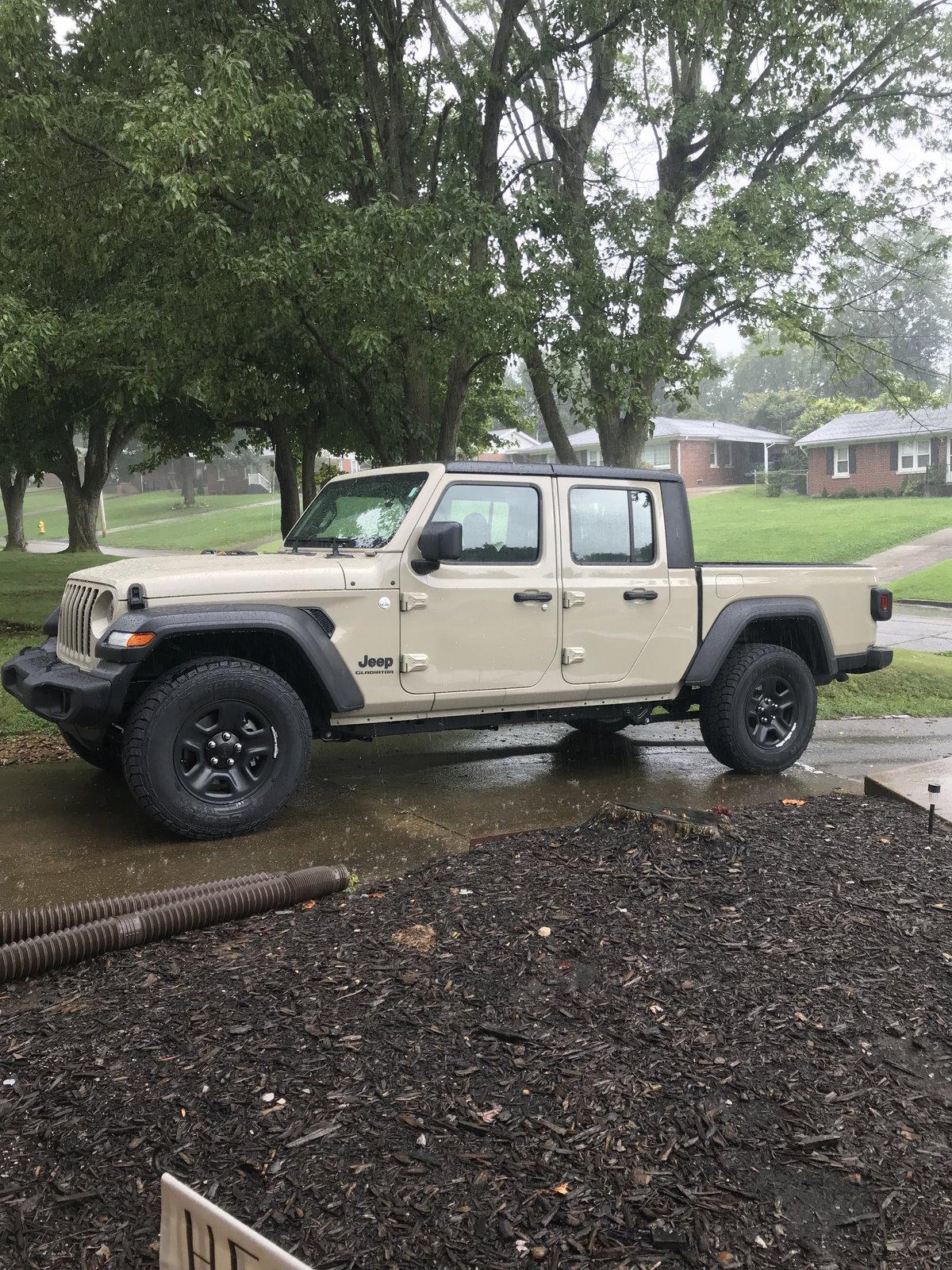

Hello all, I just bought my first Jeep Gladiator Sport( Not the Max tow version) and was wondering if any of you have 33’s or larger tires on yours without a lift.
I saw a lot have fit 35s on stock sports without a lift kit, but they had the max tow version, am I able to do the same if I don’t have the max tow? Thanks!
I currently have 32.8 inch tire on mine but was going for something a little bigger

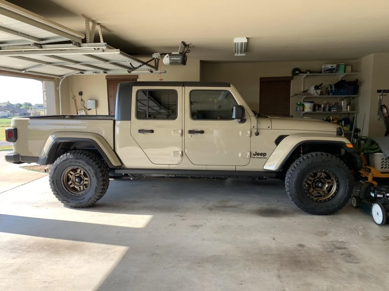

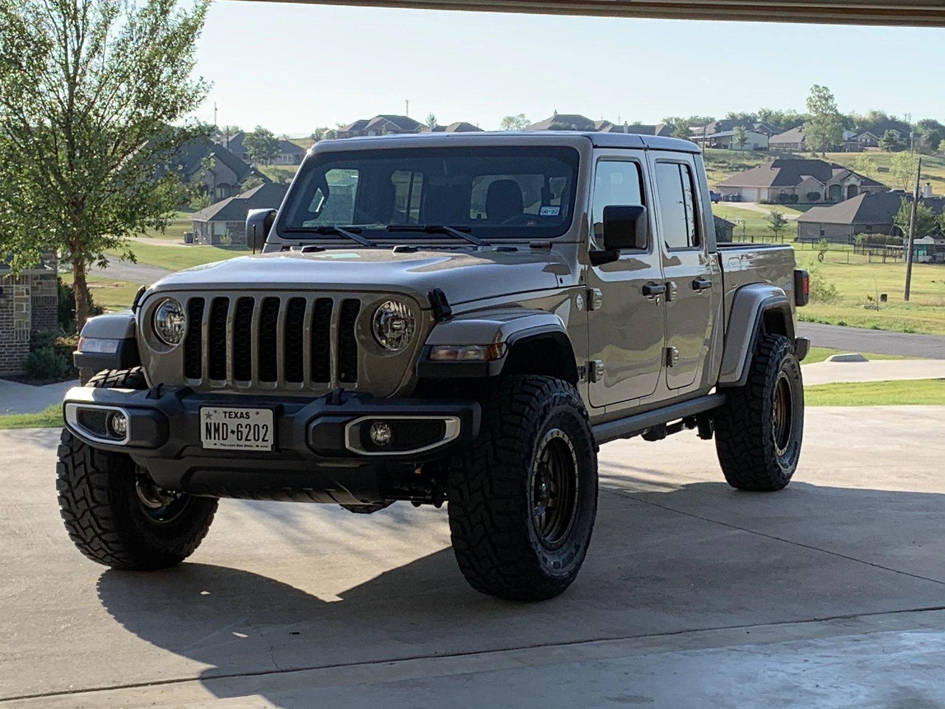

35’s will likely fit with some trimming on the front plastic, but rub if you go off-road. I do have the max tow and went with 315 70 17 using a 3/4 level and rubicon take off springs and shocks. If I had installed myself, which is pretty easy if you have moderate mechanical abilities, I would have been out $350 total before wheels and tires.

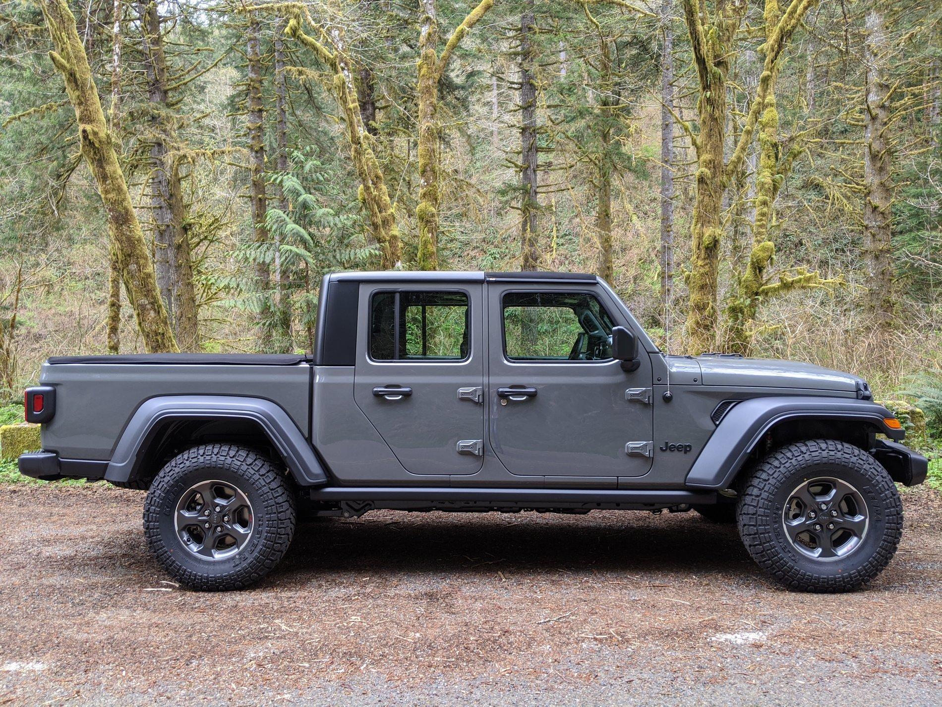

35" on Rubicon take offs
1.75 front leaving kit, .75 rear
