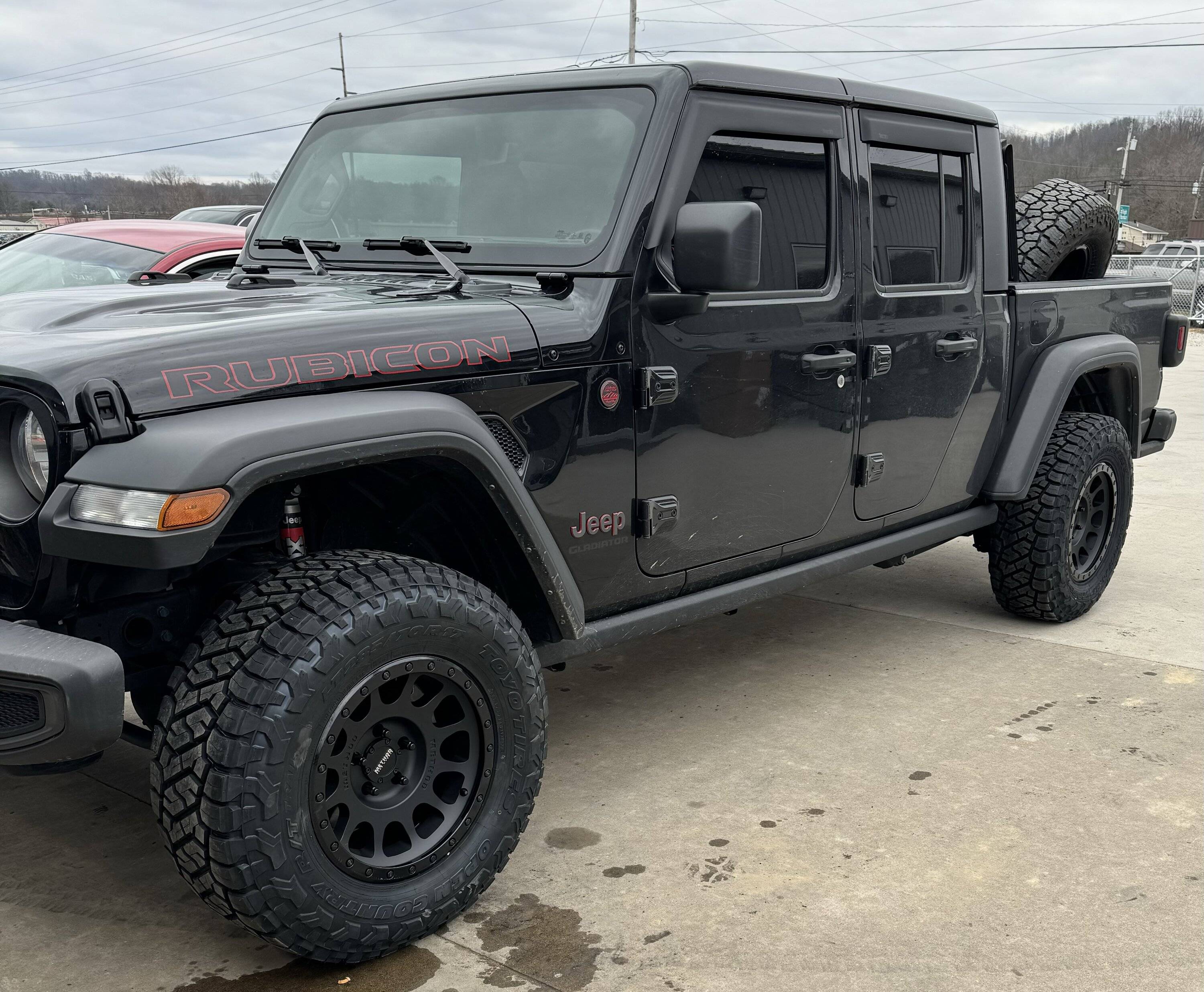

I have been running Nitto Ridge Grapplers for the last 11k miles. They balance well on my Method wheels. They perform great on and

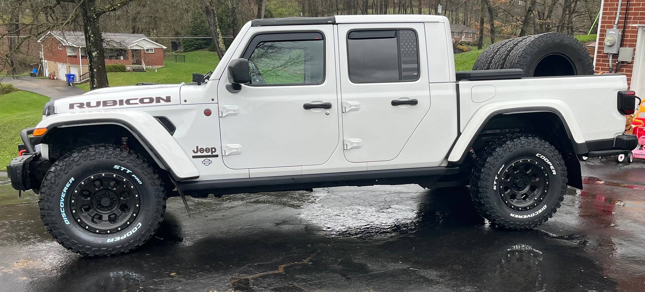

I went from the stock falken wild peaks to Patagonias (which I hated and ended up selling) to Toyo AT2’s to Cooper STT’s (which I just had put on this week). So far love the looks of the STT’s and I was honestly surprised how smooth and quite they are off the bat, I guess time will tell as they wear but for right now I’m very happy with them!
Mt’s or XT’s? Curious about what you hated if they were the XT’s. I’m 10k in and have zero complaints. Quiet and perform really well 37/12.5’s
I had the Patagonia MT’s (315/70/17). They didn’t balance well and had a constant vibration, they were noisy, and the tread wore horribly fast. Was not a fan…
