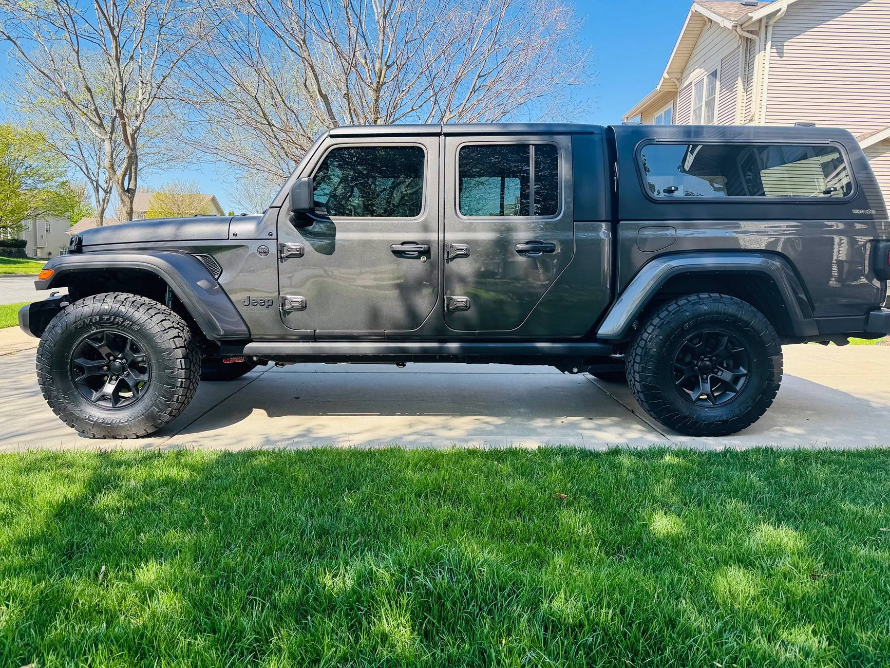

I have a 2025 Sport S with the max tow which gives 4.10 gears, and I just put on Falken Wildpeak AT4W tires which are 35x11.50x 18 load range C and I feel the difference. Good luck in your decision.

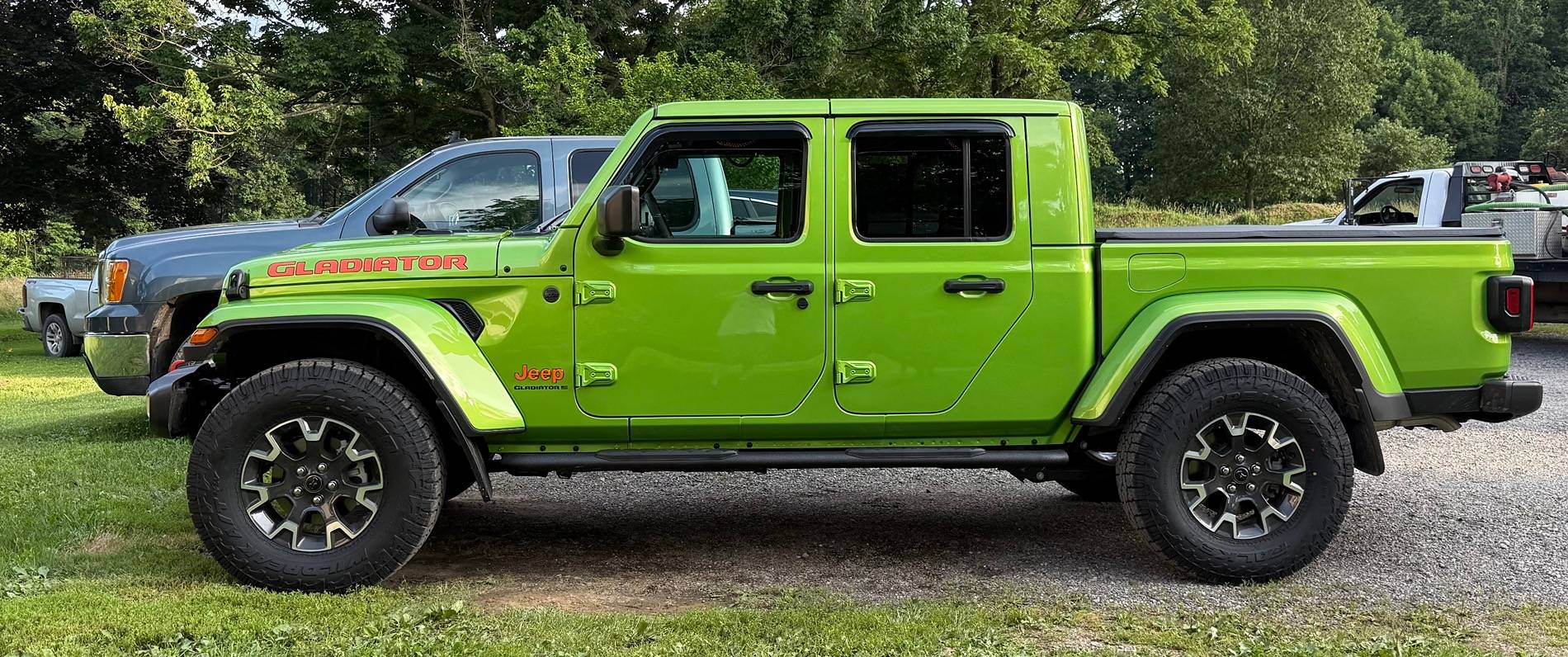

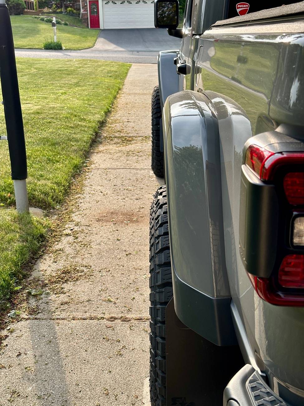

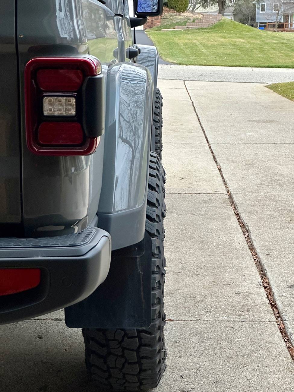

What offset are you running with the 255/85
The 255s are on stock Mojave wheels, so 37mm offset. I do run them with 1.5” wheel spacers. The “poke” is nearly identical as the 0 offset Method wheels and 10.5” Kenda tires without said wheel spacers.

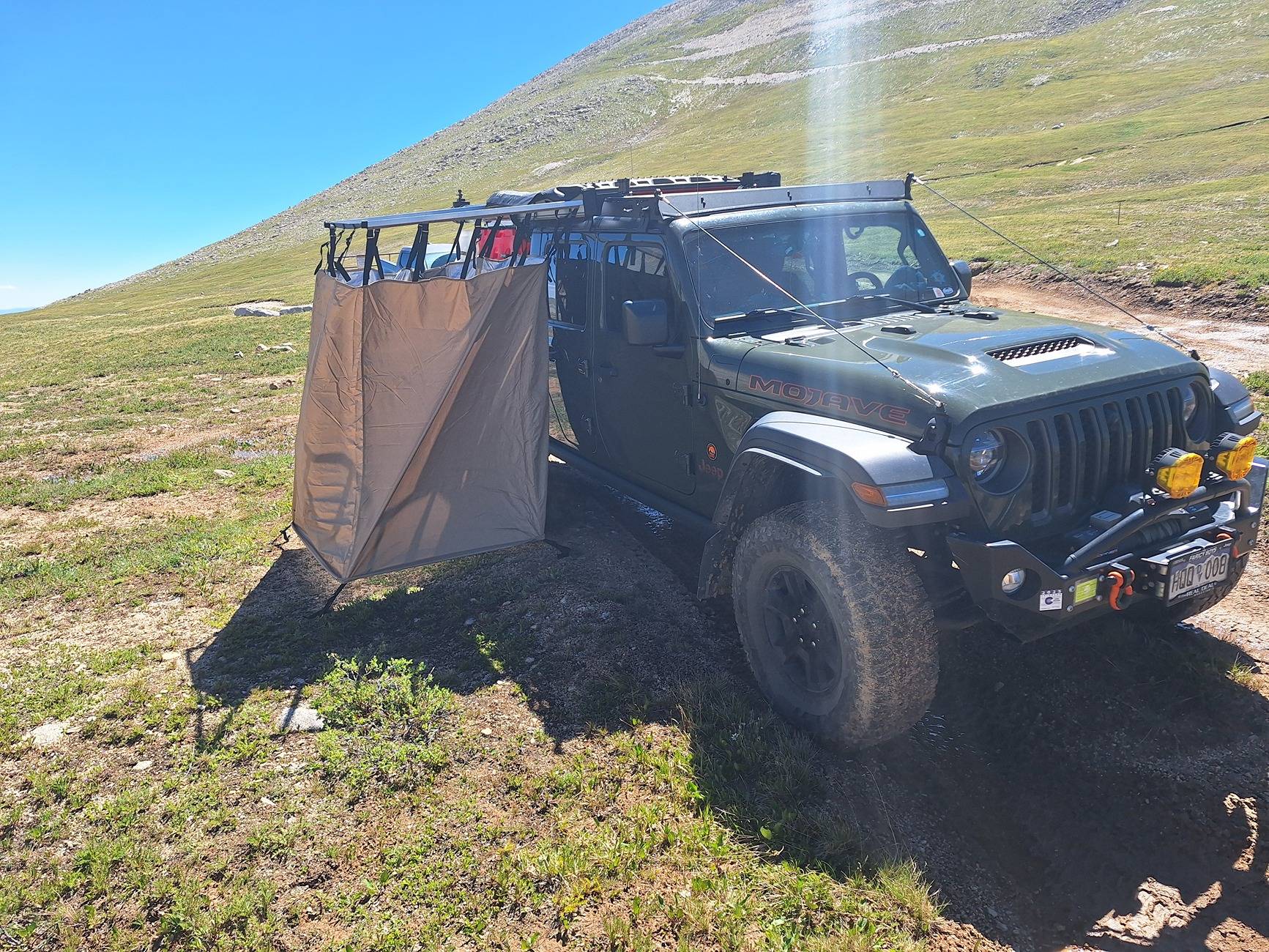

Mickeys
Jeep Gladiator HELP ME DECIDE - 35" vs 285/75/17 IMG_1791

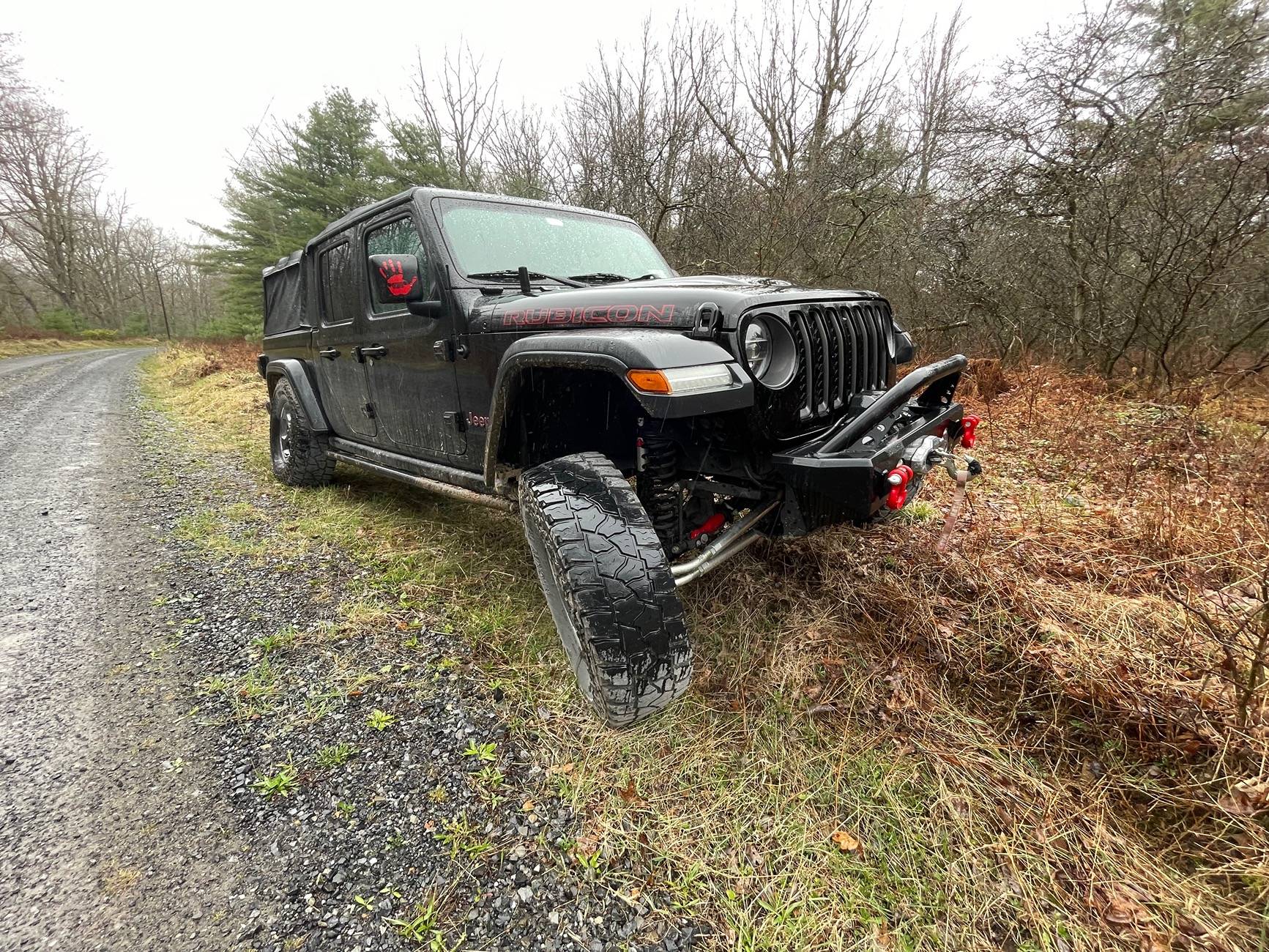

Kenda
Jeep Gladiator HELP ME DECIDE - 35" vs 285/75/17 IMG_3285

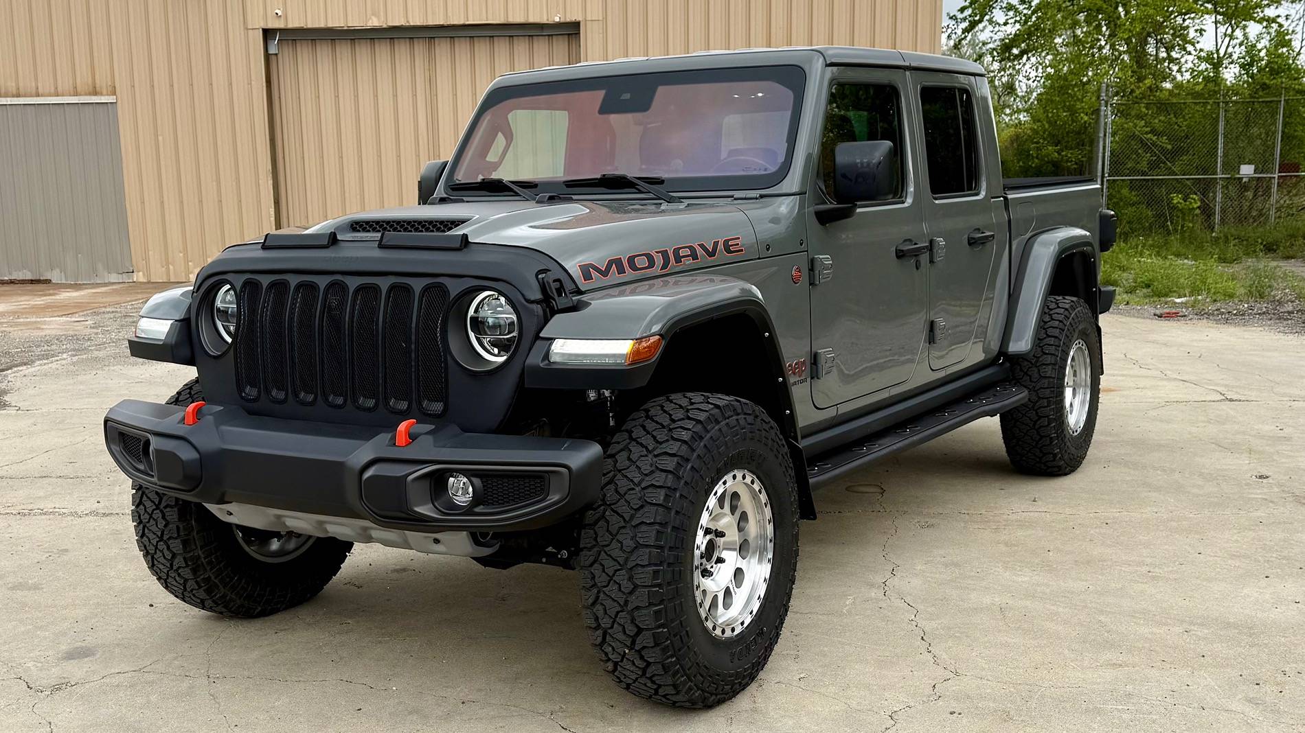

My 21 Mojave came with 33" Falkens. At 60k I replaced them with 35" Falkens and did the 2" AEV spacer lift. With the Mojave wheels I didnt need spacers, but I added the Mopar flare extensions and Rokblokz mud flaps. I live in Colorado and I basically lost 8th gear on the highway. I have since regeared from stock 4.10s to 4.88s and I have 8th gear back, picked up 1 mpg around town and 2 mpg on the highway.

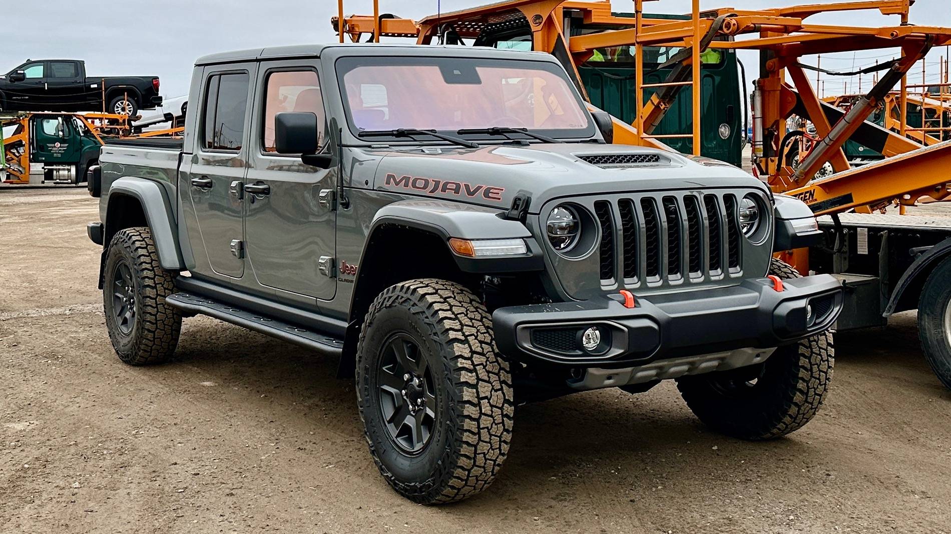

Not all 35s are/have to be 12.5” wide.
Kenda Klever R/T
35x10.5x17
Mickey Thompson Baja Boss A/T
255/85/R17 (34.6x10x17)
The Mickeys are by far my all time favorite tires. I absolutely love thems. Heck, I would push down my grandma for the last set on a shelf. Hah! I am wanting to sell the above mentioned/pictured Kendas for a second set of Mickeys.

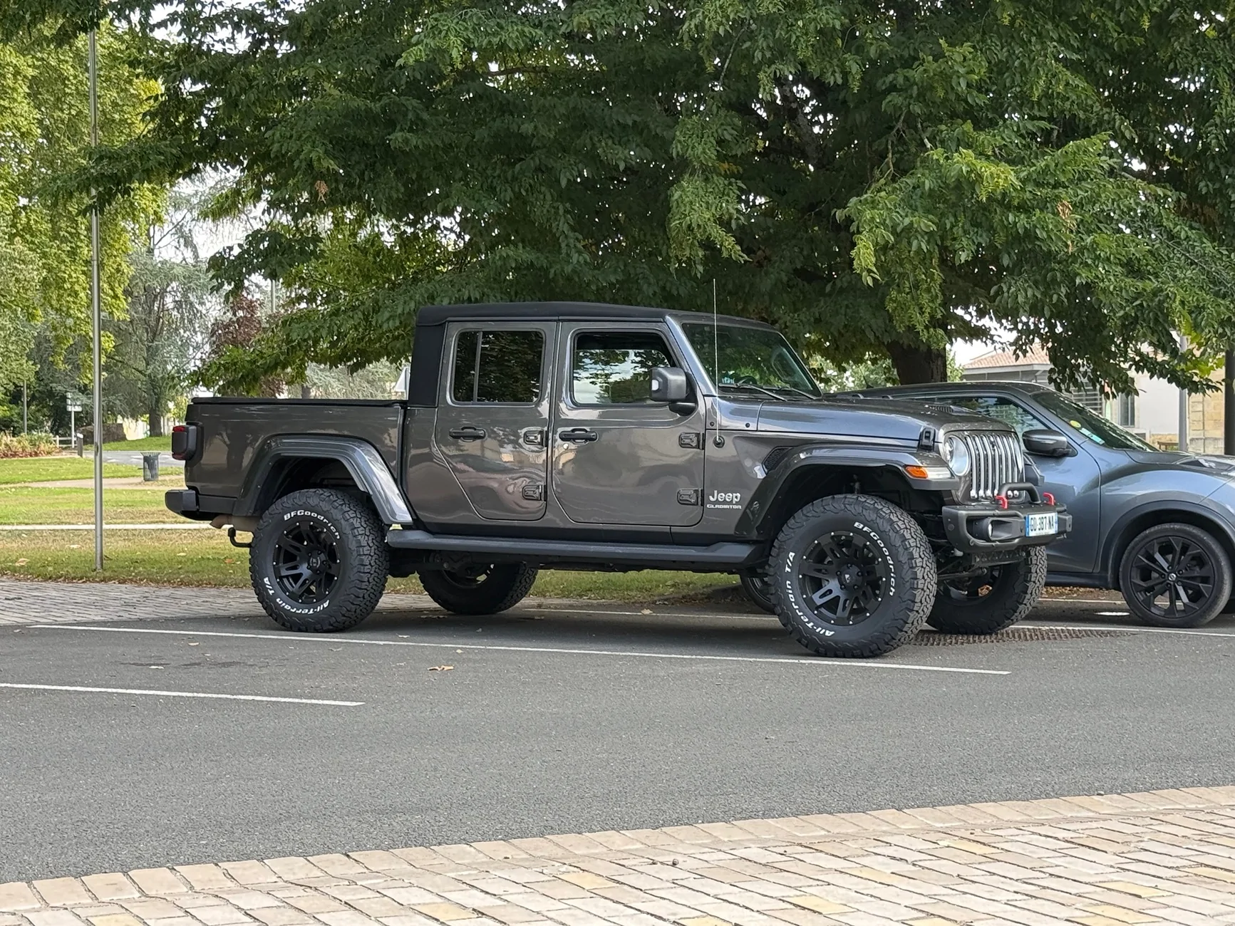

jeep gladiator overland v6 3.0
Mine with 35 12.5 R18, flare extension
