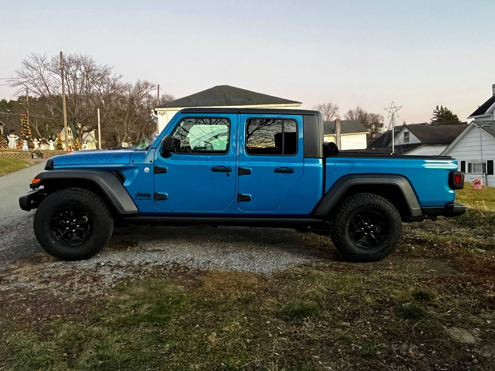

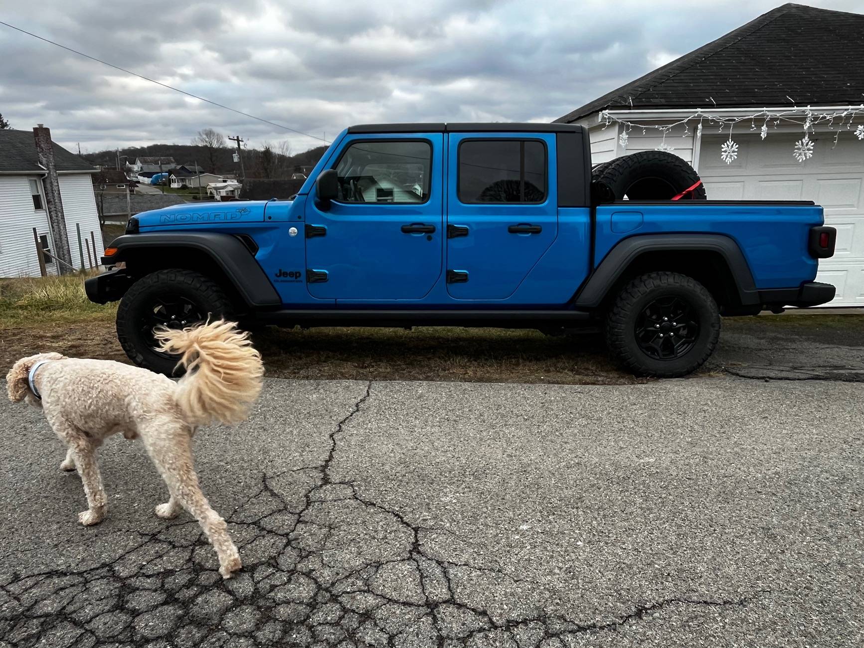

If it helps, here’s the (quite worn) Willys takeoffs vs 285/75/17
Jeep Gladiator 290/70/17 or 285/75/17 IMG_5413
Jeep Gladiator 290/70/17 or 285/75/17 IMG_5423
