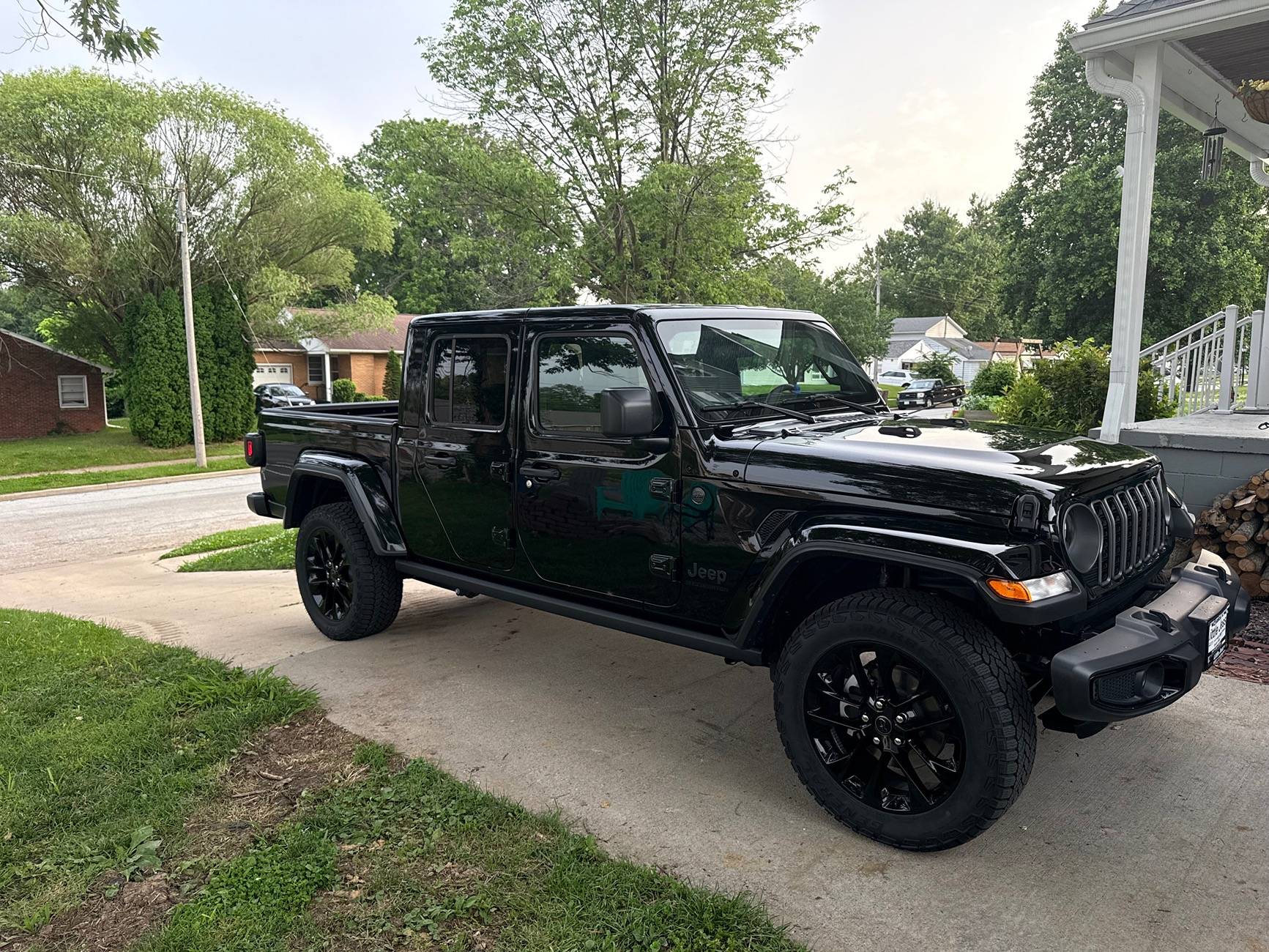

jeep gladiator overland v6 3.0
Mine with 35 12.5 R18, flare extension
Jeep Gladiator HELP ME DECIDE - 35" vs 285/75/17 IMG_8830
