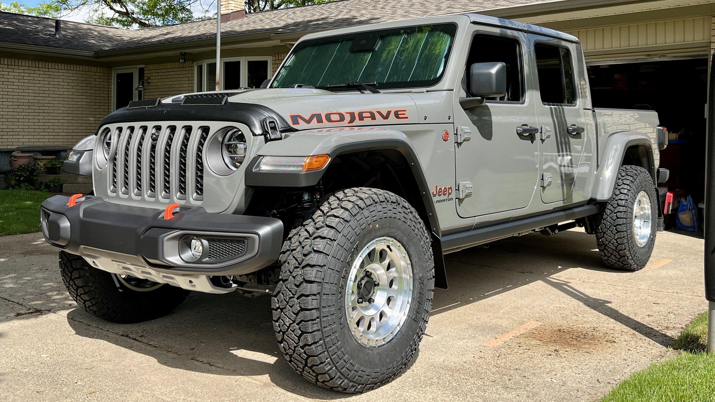

Morning,
I just picked up an ordered on March 12th. Mojave on Friday. Arrived Thursday (less than 100 miles from Toledo).
Yesterday (Saturday), installed new tires and wheels at 88 miles on the Jeep. Packing information said they shipped at 36 lbs. air pressure and I admittedly didn’t check.
After a short drive into town and back,, turning into the neighborhood (14 miles total), the TPMS went off, telling me “unavailable” and such on screen.
Purchased tires/wheels from a popular/reputable company and assume all should have just been OK.
I won’t get into the minor fact that they just seem to be unable in sending me the correct valve stem caps. Hah!
Anyhow… insight/thoughts/advice?
Thank you.
Method 315 17x8.5 and 0 offset
Kenda Klever RT 35x10.50
SD Wheels/TrailBuilt Offroad/Custom Offsets purchase (all the same).
¯\_(❛︣ ͜ʖ ❛᷅)_/¯
Other note!!
The manual’s torque specs for the OEM 22mm lug nuts is 130 ft/lbs. I cannot imagine the 19mm lug nuts provided with purchase should be torqued the same?!?
Thanks again and good day.

Check witch tpms sensors they used, they had a change recently and there are two different types used on the JT. My guess would be they used the older version and your JT has the most recent frequency ones. Torque should be the same, the threads are the same size just the lug size is different, I stuck with the oem as I preferred the larger lug size.
Wheels and tires look great btw.

Appreciate the information and thank you.
