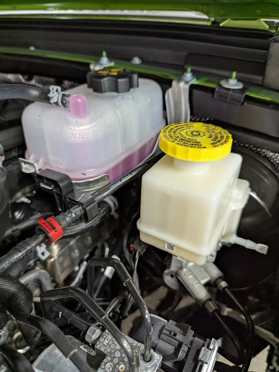

As for coolant every single new jeep jl or jt I've worked on (5 total) has the coolant low after a few miles from burling bubbles, quick top off has sent them all on their trouble free way.

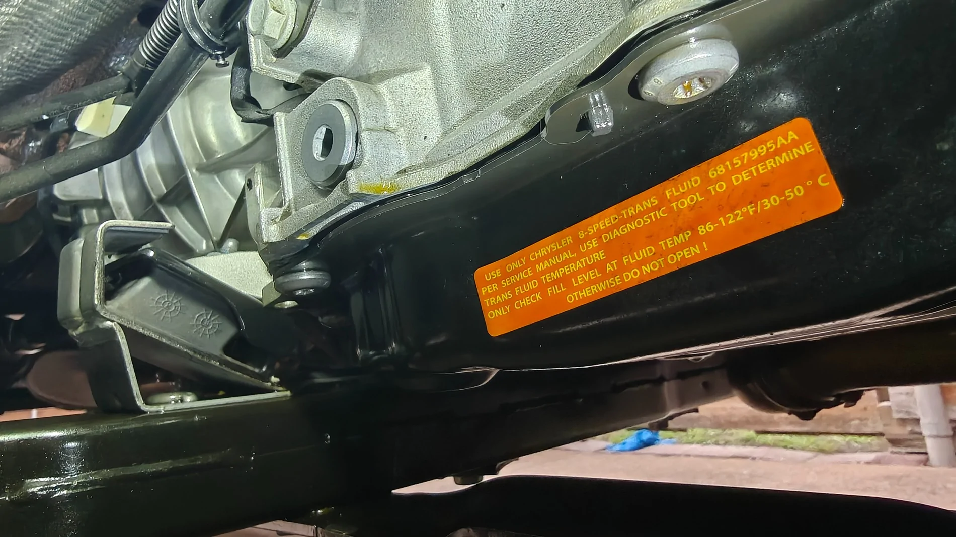

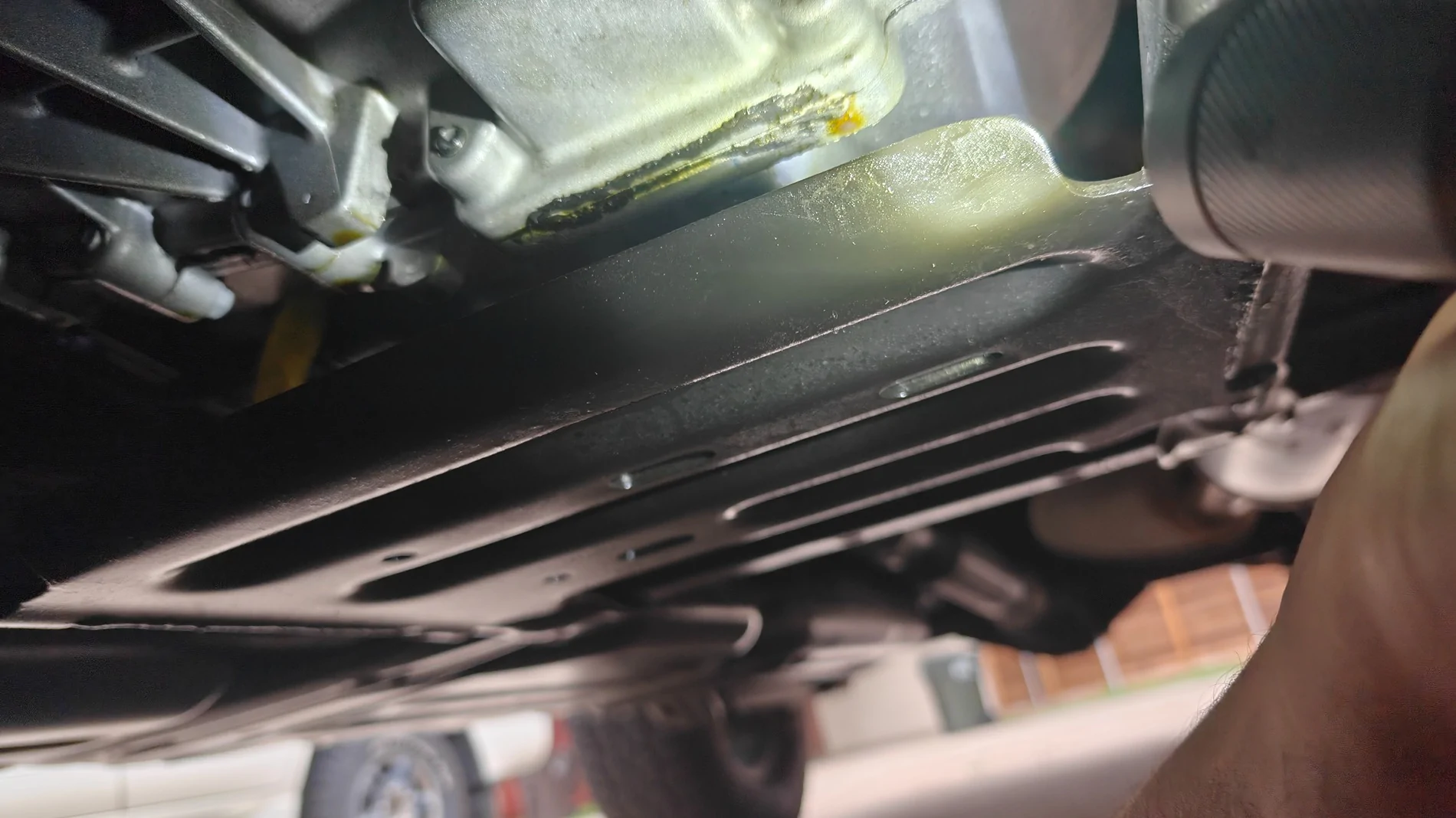

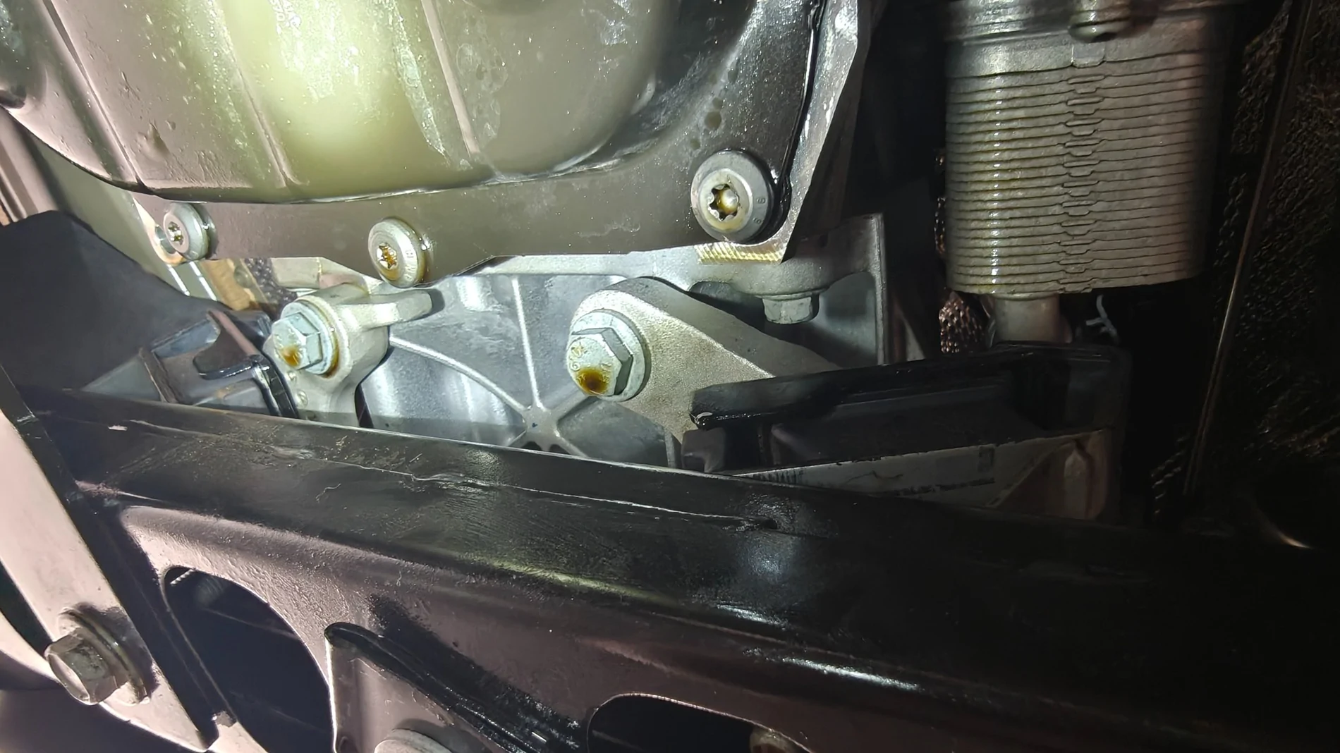

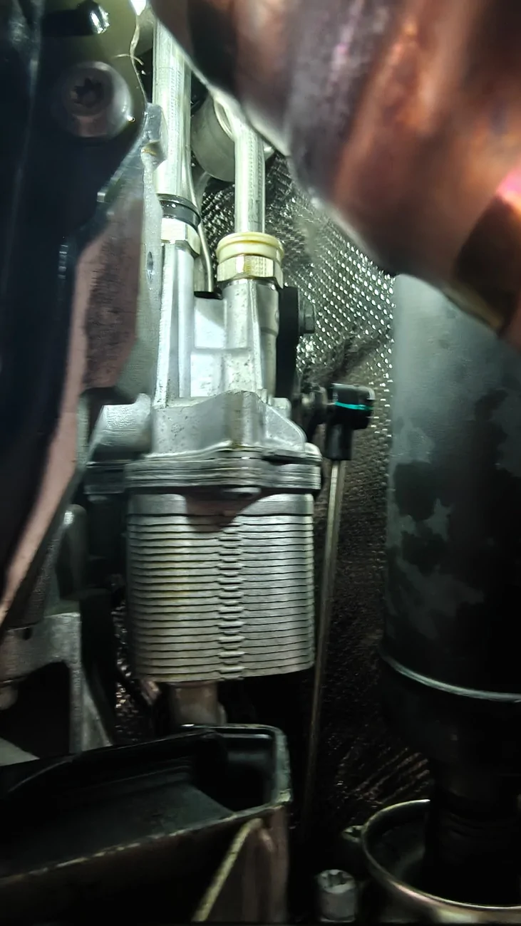

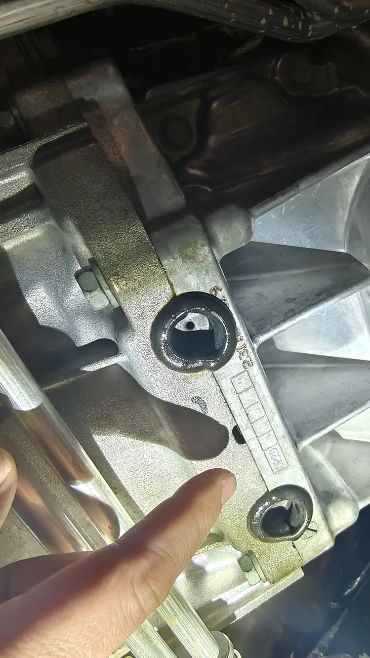

Brand new Mojave X less than 2K on the clock. Was installing mud flaps yesterday and noticed multiple oil leaks. Rear main seal, trans pan, and other fittings hookup points on parts that I don't know what they are. And the coolant level is low so it's probably leaking coolant as well. Didn't see any leaks at the oil filter housing up top. All below. Made in America. Sheesh
The oil on the side of motor above trans is motor oil. Hurry get it i there before it blows 😂
Just kidding .
Pull those inspection plugs shine a light in there see if oil is in there .

Funny thing is, looking at these pictures and looking at the pictures I have of my wife's JLU transmission leak - this looks a lot like that fluid, except for the bottom picture.

Are the plugs tight ? Did ya use a little thread dope.

No reason for that, or to accept it. They should not leak, especially in the first 60,000 miles.
If it has fluid on it, it's got a leak.
I've had transfer cases with over 100,000 miles on them - NO leaks.
Odd that people accept if or believe it's some right of passage or if it doesn't leak, it's not being used. Doesn't matter - it should not leak.
If I see seepage or a leak, I fix it. It means there's a flaw, or, it's not venting properly or similar reason.
I have a drawer of drain plug seals of various types. I even put new spark plug gaskets on those plugs that required them after pulling, cleaning and re-gapping them.
I keep teflon tape around, use new aluminum, copper or nylon gaskets where or when needed.
Some just don't care - I don't like the mess that can be corrected.

My transfer case has 136k no leaks
There is as you said ..no reason it should be leaking
