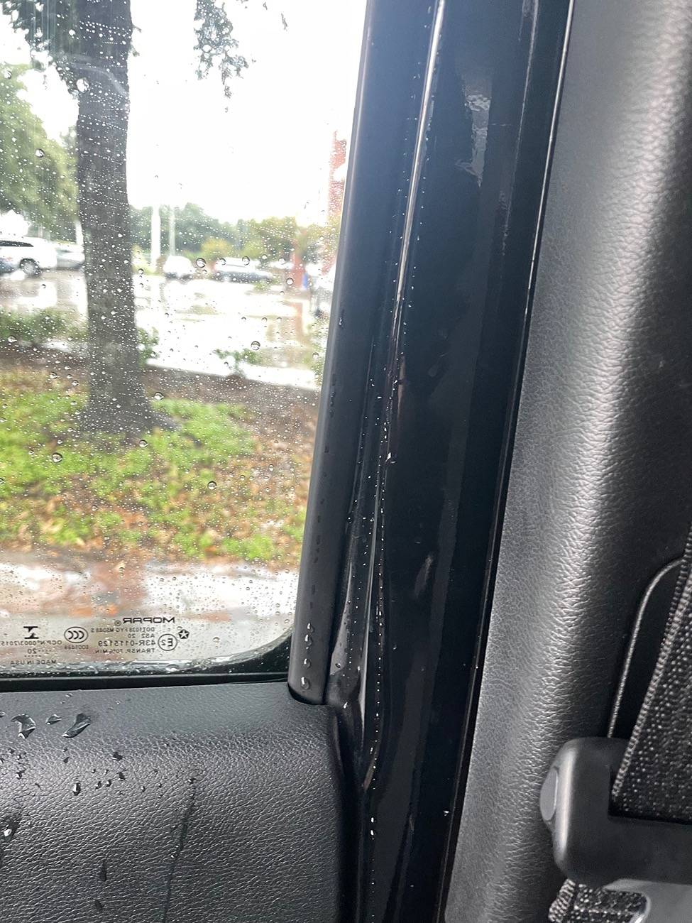

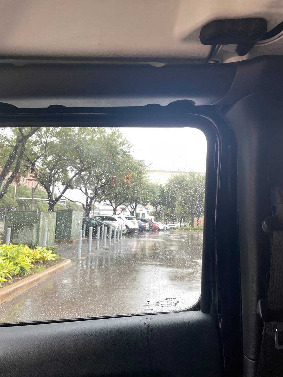

My 2020 Gladiator will not stop leaking around the front passenger door. I’ve taken it to the dealership three times and they can’t fix the issue. Sitting still, the water no longer comes in but when I’m accelerating or braking, the door leaks. You can see in the photo and the short video. The dealership’s trim tech said “It’s a Jeep and it’s gonna leak.” Does anyone have any tips for this? My son’s 2018 JL Unlimited does not leak so this nonsense about the Jeep leaking because that’s what they do doesn’t cut it for me. My old TJ never leaked.

That's not just after you shut the door, is it? If I'm on level ground, and I open the door, it drips down into the door frame and on my pants and runs down the window like you're showing.
I have a 2020 and I've never had a door leaking while it's shut.

The most recent incident, the door had been shut since the previous day. When I got in and started driving, I still had not opened the door at all. But the rain started coming through as soon as I started braking. When I open the door, yeah, the water comes down. But that’s expected, and I had to similar stuff happen with my old TJ. But, the door will have been shut for over 24 hours, and the water will leak through as soon as I accelerate, or start to brake. .

I think looking at the Freedom Top(s) is a good idea. If the water comes down after sitting, obviously it is pooling somewhere. My first suspect is the channel the tops fit into along the rear seals and edges. There are a couple points where the drains for this channel can get clogged allowing the water to collect. In addition they may have been squeezed/distorted preventing any water to escape.
Remove both tops and verify that the rubber seals / drains look the same on both sides of the Jeep.

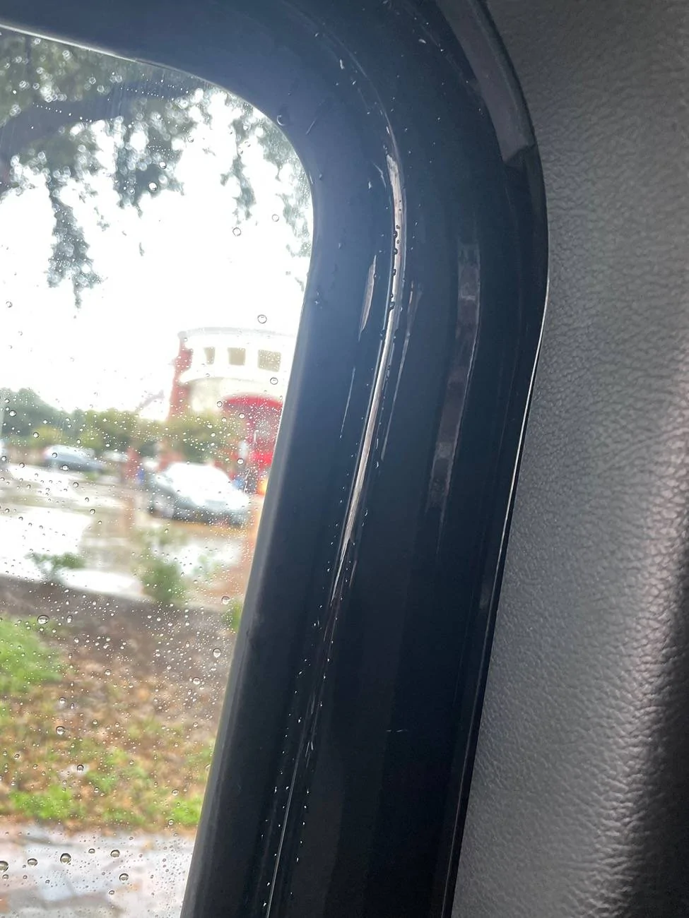

It appears to be the top corner at the back edge of the front passenger door and a little at the front by the a-pillar.

That's right at the track of the freedom panel. Check there for leaks, or something clogging the drain. You can always put a dye and some liquid and see how it travels..

Similar thing happened to me when I put a hardtop on my JK that came with the soft top only. Adjusted top hinge in a little and it fixed the leak.
Take a small slip of paper and close the door with it various spots until it slips freely out. That’s where it’s not sealing.

maybe a weep hole is clogged. check the corners of the hardtop as depicted in this thread

Can I see a gap above the door as you're driving? I think I can see the outside world passing by in a small crack above the door.
