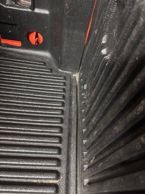

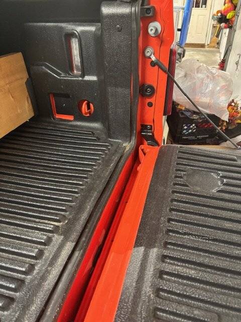

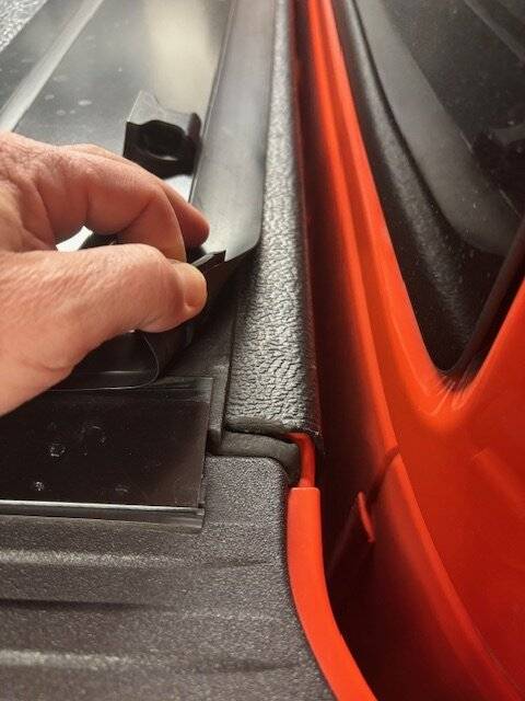

I have the same Mopar 3 section hard cover (2020 Gladiator dealer installed at purchase) and am very happy with the product. My experience indicates the dust is probably coming through the tailgate/bed gap at the bottom of the tailgate - not around the cover itself. I found that my items near the tailgate were getting wet when driving in heavy rain and realized it was blowing in under the tailgate from the circular push vortex that develops behind the truck when driving. I installed the RealTruck Extang Maxseal truck bed tailgate seal and voila - no water or dust.
My cover was reinstalled after i installed a drop in bedliner and a truck cap seal was added along the front edge as well.
Truck gasket/camper seal: Amazon link: https://a.co/d/5RNm7EB
RealTruck Extang Maxseal Truck Bed Tailgate Seal: https://a.co/d/cH9mt8x
Tailgate seal is installed on the edge of the bed where it meets the tailgate so that it is slightly compressed by the tailgate closing against it. It's been in place for almost three years. Go slow on the install and peel the liner as you check the fit with the tailgate and work your way around the opening.
Pics enclosed.
Good luck

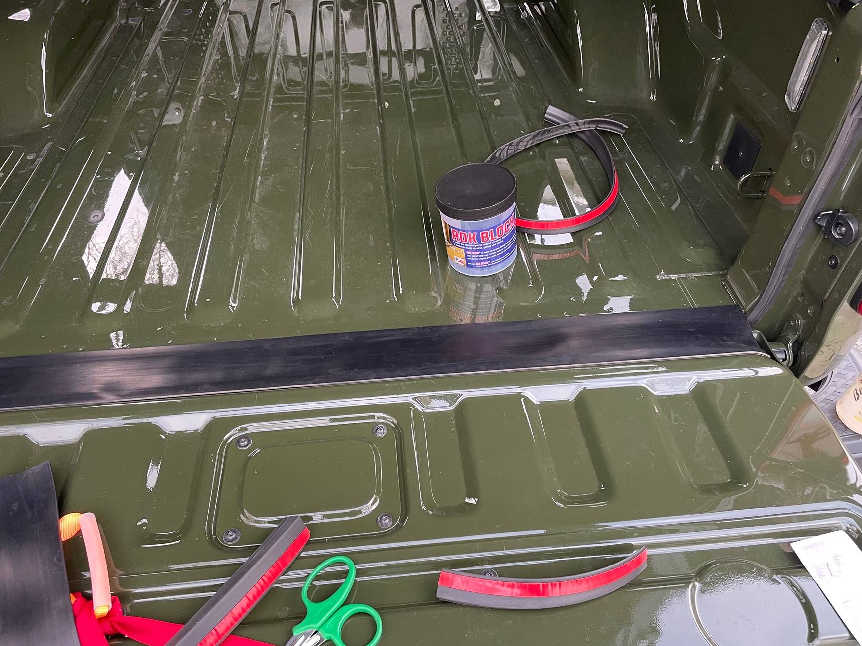

I used Rok Block on mine. They have a kit that includes the side bulb seal and bottom "thresh hold"
seal. I used some of the extra bulb seal and sealed both inside and outside side edges of the tailgate. I also spent some time covering all the holes in the bed with aluminum tape or rubber plugs, including around the lower cargo loops. So far I have had less dust getting in than I did on the JK I used to have.
