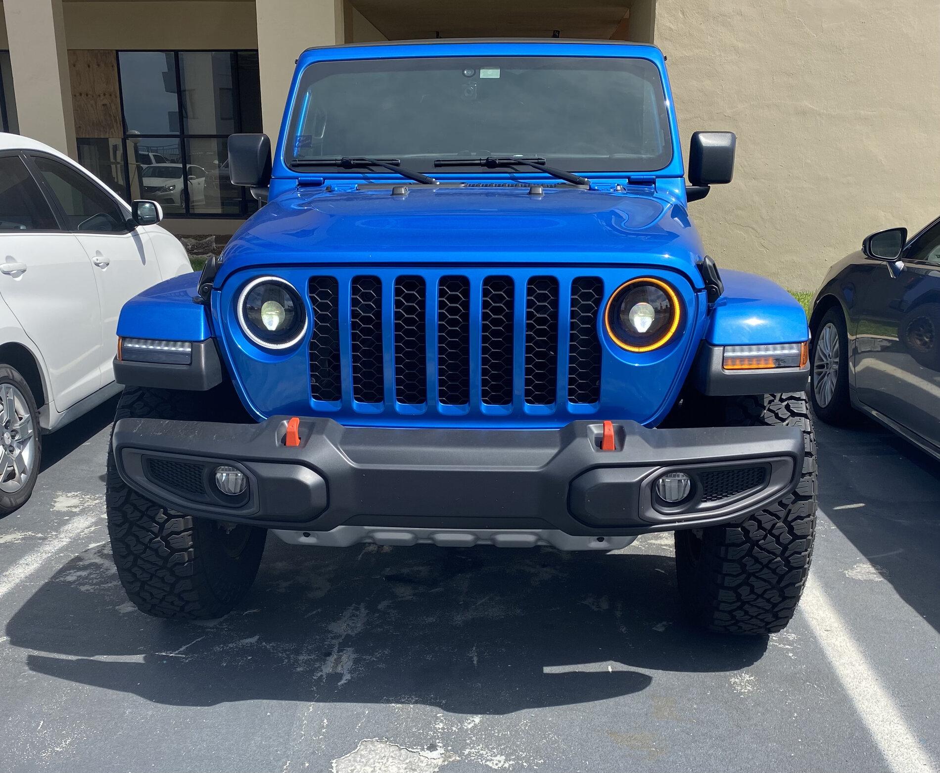

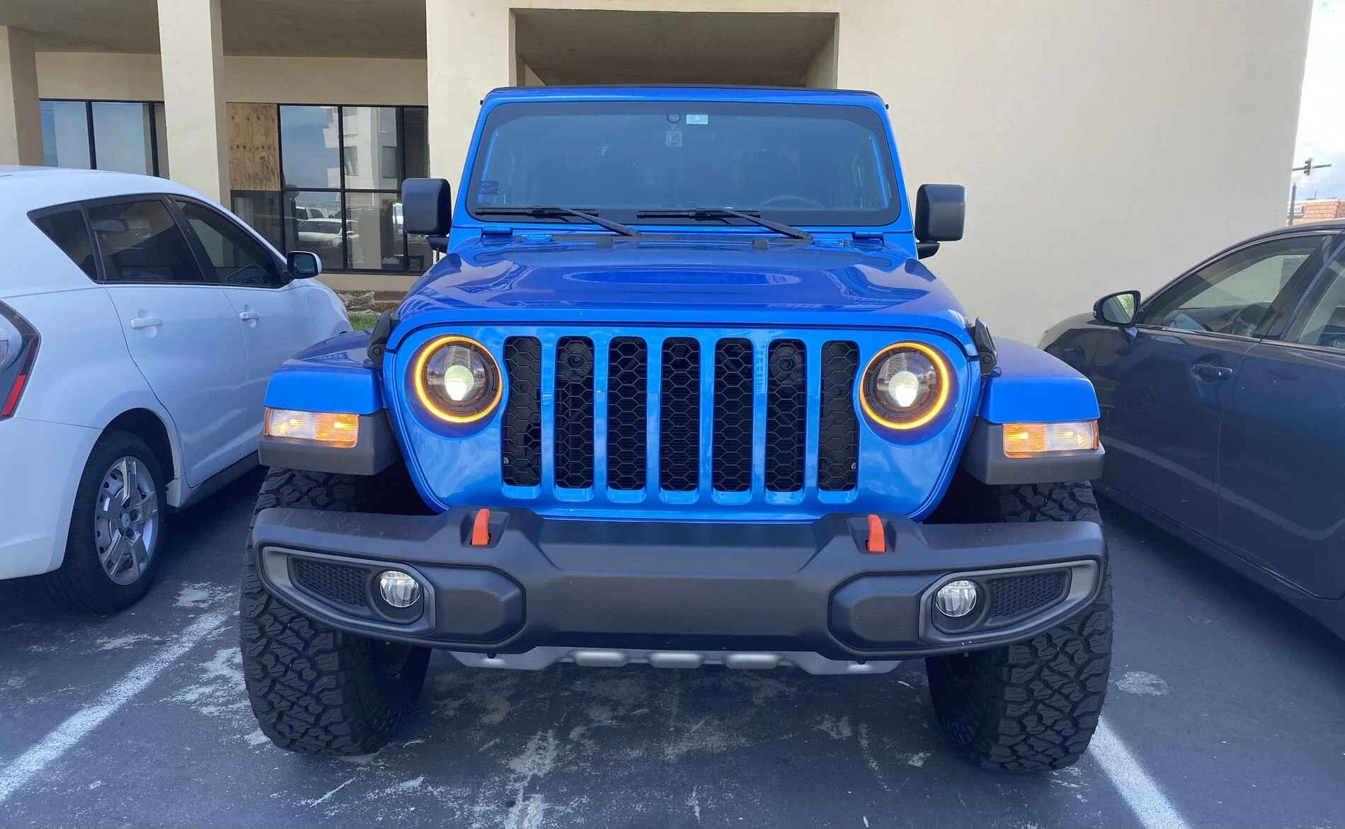

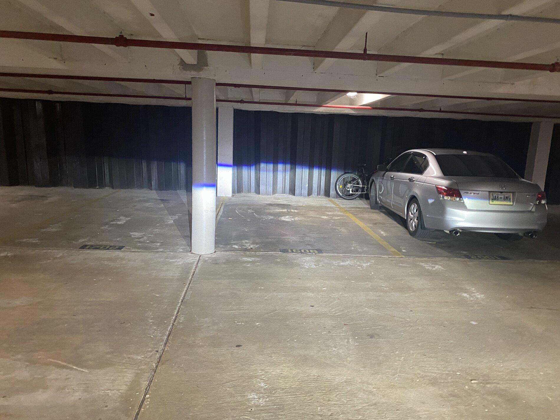

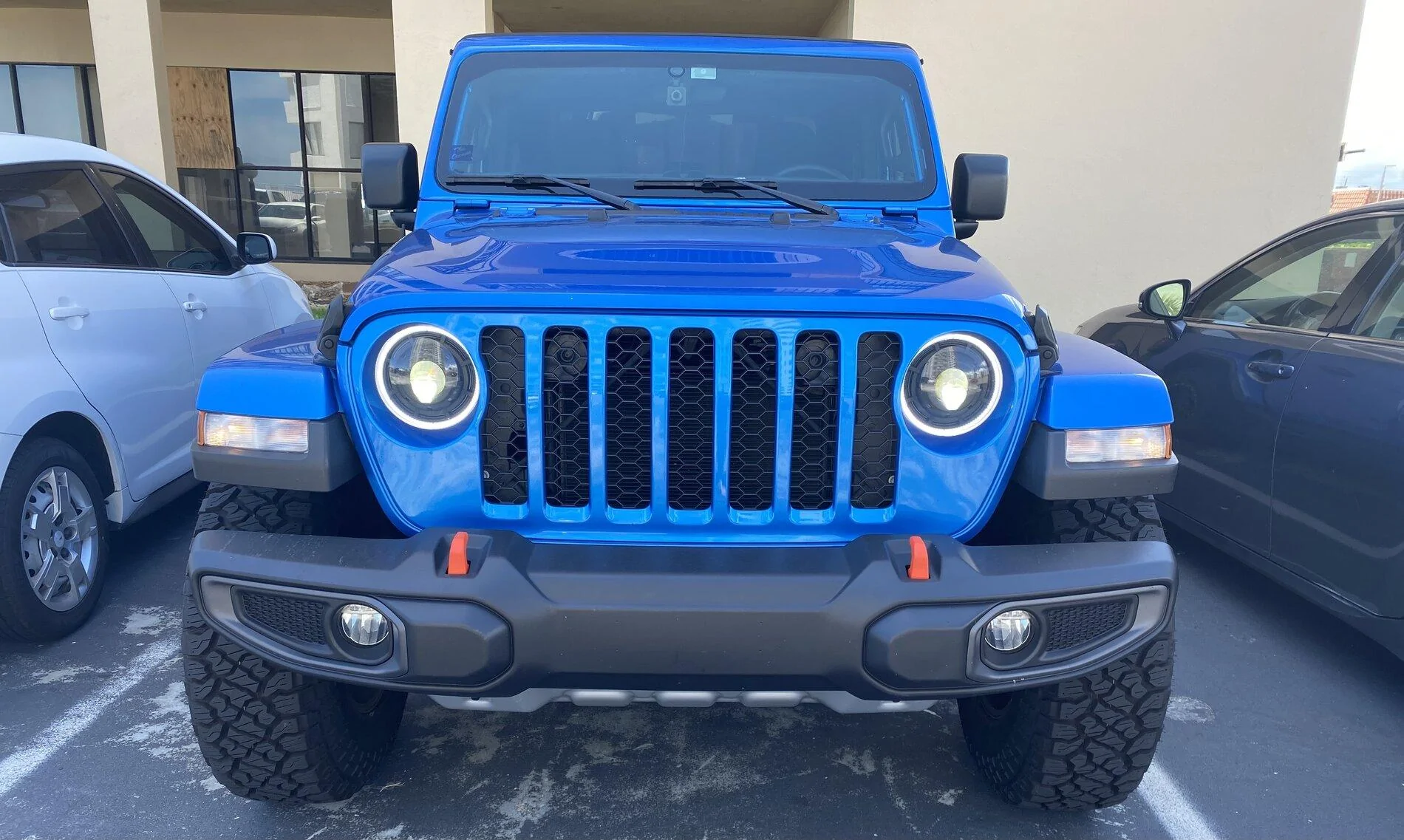

Just installed the new harness, light output is good, I haven’t tried the Mopar LED’s but these (naturally) blows the halogen headlights out of the water. Now, the led switchbacks does not seem to play nice with the halogen bulbs in the fenders, so everything just started freaking out after a few seconds with hazards on. I haven’t played around with the J-scan yet, since I have a set of Morimoto XB fender lights that are going in next, to complete the front LED conversion.
Edit: Installed the Morimoto XB’s and everything is working as it should! I can confidently, fully recommend these headlights, with the caveat that you have led lights/bulbs in the fender lights. Now, I just have to wait for @ORACLElights to release the tail lights! ? Added a pic with the Morimotos installed, for good measure.
For the fender turn signals / drl it appears that you swapped out the factory halogen complete housings for LED housings. How much trouble? Where did you get the parts?
Thanks in advance!
Great look!!
Thanks in advance!
I don't want to hi-jack this tread, so I'll send you a DM!
