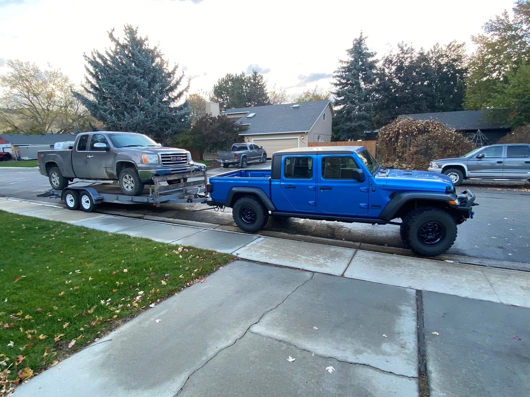

Bonkers? How so? Maybe you need more info…like you I live mostly in the desert and usually roam out with just me and the dogs. 12 ply MT tires can handle a ton of nasty dirt, rock, brush and trails. Not just the easy endless miles of gravel roads, but really rough environment stuff and bring me home, Every time. (Knock on wood) The 6 ply sides walls and the 12 ply carcus has handled everything I’ve ever thrown at them. Not a single side wall slice with lots of miles on razor sharp shale rock, loose and deep. This environment is my normal. The lowest pressure I‘ve put them at was 10lbs, it was a ex river bed in a steep rock walled canyon that was deep loose sand I remember it to have been about a 20 mile ride. The 6 ply side walls handled it easily, without any roll offs. I did few of my early years with the forest service, this was the go to tire type for all there vehicles. Highway, hauling with excessive weight in the rig or trailering a heavy load, put 50 to 70 psi in the rears and those tires with that pressure really help control the load at a moderate speed. Attached pic is point in case, this was an emergency tow of my sons truck that died 40 miles back in elk hunting, put on the WDH and 65 psi in the rears, smooth sailing all the way home. The only thing you have to get use to is at 40 psi, empty bed, in town or on the highway it can get a little bouncy with ruff pavement. I have airbags in the rear coils that allow me to fine tune it for cargo weight differences.
This is a truck, I treat it like one, I haul, I tow, and I wheel it. Wouldn’t change anything on my tire selection or pressure. I don’t fret about these tires and pressure taking and bringing me back home.
