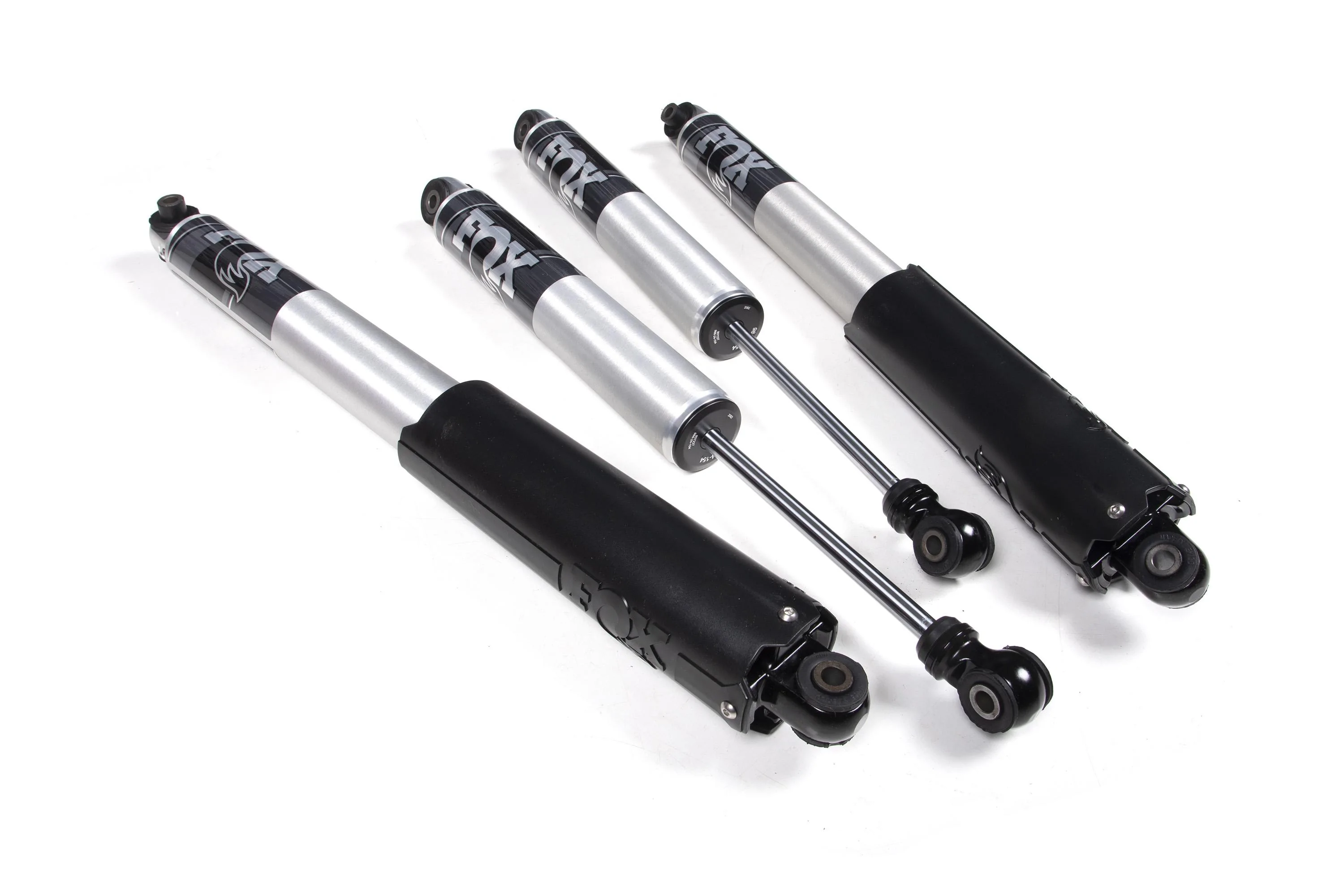

The reservoir on a Fox 2.5 Elite really doesn't do much for cooling since the hose probably displaces more fluid than the shock shaft. The oil within the shock probably never reaches the resi anyway?

???. This kind of goes back to post #40…
So to collaborate both posts, and without getting into the intricate nuances….
this is one of those scenarios where just having a proper shim stack for the weight and spring info is perfect. These 2.5 fox’s if ordered with the correct shims is all he would need.
So who do we know that has the proper shim stack and extensive testing on a diesel JT with 2.5 Elites that can steer him in the right direction?
