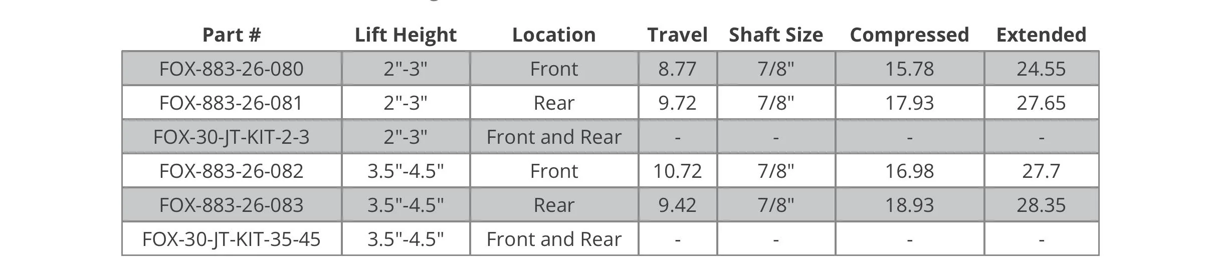

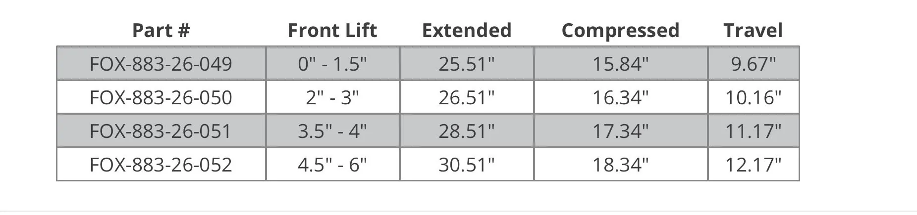

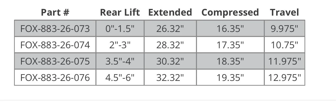

Do you guys have a spec sheet like this?
2.5 rear
Jeep Gladiator NEW RELEASE: FOX 2.5 Performance Series Shocks 4F185424-3FF4-43DE-AAA1-1711A393D7FD
2.5 front
Jeep Gladiator NEW RELEASE: FOX 2.5 Performance Series Shocks DD7812B2-812C-469D-8890-F07AFE0024DD
3.0
Jeep Gladiator NEW RELEASE: FOX 2.5 Performance Series Shocks F11ADE83-8633-4660-8E9B-8500B0E3F79F
