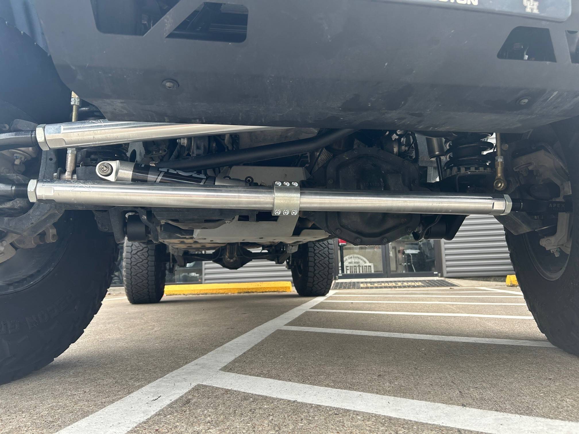

When I installed 37's, the Jeep still drove well considering the level of modifications, but I could ''feel" the steering was not up to the task anymore. Yes, it worked, but it would struggle a bit in parking lots and slow speed trails and on poor roads, the Jeep would hunt side to side.
I installed the Apex 2.5 ton kit with a Fox 2.0 stabilizer and pump booster. I chose the Fox 2.0 you mentioned because it was a little more budget friendly and as funny as it sounds, would "match" my shocks. The driveability of the Jeep is night and day better. I can run 80 mph with one hand on the wheel and relaxed. Once broken in, I turned the pump up to 2000 psi and the steering is light, smooth but stable.
Jeep Gladiator Adding a Fox Performance Series Fox 2.0 IFP Steering Stabilizer glad1

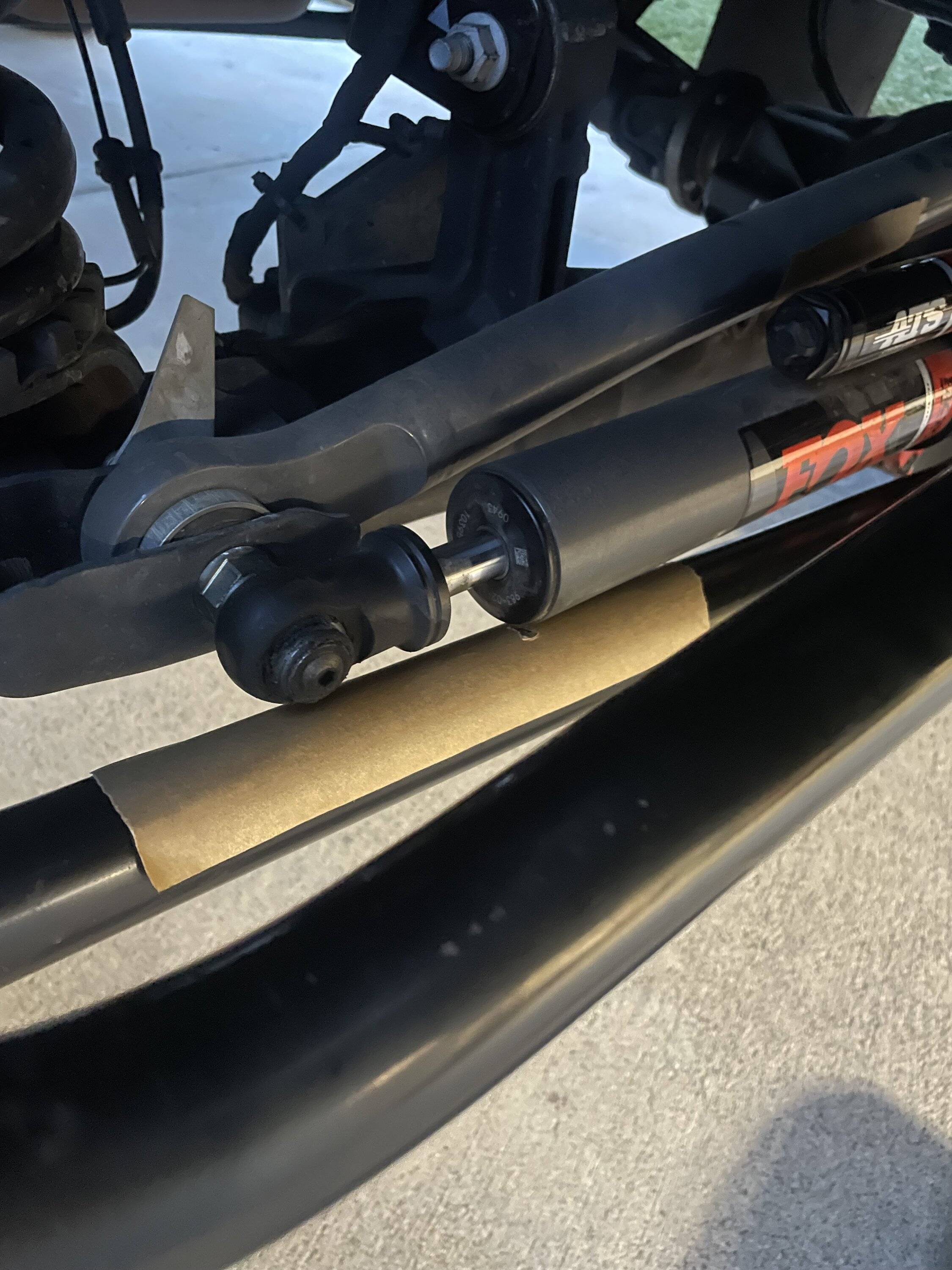

Jeep Gladiator Adding a Fox Performance Series Fox 2.0 IFP Steering Stabilizer IMG_7383

as you can see my Fox ATS is contacting my factory tie rod lightly in this position. I have a Fusion tie rod that is larger in diameter and I am fearing it will make harder contact. Moving it in the mount makes no difference. Just wondering what to do? Also on the tie rod bracket end the rubber O ring id coming out of place. Not happy with this .
