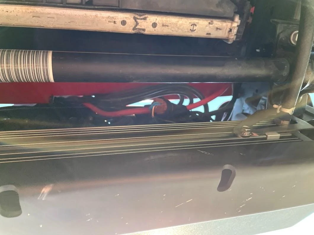

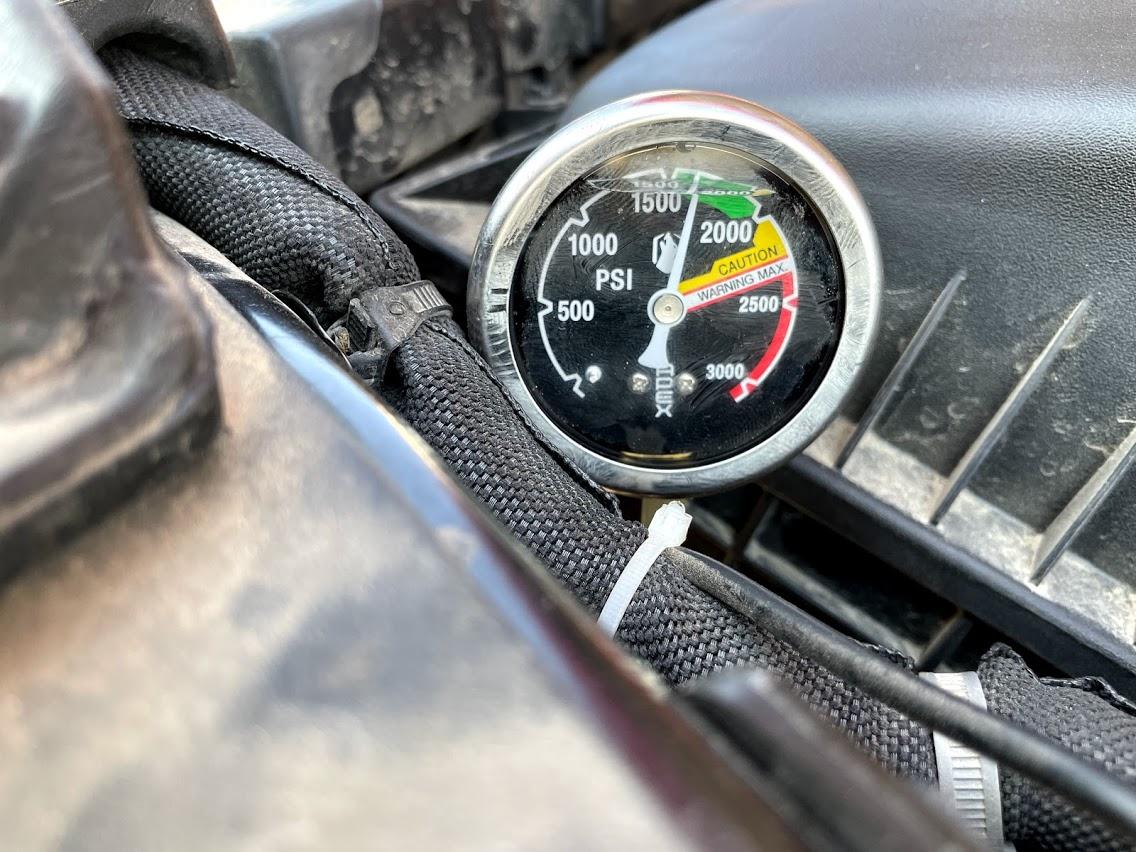

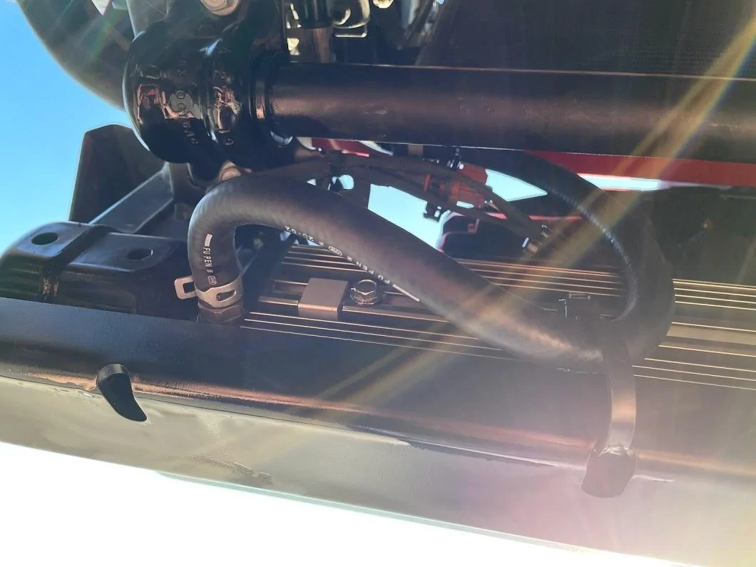

Well first impressions are very good. It takes very little effort to turn my 37's at a dead stop on pavement which was a work out before. On gravel while stopped it was a single finger effort type of thing. If I am awake enough for it there is a night run to my favorite local trail Saturday Night so that will be the first real off road test.
The guy who installed it said the hardest part was running everything where he was happy with it. He used a piece of the stock hard line that is normally removed & did a little loop to make the runs clean. Its mounted rather low in my crash bar's which I knew was going to be the case since my bumper has the winch very low & far back. But this location also has a good gap between the top of the CavFab skid plate & the bottom of the Ace bumper so this should have a fair amount of airflow as well.
Also of note is that its only at about 1600psi so its only about 300 psi over stock. Another 400 before I leave the Apex Green Zone.
