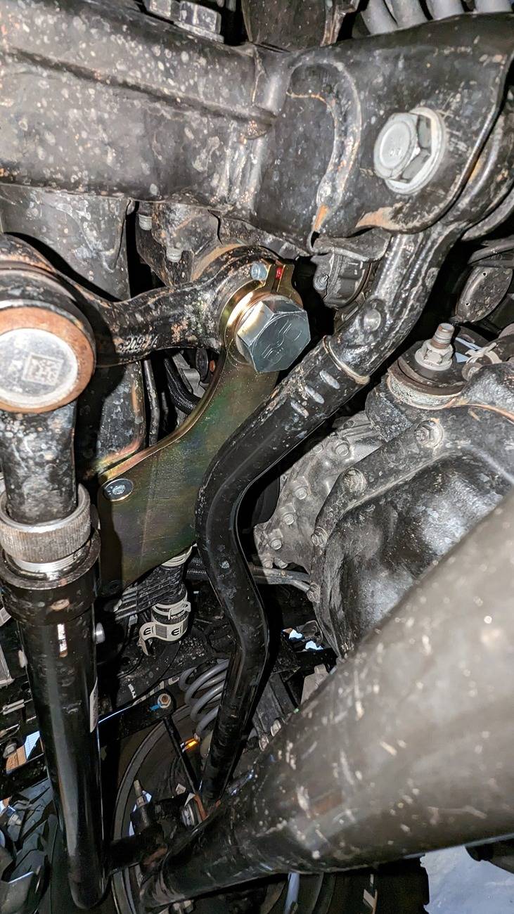

This a very good bracket installation video with some very useful techniques and tips.
One thing he doesn't make super clear is that you should always torque the control arms with the tires on the ground under full ride weight.

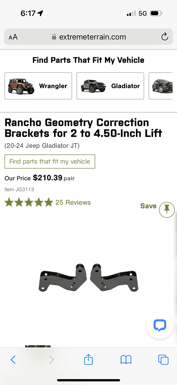

for my stock height Mojave, should I go with 2-4 1/2 inch ?
For stock height Mojave , I think going with longer Mopar lift control arms would be first step ,Lunentuker has a 2”” lift on his. Mine is factory height and I think handling is great except for play in steering box and the Noisey shocks when starting out. I enjoy highway cloverleafs at speed, and think the ride and handling is much better then my Tahoes and Suburban was…..Jack
