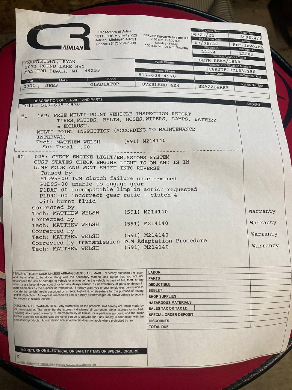

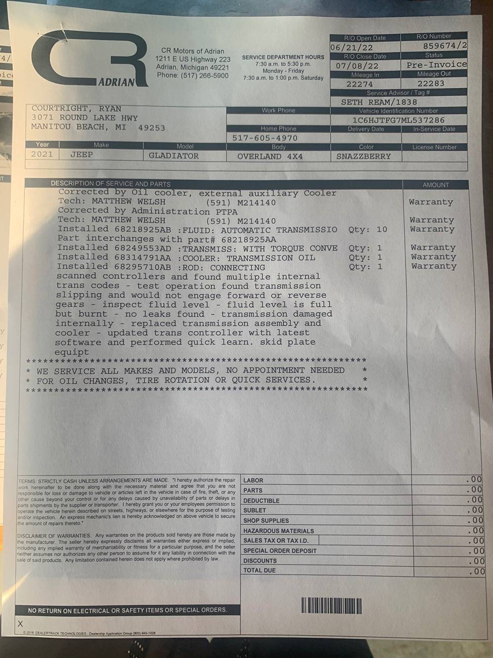

Just got a p733 code when the check engine light came on. Says incorrect 3rd gear ratio. Whatever that means. The only thing different lately was a loud clunk when shifting into reverse, but only after sitting overnight. Dealer says fluid is completely burnt. Waiting on authorization for the replace.

Does anyone know where a transmission could be taken to ,to be rebuilt/remanufactured.... I am trying to get an idea of cost also associated with a rebuild verses a brand new or used transmission.
