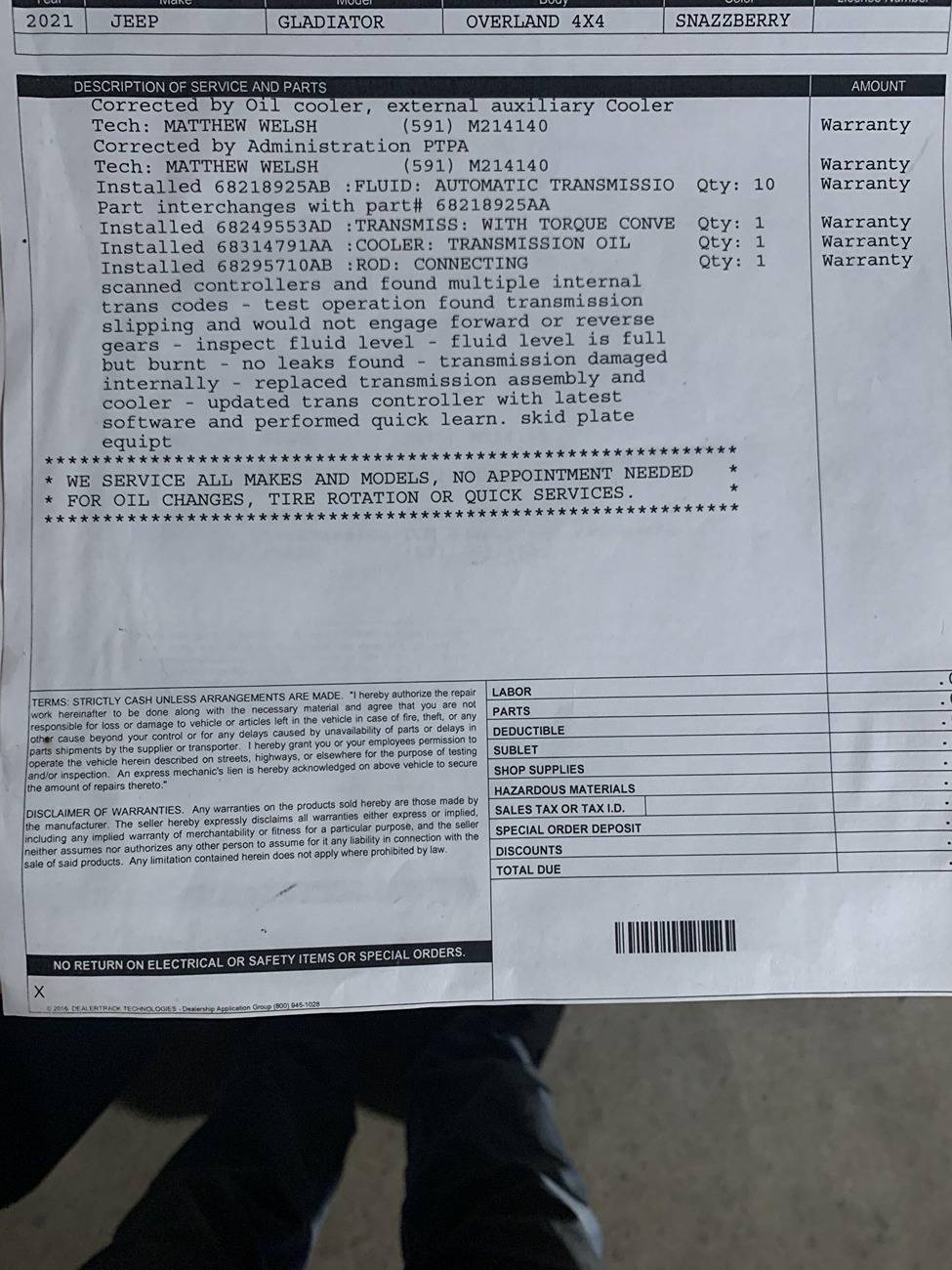

Mine got a new transmission.
Jeep Gladiator New tranny at 45,000 miles. Wtf🙈 69ED833E-71D1-4588-9562-6C95B0A0CACF
40,514
54,044
Yup - there's the part number for new. (I'd believe you anyway - you could tell by the decal or number)
Interesting.
We're a year into the replacement on our JLU and it's been working absolutely perfectly and is totally leak-free.
But then - the JLU 4xe transmission is indeed made in Germany by ZF while the standard 8 speed like in the JT is made in the USA by Chrysler - so that's a point I likely didn't consider.
