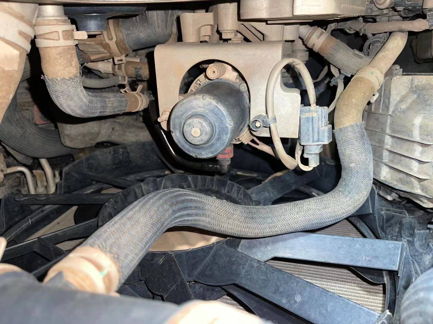

Like others mentioned, it is the electric vacuum pump. There is no manifold vacuum pressure tap, it is all electric by that vacuum pump. When you apply the brakes the first time, it is just re-priming the vacuum pressure. That is normal.
Stole this pic from the JL side.
