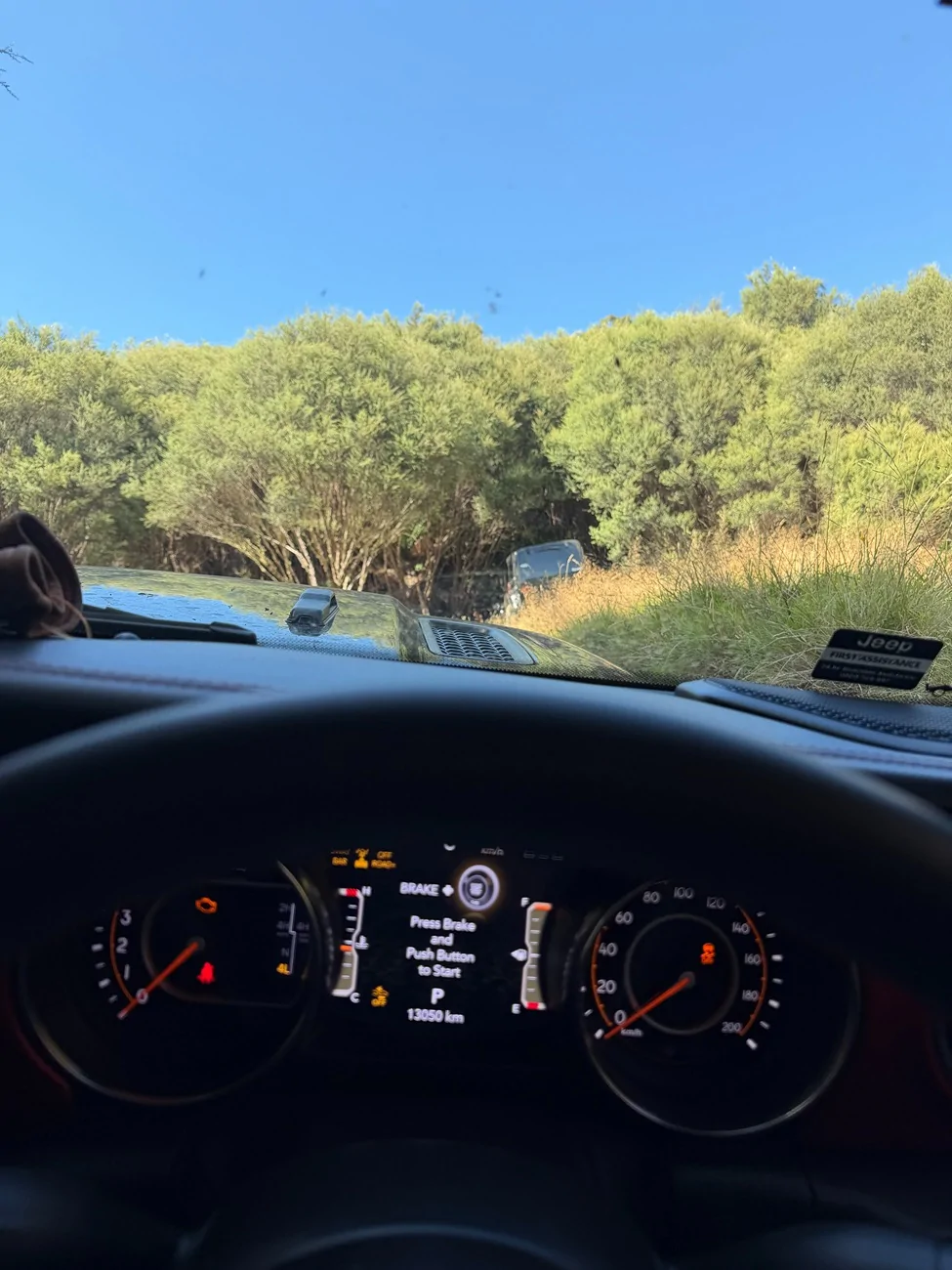

UPDATE: This problem is solved now. The engine hydrolocked on a steep climb and bent some rods at 13,000km and Jeep NZ are replacing the whole engine under warranty. If the new one rattles the same I'm out.

Jeep Gladiator Engine rattle in new Gladiator - better video Dash view after stall out

The final photo is of the instrument panel showing no alerts except the amber check engine which came on after the lockup. I'd have been doing maybe 2500-3000rpm at the time.
Hydrolocked? As in water in the combustion chambers? That's what hydrolocked means. It means fluid, such as normally water, in the combustion chamber, which cannot be compressed, locking the engine up.
Hydrolocked is not at all related to detonation.
Detonation can cause spark plug insulation to break and can deform or damage or break piston tops, but that's unrelated to hydrolock which usually happens after crossing water and sucking water into the intake.
