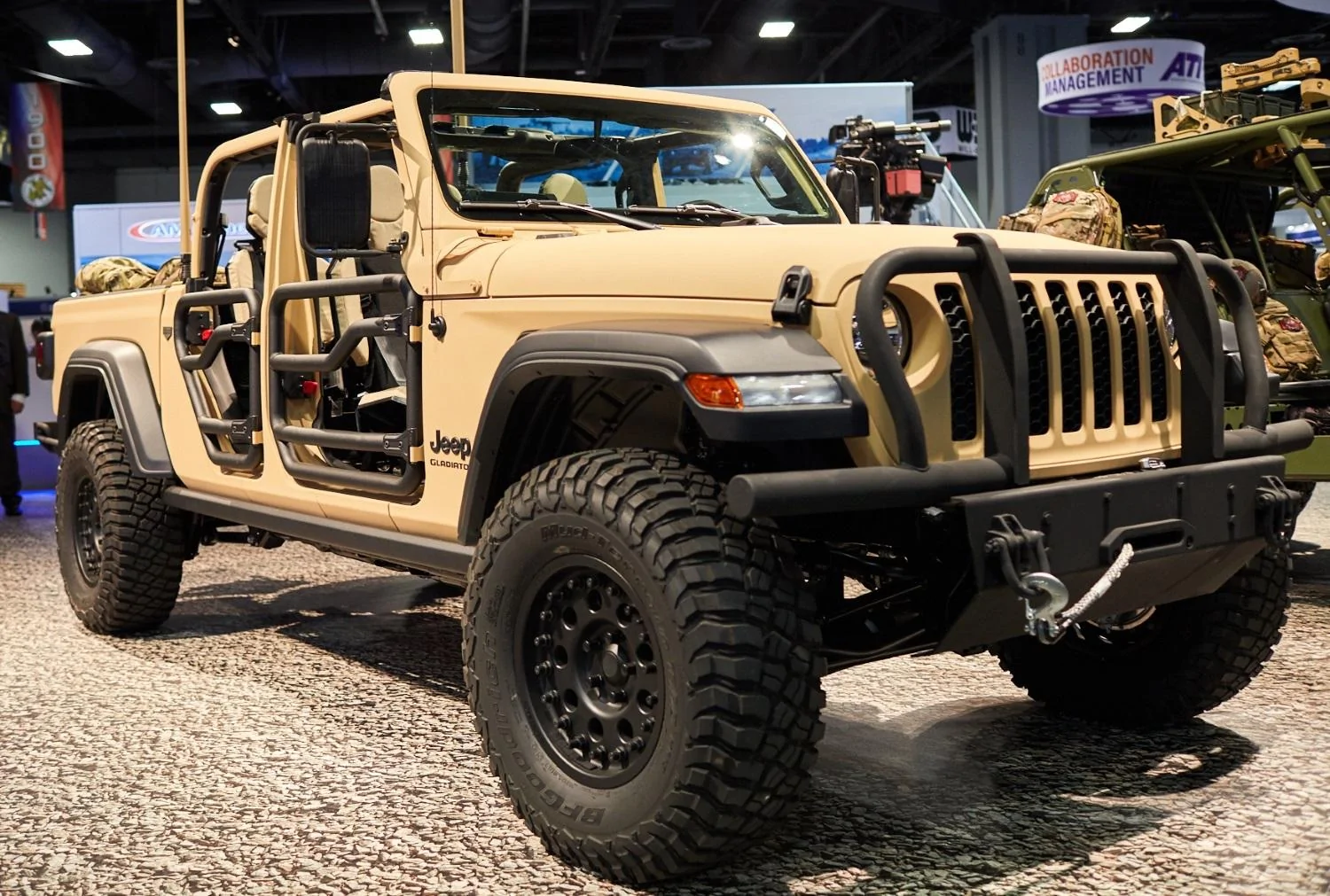

JPP Mopar off road wheels (and Jeep factory Xtreme with 35’s) are standard factory +12, thus they do not stick out and create all sorts of problems with wear, tear, and greatly increased stress loads on entire front end, buying yourself a ton of problems. His Rubicon is equipoed with the new (2018 and up) factory standard Advantec M210 wide front axle, so the wheels and tires are already moved out, a bit. Also, with 37’s, you’re buying extra trouble with rubbing/scraping, particularly when encountering obstacles off road. Now, for a mall crawler, you can get away with some deviation from factory stock +12. Depends what your goal is.
The US military ‘means business,’ and has no interest whatsoever in pursuing ‘mall crawlers,’ thus note (what appears to be) the standard Stelantis wheel offset of +12, juxtaposed to a bunch of teenager brodozer negative offset. Food for thought…
But, it all depends on what you want! Mall crawler brodozer vs/ ‘The Real Thing.’
JM2C, IMHO, and YMMV!
