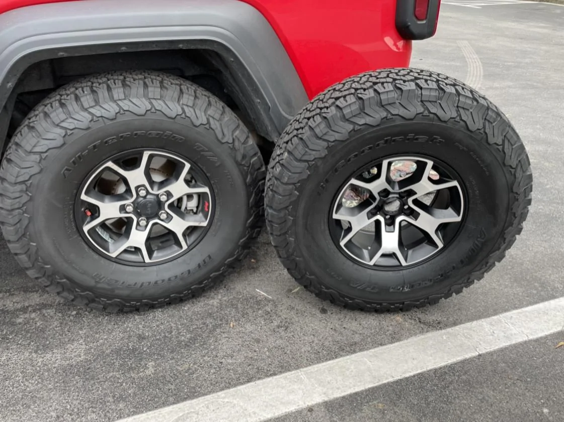

Prove me wrong, you cannot find a single manufacturer that makes a 315mm or 12.5" wide 35" or 37" tire and lists a 7.5" wide rim as suitable to be mounted on.
My proof is actually using these tires for this application. I’ve done it for years with no issues… just like having spacers, I’ve used them for years (the best, hub centric with lock-tight never an issue but check at rotation).
I agree do this under your own personal responsibility for any issues.
discount tire is big and mine is very restrictive so do them to say the 37’s are fine on a 7.5 rim , and since I’ve had plenty of experience with this setup, I accept the responsibility.
Now if your an idiot and drive under pressure on road and off road. If you take corners like your driving a Lamborghini in a lifted, big tired, big side walled jeep (or whatever auto) then this application… really any application is not for you.
I have a lot of experience with Jeeps in many configurations. I’m just saying it has always worked for me. With current back order situation, the wheels I want are not available until November/December time. They are on order a 17x8.5 with 5.2 BS and when I get those they will replace the 7.5’s.
All im saying is two things;
1- discount tire said I can have this BFG set up (they are very restrictive on everything I’ve ever taken to them. and I always push the limits, including my GT Mustang on 22x9 (they wouldn’t touch these that came with the car when I bought it) now they replaced the 235x35x22 Chinese crap tires on 22x9 wheels with Michelin 265x45x20 performance tires and 20x10 wheels Squared (meaning same rim and tire for all corners).
2- I’ve done it for many years and I’ve used spacers hub centric 1.5ā€ ?? with 0 as in Zero issues for 100’s if thousands of miles over 20+ years.
do at your own risk, don’t web wheel me, this is just field observations. I am guessing you haven’t had a lot experience with Jeeps or 4x4’s for that matter.
if you are wearing a mask in your car by yourself on the interstate… well at anytime (unless you just have a bowel problem and you are concerned) then move along and leave the info for others to decide.
the two rims and tires pictured;
1- one on the Jeep a 17x7.5 rim with 37x12.50x17 BFG AT KO 2
2- one off the Jeep is a Quadratec replication 17x8.5 with the same BFG AT KO2 37x12.50x17 tire

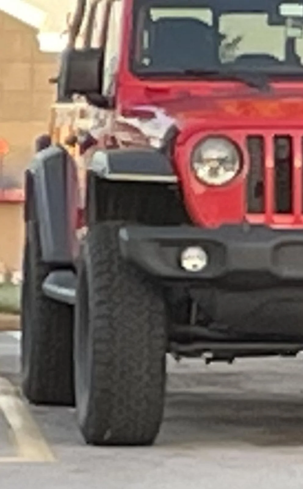

JPP Mopar off road wheels (and Jeep factory Xtreme with 35’s) are standard factory +12, thus they do not stick out and create all sorts of problems with wear, tear, and greatly increased stress loads on entire front end, buying yourself a ton of problems. His Rubicon is equipoed with the new (2018 and up) factory standard Advantec M210 wide front axle, so the wheels and tires are already moved out, a bit. Also, with 37’s, you’re buying extra trouble with rubbing/scraping, particularly when encountering obstacles off road. Now, for a mall crawler, you can get away with some deviation from factory stock +12. Depends what your goal is.
I have the wider axled 4:10 geared Max Tow. Even before the 3.5ā€ lift, so completely stock Max Tow suspension when towing, lock to lock steering turns and mild off-road flex the tires never rubbed. I do have AAL fender chop but still have the factory liners installed.
All of these front end wear comments usually are coming from web wheelers looking up info on internet. My experience is
1- wear will happen on a stock BS rig towing, dd, and off-road. I’ve always upgraded at least the ball joints and I-joints but on even stock components never had issue (well one exception a side flop in my 38ā€ swamped TSL tired MJ with 15x12 wheels, 2ā€ spacers on stock wagoner Dana 44’s. I turned the wheels hard to the left and flipped the Jeep back on all fours without assistance and did break the long side axle and U-joint. In 20 Min I had a spare axle and joint in and was back on the trail. I even drove home 70 miles with my repair and no issues).
