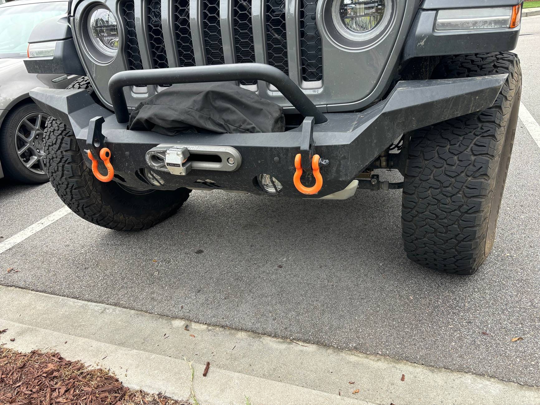

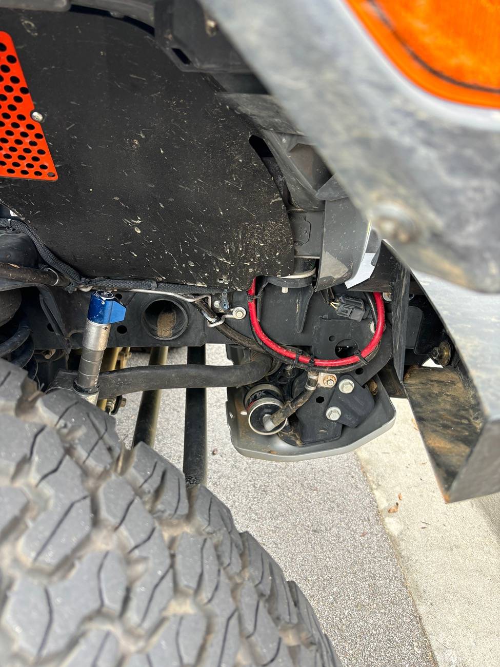

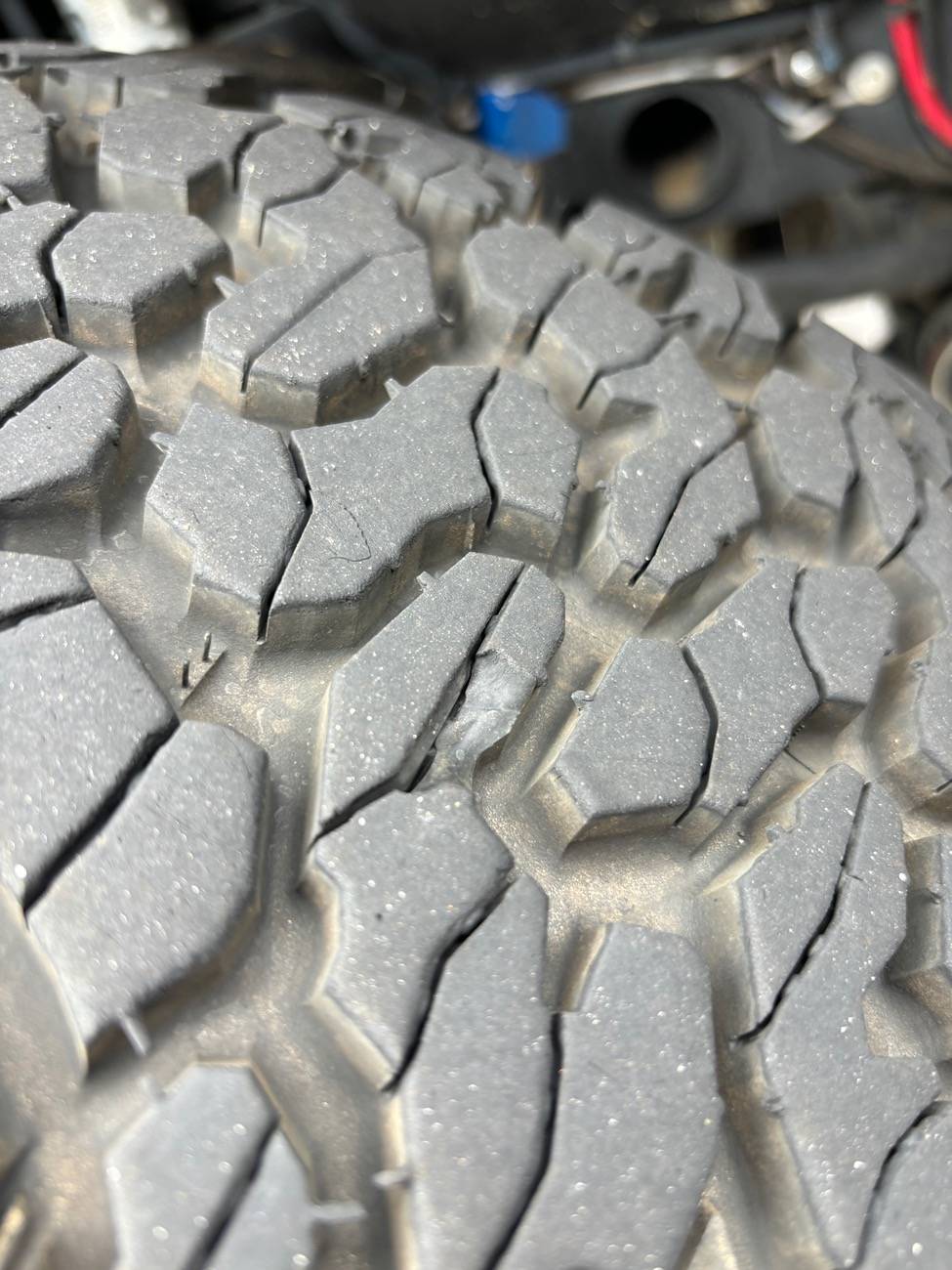

I was recently at Beasley’s knob trail, riding with some other jeeps from town. And I have run into some clearance issues with my full width Rugged Ridge HD bumper. This is the first time I have been wheeling with the recently installed 2 inch AEV lift and 37 inch KO2 tires. I have installed the APEX Autolynx which is phenomenal and gives awesome articulation.
With that being said I have ordered the Next Venture Adventure front stubby bumper and skid plate combo to cure the tire clearance issues. My question is -has anyone installed one of these bumpers on a Mojave here on the forum? I am looking to see what others have done about relocating the shock reservoirs. Thinking about either mounting them to the top of the front bumper or against the inner fenders. I have posted some pictures below. You can see in the tire lugs chipped where the bumper was catching!

Thanks for the link, I checked them out. However I do not think it will work because of how the winch tray is mounted.

With the new bumper why do you have to move the resi’s?
Well we will see when the bumper comes in. I was under the assumption it was more than likely made for a Rubicon and would have to change up resi mounting locations.

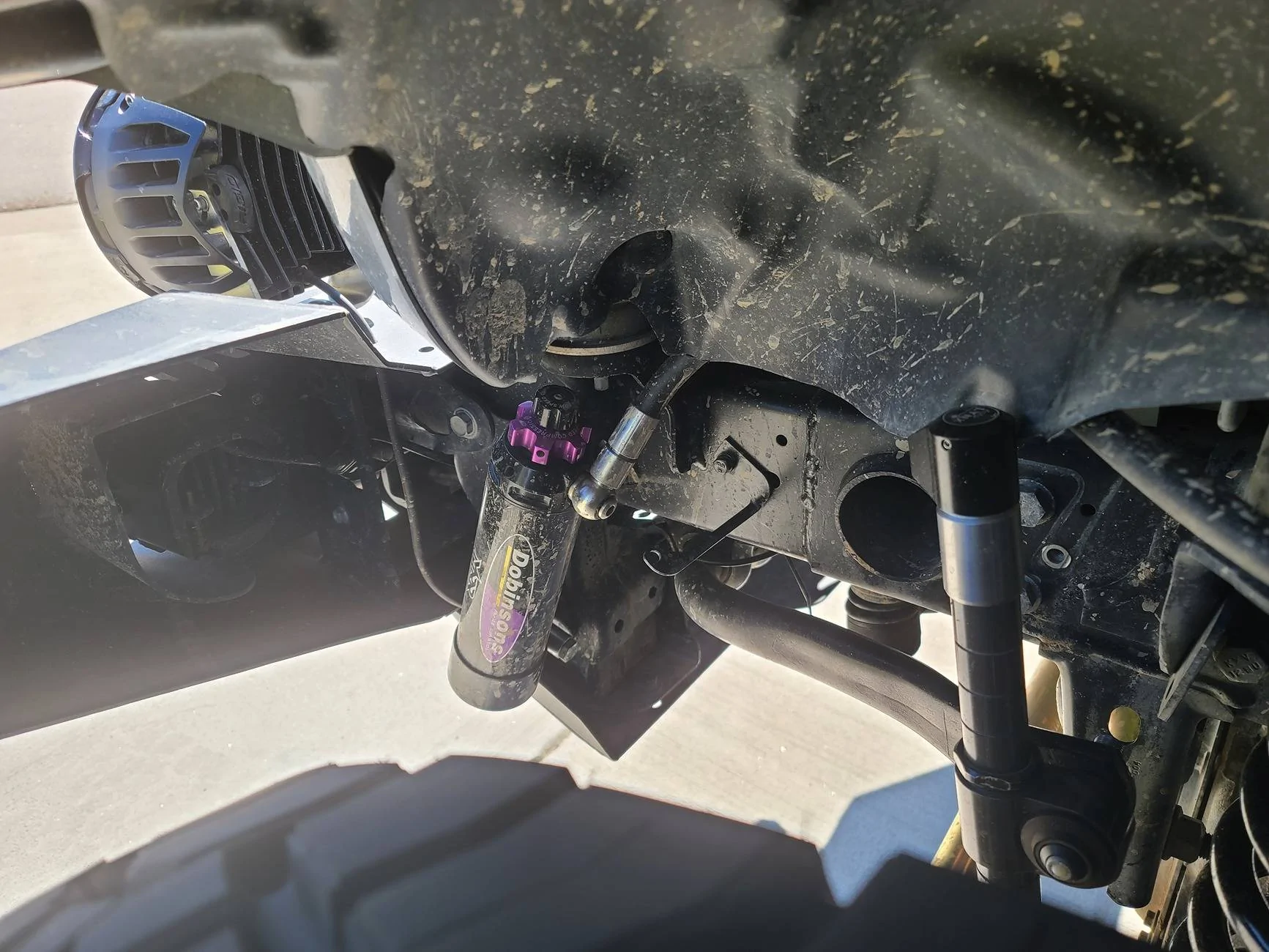

Dont have that bumper but I did move mine cause i didnt like how low it was and wanted a better location for reaching in and make adjustments. BTW, i also am running into clearance issues since I installed my Apex sway bar discos and will be making the change for a mid or stubby.
