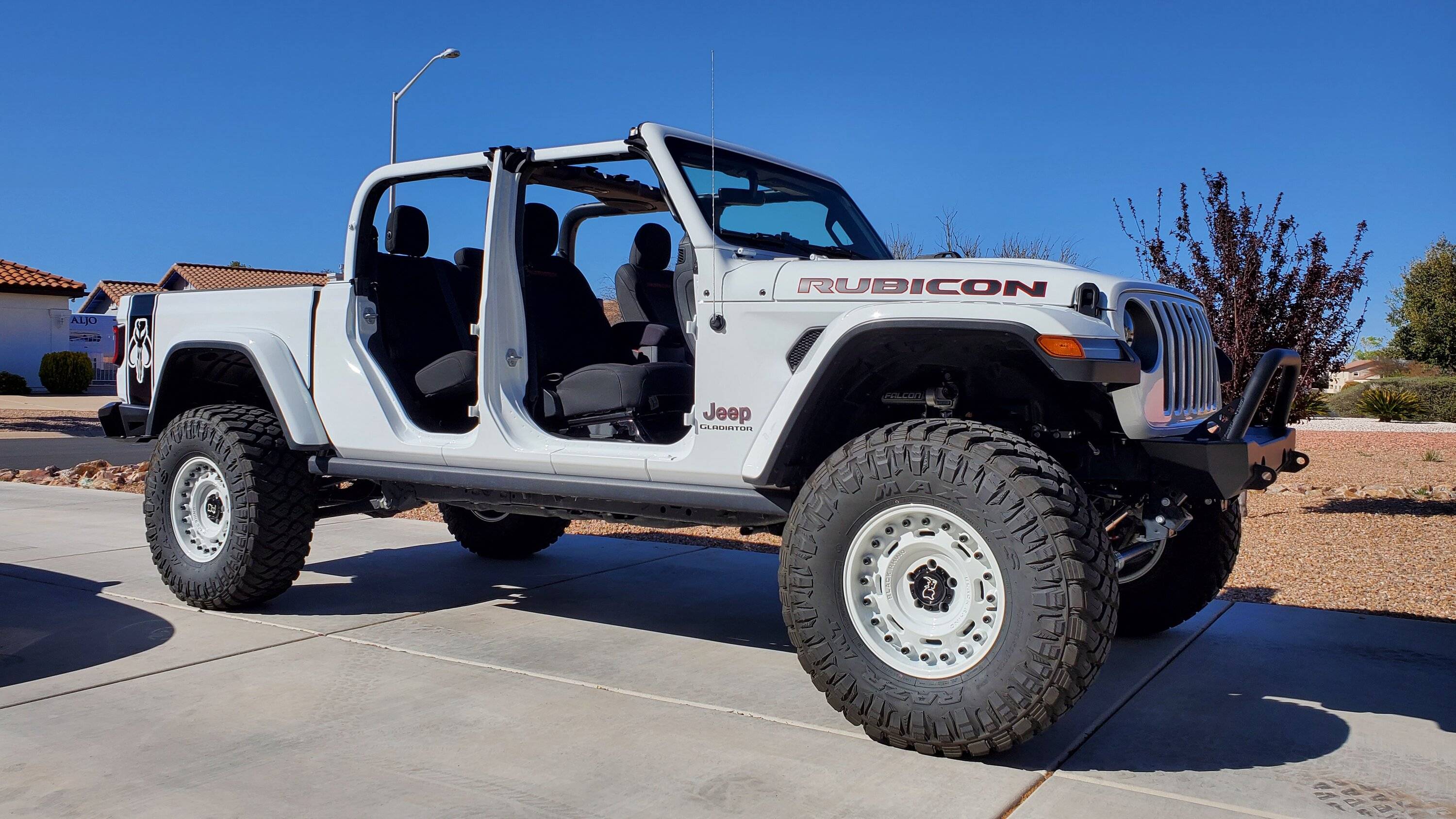

Has anyone tried running these on a 2.5” lift? Hoping there’s a way to make these work on a Clayton Overland Plus 2.5” lift with a stubby bumper or new fender liners.

The Clayton lift gives quite a bit of additional lift height and you have Rubicon flares so you should be good to go.
The Nittos, when on the vehicle measures out to about 36.5" in height. I'm running 37x13.50 Maxxis RAZR MTs that measure out right at 36" on vehicle with 28psi. I'm running the Clayton 3.5" lift and I have 9.75" of clearance between tire and flare in the front, and right at 10" of clearance in the back.
Jeep Gladiator Nitto Ridge Grappler 38x12.50r17 Load C 20230401_153230
