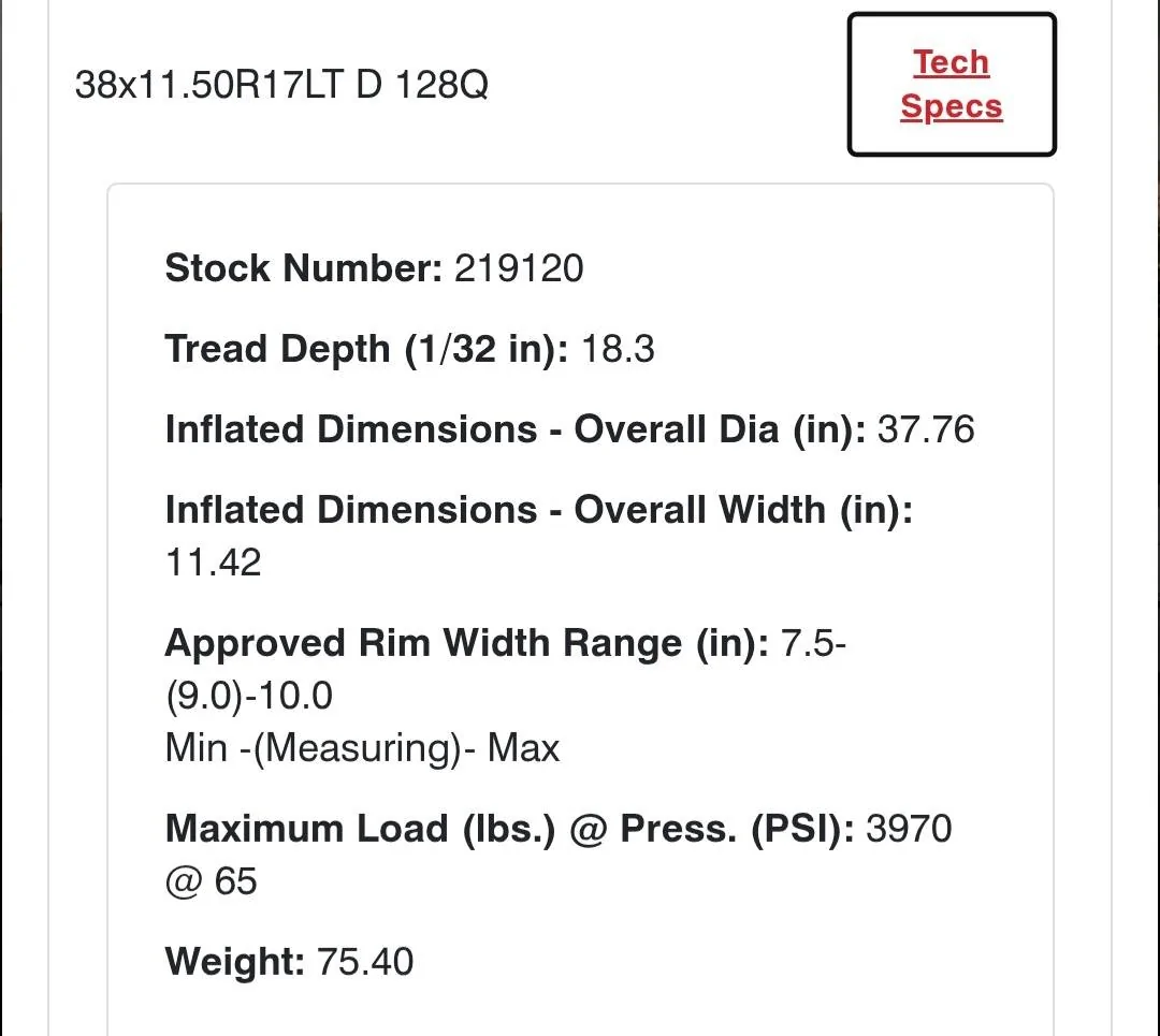

Were you using the KO2 in a C or D load range 37x12.50R17?
The C load at 63 lbs seems to be the lightest option for a 37 currently.
Tirerack has some info wrong. K02 from BFG sites is closer to 66lbs.

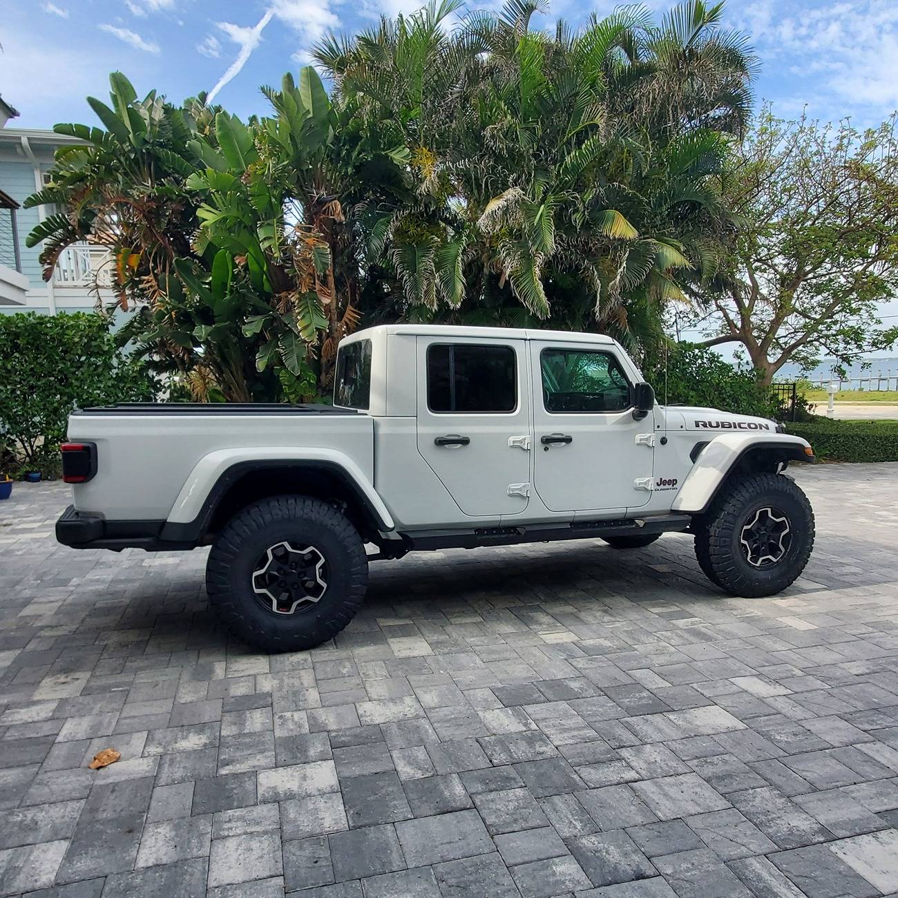

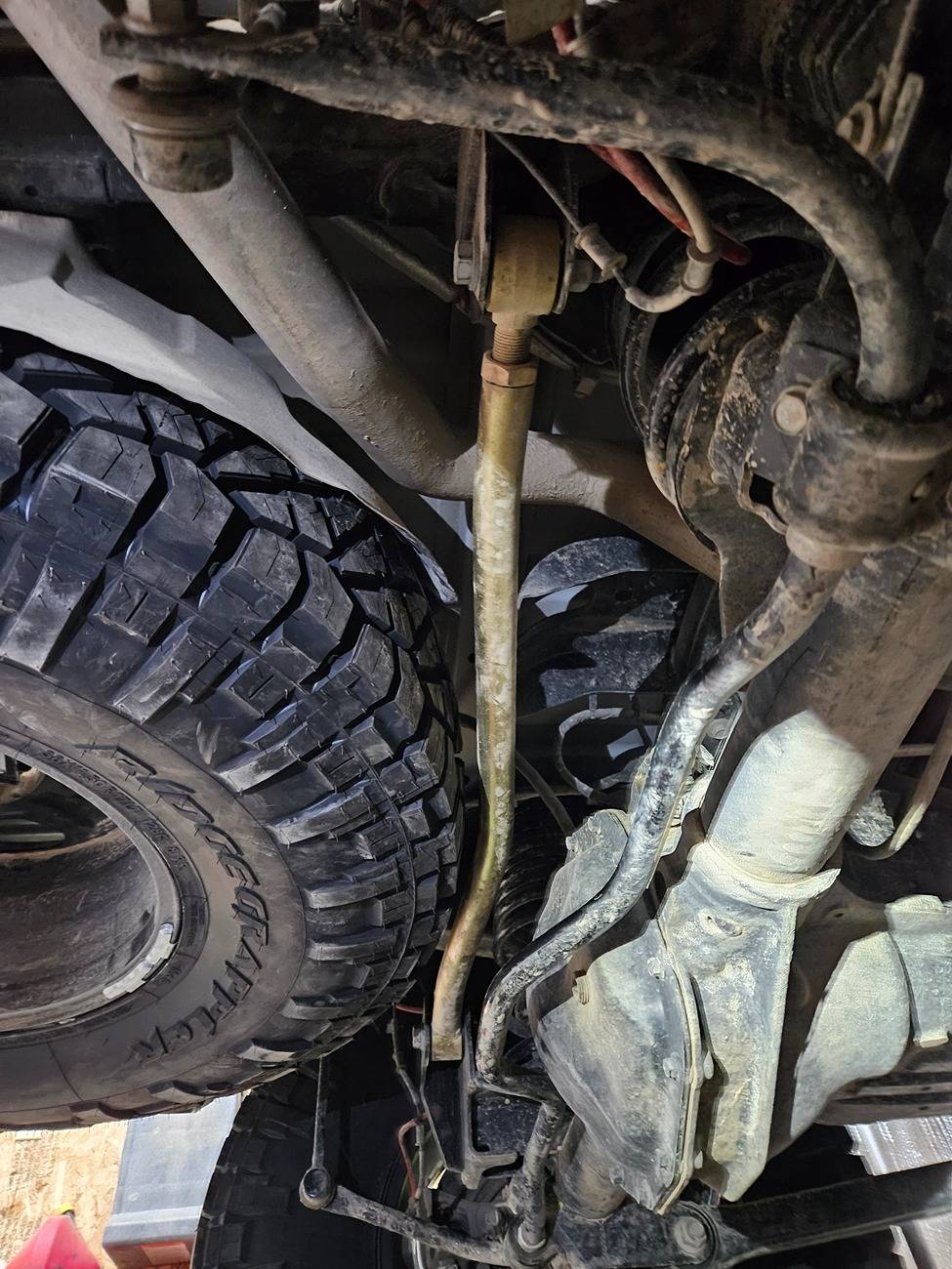

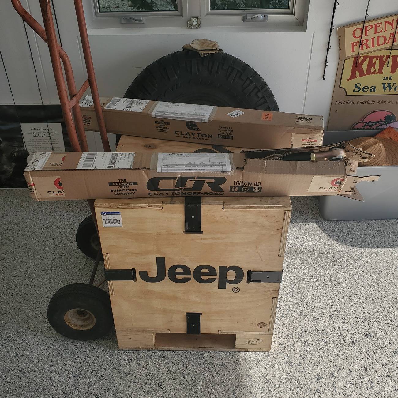

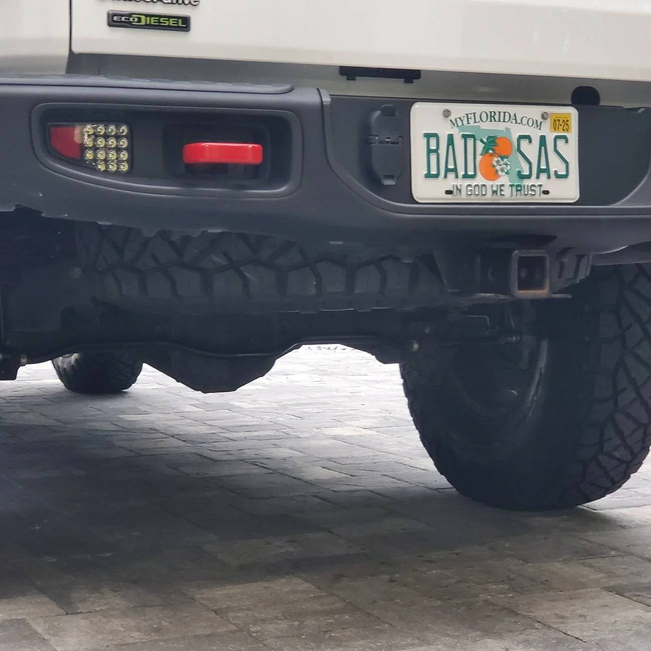

Putting it together Saturday
Mopar 2" Diesel lift
Keeping the 1.5" Teraflex Leveling kit and 2" Shock Extension on it now
Clayton adjustable front and high clearance rear track bars
Cut 1/4" off the receiver tube
Removed the heat shield and test fit an unmounted 38 under the bed earlier today and it fit between the hitch receiver and the oem rear track bar, Clayton bar will give adequate added clearance.
Spare will rest against the face of the frame rails ( not between ) and has over 2" of clearance to the exhaust pipe
Pics to follow up after install

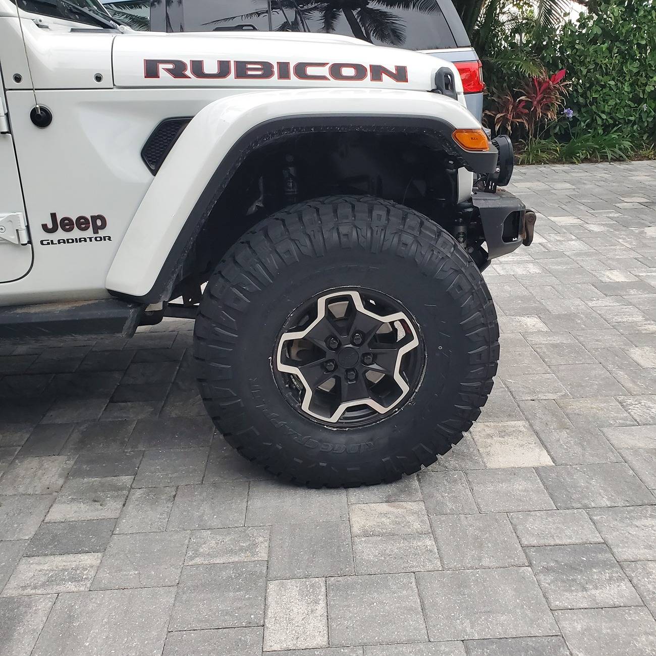

Rubicon EcoDiesel
Mopar 2" + Teraflex 1.5" level kit & 2" Lower Front Shock Extension kit
Clayton adjustable front and High Clearance rear track bars
Nitto Ridge Grappler 38x11.50r17
Full size spare under bed ( measured 37.75" on the rim )
Full Articulation
Measure point on front fender lip went from 40.5" to 44.5", expect a little settlement after a few miles.
Already loaded with Arcus bumper and Badlands 12k winch.
New Arcus ordered to replace rusted one.

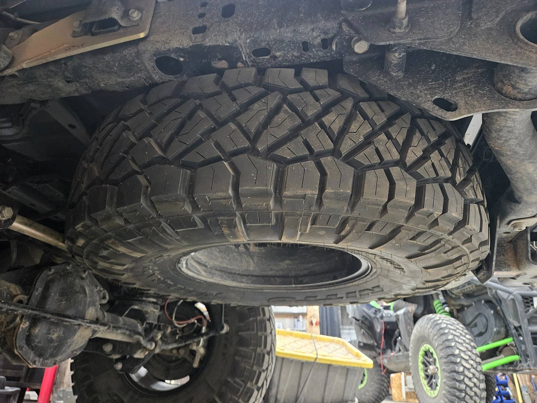

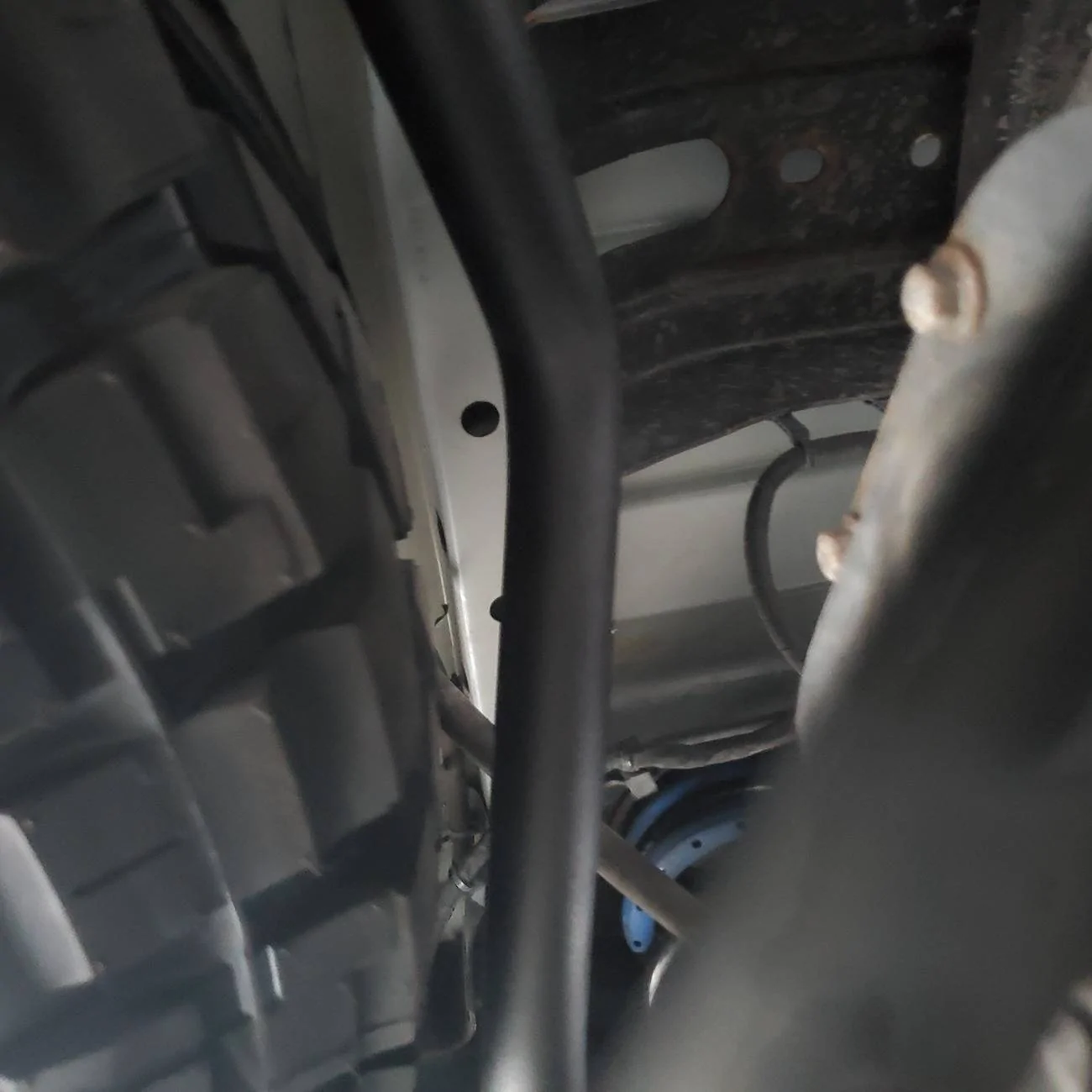

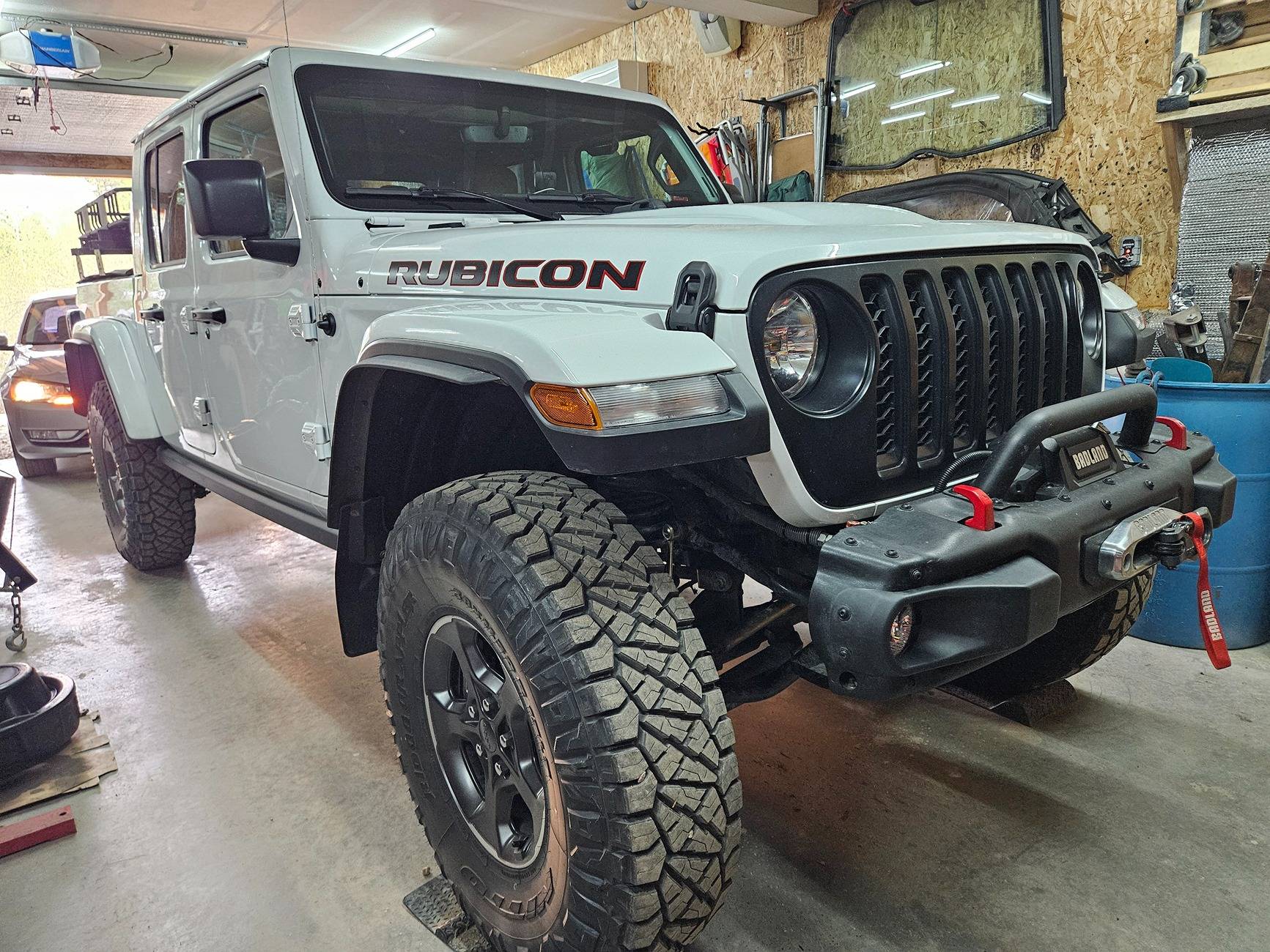

Toytech01
Feb 19, 2024
96
Garden Valley, Idaho
2023 Gladiator Rubicon Diesel

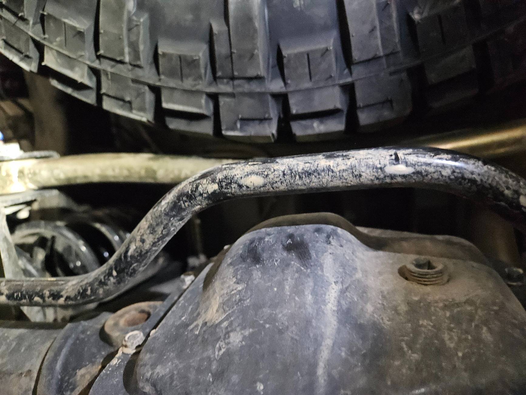

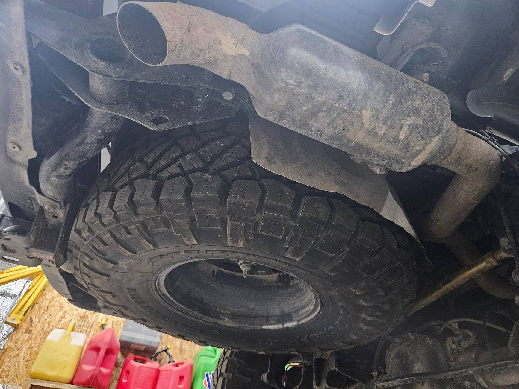

I got my 38x11.50r17 Ridge Grapplers mounted up as well. I had to adjust the steering stop just a bit so that the tire didn't rub on the driver's side upper swaybar end link. The spare tire fits great with the use of a BFH to move the heat shield a bit. I also took a flap disc to the rear receiver just to give a bit more room. I am super happy with these tires and still get great mpg!
Specs:
2023 Rubicon Diesel
-38x11.50r17 Nitto Ridge Grapplers x5
-Stock wheels with no spacers
-Front Teraflex 3.5" gas springs with 1/2" spacer lift.
-Teraflex lower control arms
-Metalcloak upper control arms
-Metalcloak front track bar
-Fox 2.5 Performance Elite 2-3" shocks
-2" Front shock extensions
-Tazer JL mini
-EOC stage 1 with DEF off
-Teraflex 1.5" rear springs with 3/4" spacer
-Stock control arms rear
-Metalcloak rear track bar.

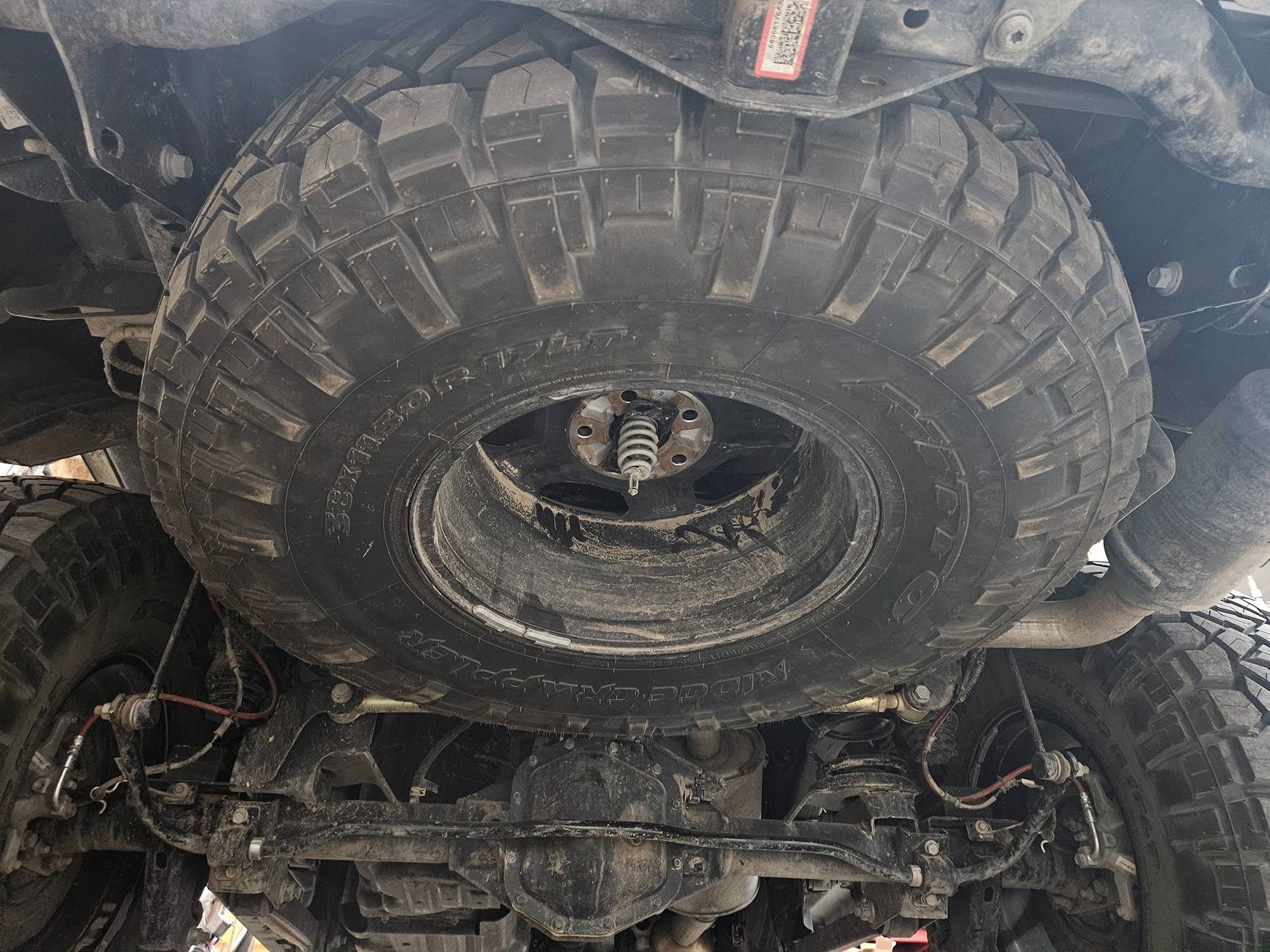

Wondering what’s the least amount of lift for the Mojave for these to fit…
Toytech01
Feb 19, 2024
96
That will depend on how you use your rig and how much flex you are wanting. I am building mine for mostly fire roads and camping with really nice street manners. I want to keep the tires tucked under the fenders instead of looking like a Bro-Dozer....

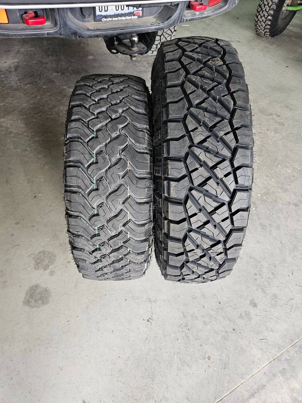

So the heat shield needs to be hammered? The receiver hitch needs to be cut? I don't remember that from another post? They said it was aired down to 5 PSI to fit it.
Does it fit complete between the rails or partially?
Toytech01
Feb 19, 2024
96
The heat shield on mine needed to be flared out just a bit and I ground down the hitch just to make it easier to get the tire in and up as high as possible without having to run the tire down to 5psi. I didn't grind any of the hitch welds so that it is still just as strong, just a bit off of the excess. The tire doesn't fit between the frame rails but does tuck up in there nicely. If you had a 12.5 or 13.5 tire, it would obviously hang down lower. Keep in mind that mine is a diesel when looking at the pictures.
Thanks for the info. I remember Chris from Northridger4x4 who did this 2 years ago said he was able to fit the tire between the rails all the way up. I was with no air or 5 psi I recall? He said he had to massage it in. One person said that after 5k miles it was fitting easy when they did their 5 tire rotation. Hmm, I have the 37x11.5x17" im going to mount soon but good to know about this option for 5lbs more per tire.

With my 37s (Yoko X-AT) I’ve found that if I don’t deflate all the way, it won’t nestle between the rails. Even then, if I deflate to say 5 psi at my home sea level, and drive to elevation (where most of my off-road trips are) the tire will have pushed out below the rail on one side.
So now I pull the valve core and just leave it totally flat, with a loose cap for dust. Stays put that way. Obviously I have a full tire kit permanently in the truck to reinstall the valve core (a half a dozen spares in case I drop it)
