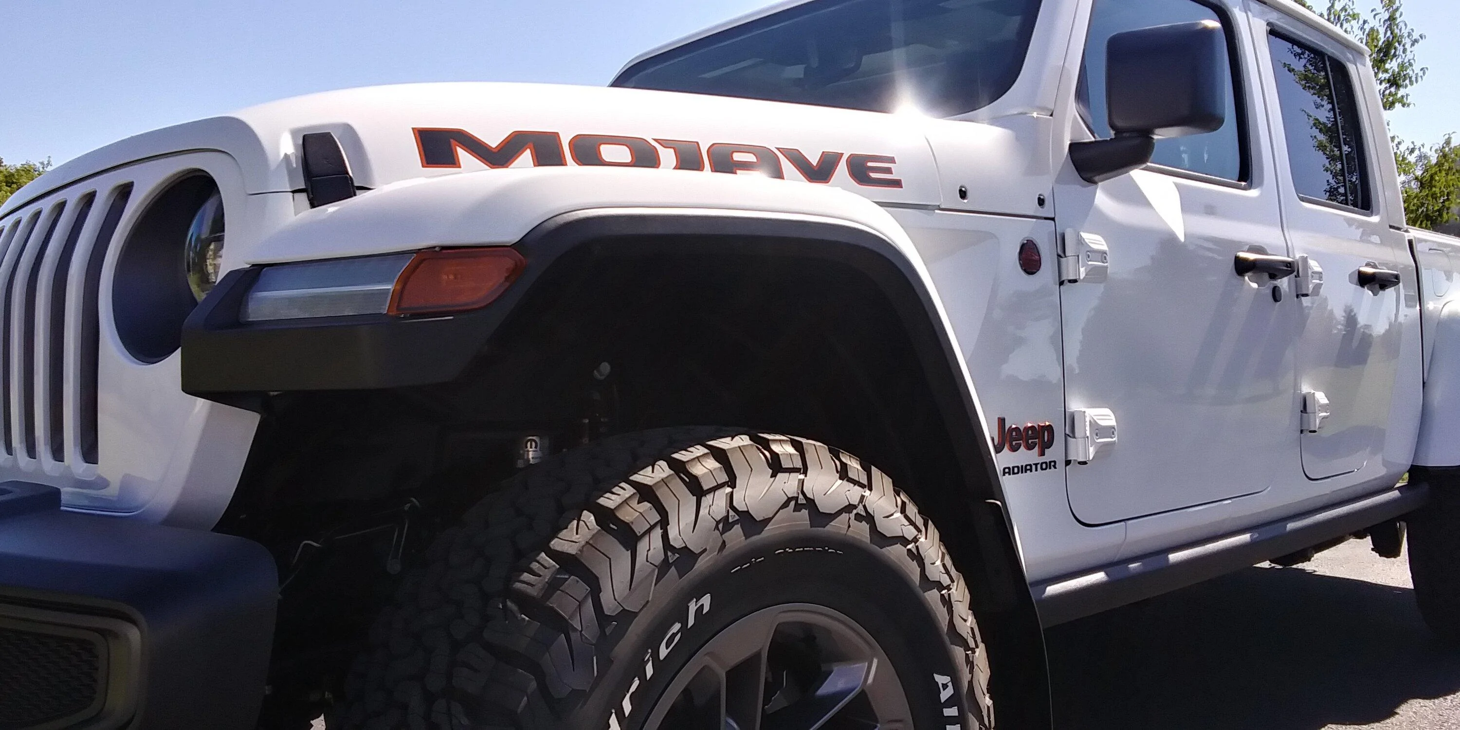

Both the BFG T/A K02 and Nitto Ridge Grappler are a solid choice for consideration for your Gladiator as noted by the first hand comments from members running them.
