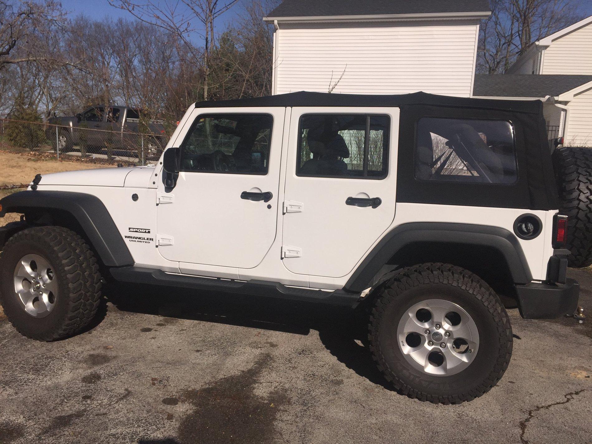

This was my JK on Firestone MT2 35x12.5r18. Didn’t look goofy to me.
