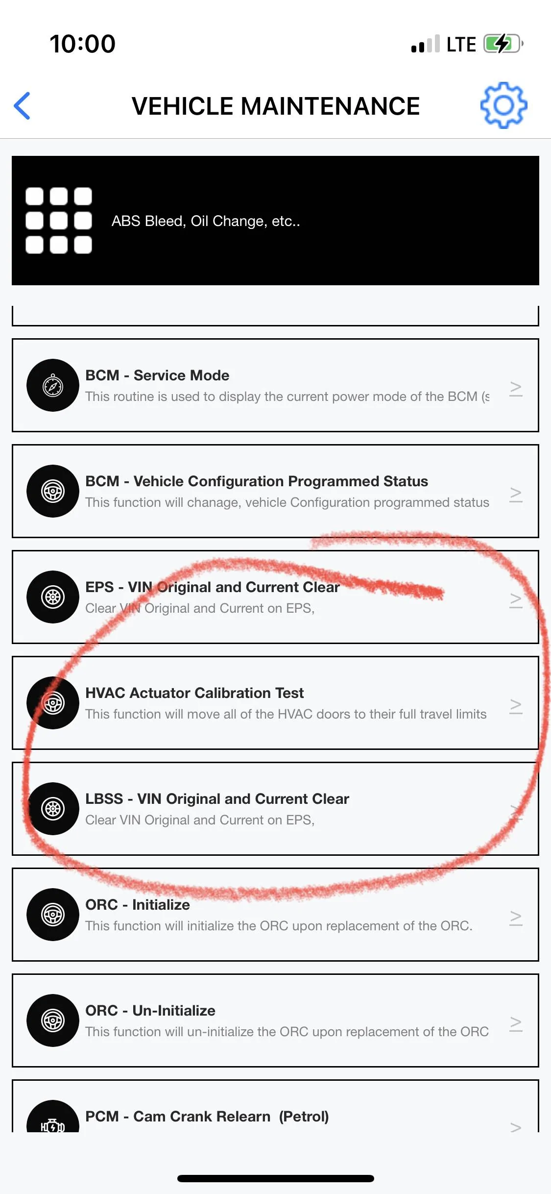

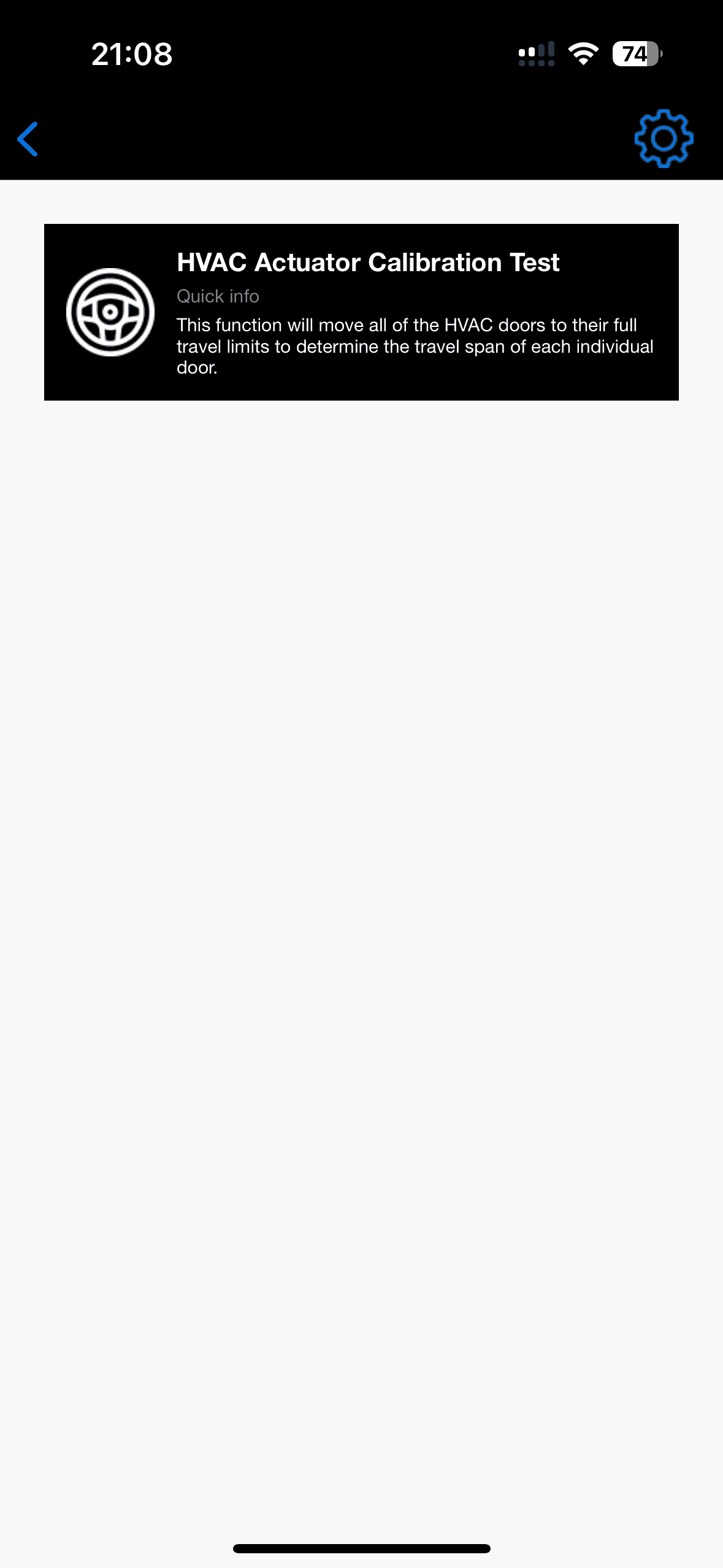

So the defrost works with the manual controls and NOT the radio.
Maybe an option inside Jscan can reset that? I looked quick and found this, but im on the road so cant dig into it
Could also go to settings in radio, scroll to the bottom, and hit “restore settings to default” and see if that corrects it.
So i try jscan, But can Not run the Test …

Also need JSCAN license for that VIN.
Was it mentioned whether or not he had a license for jscan for that vehicle?

@Hootbro @ShadowsPapa
?‍♂ i forgot that part.
in the Jscan app you need to pay to use it with your gladiator. Its a one time charge for each VIN you get.
you also need the bypass the security gateway as mentioned. There are a couple options. You can get a bypass module and install that. Or Use the bypass cable @Hootbro linked.
personally I use the bypass module.
https://www.holley.com/products/tuners_and_programmers/cables_and_adapters/parts/18GBJ
the first 1:34 show you what you are disconnecting and how to install the bypass piece.

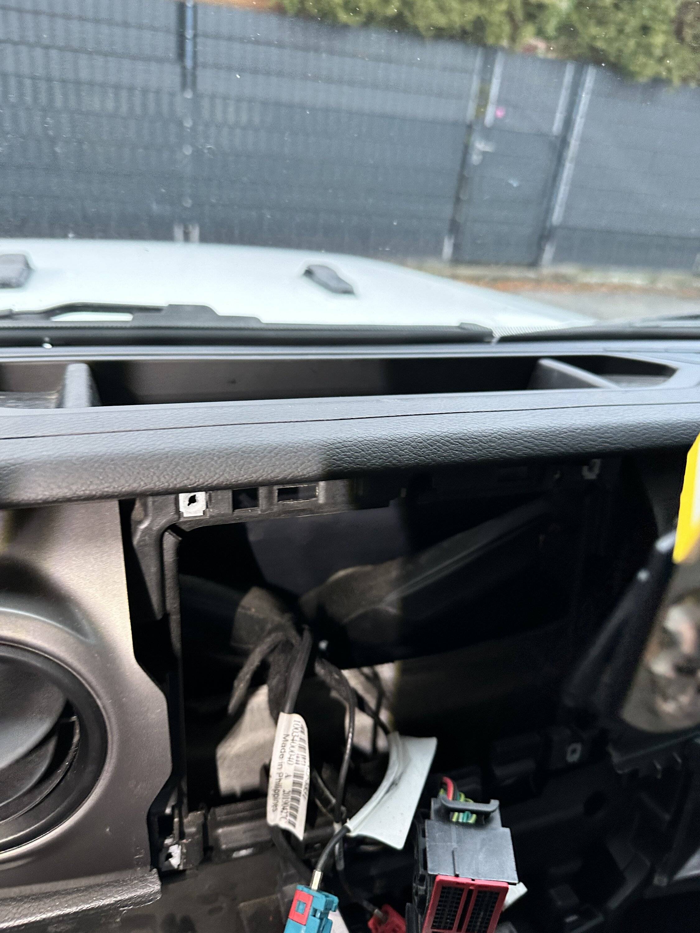

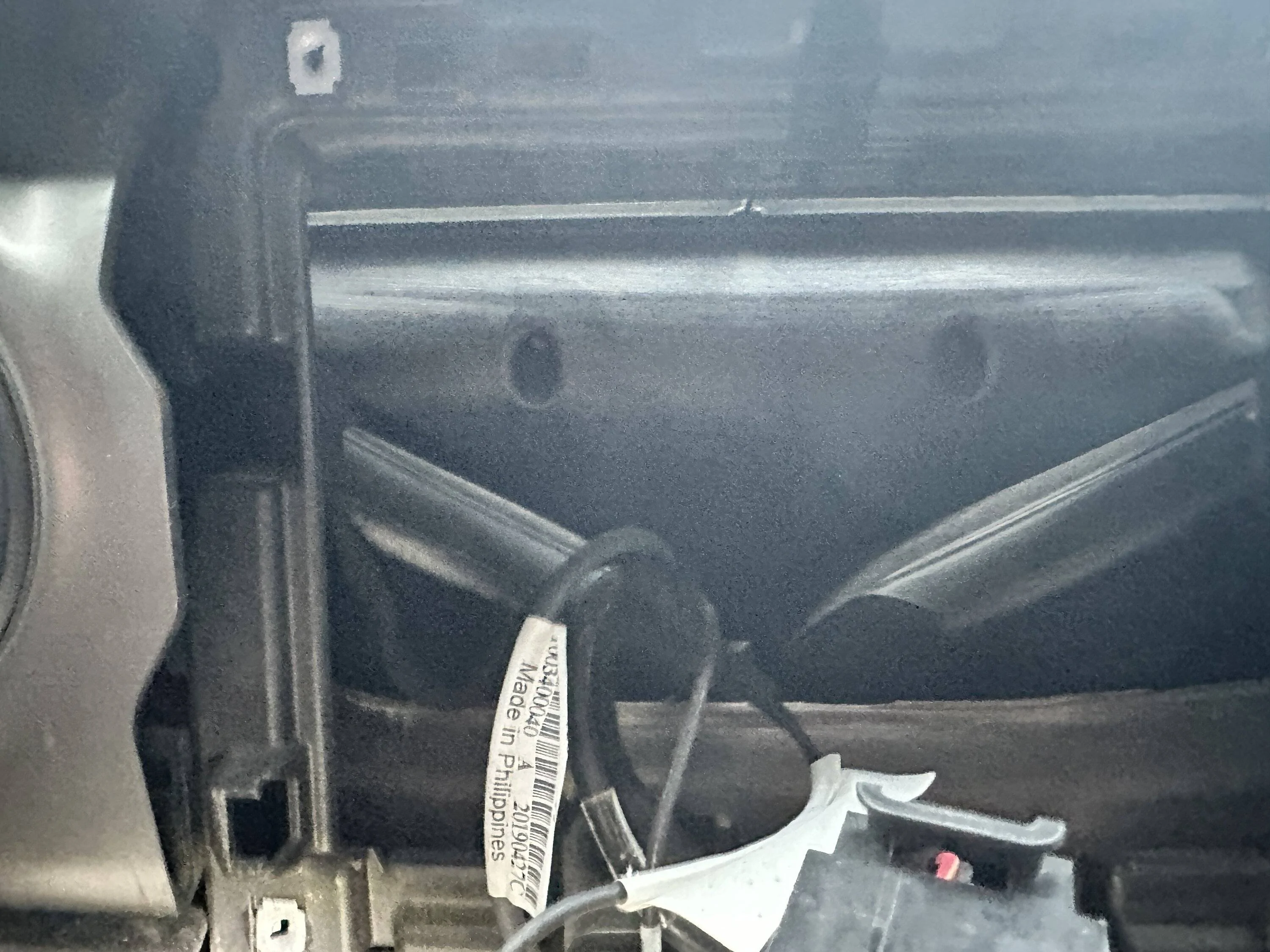

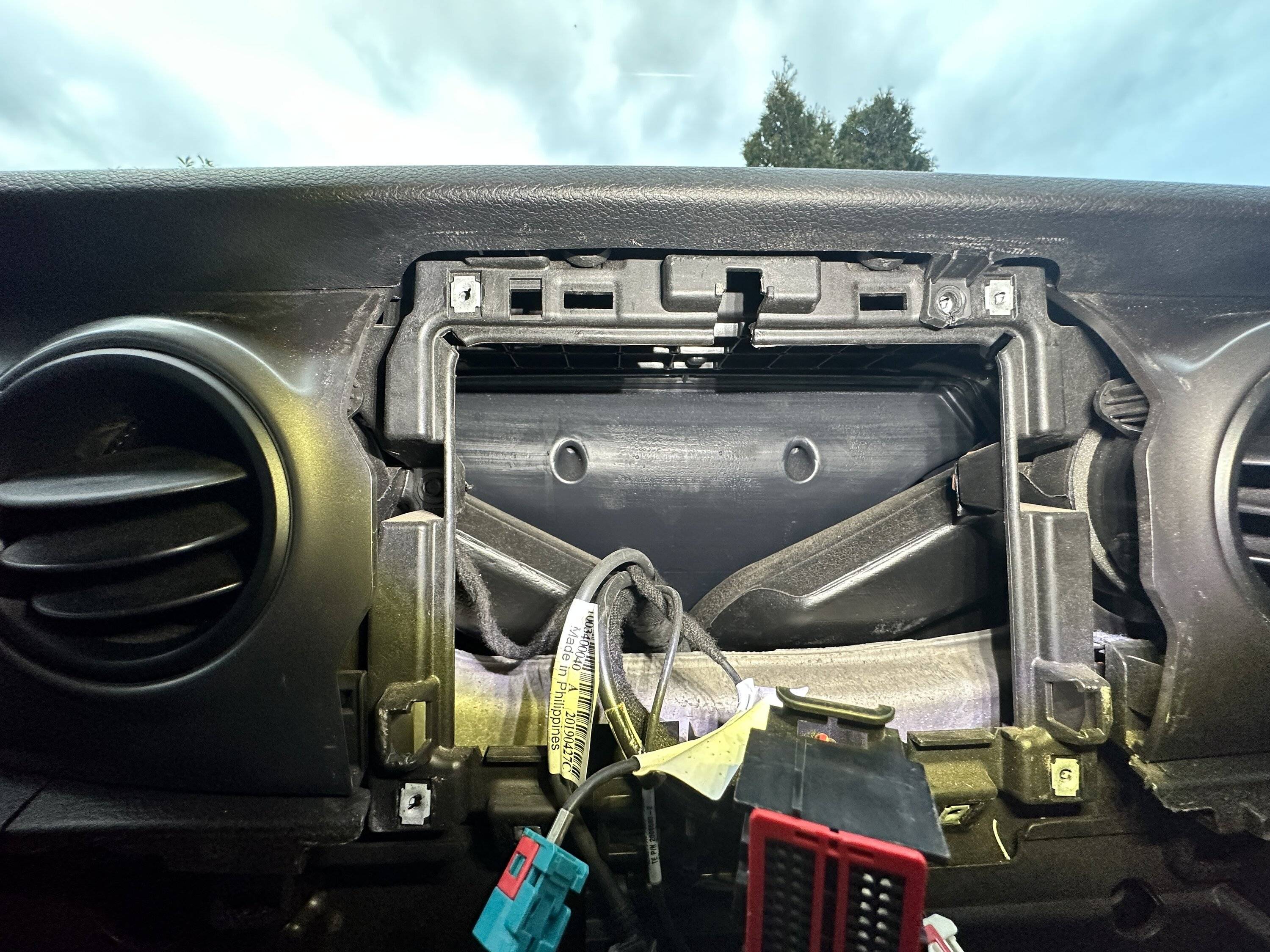

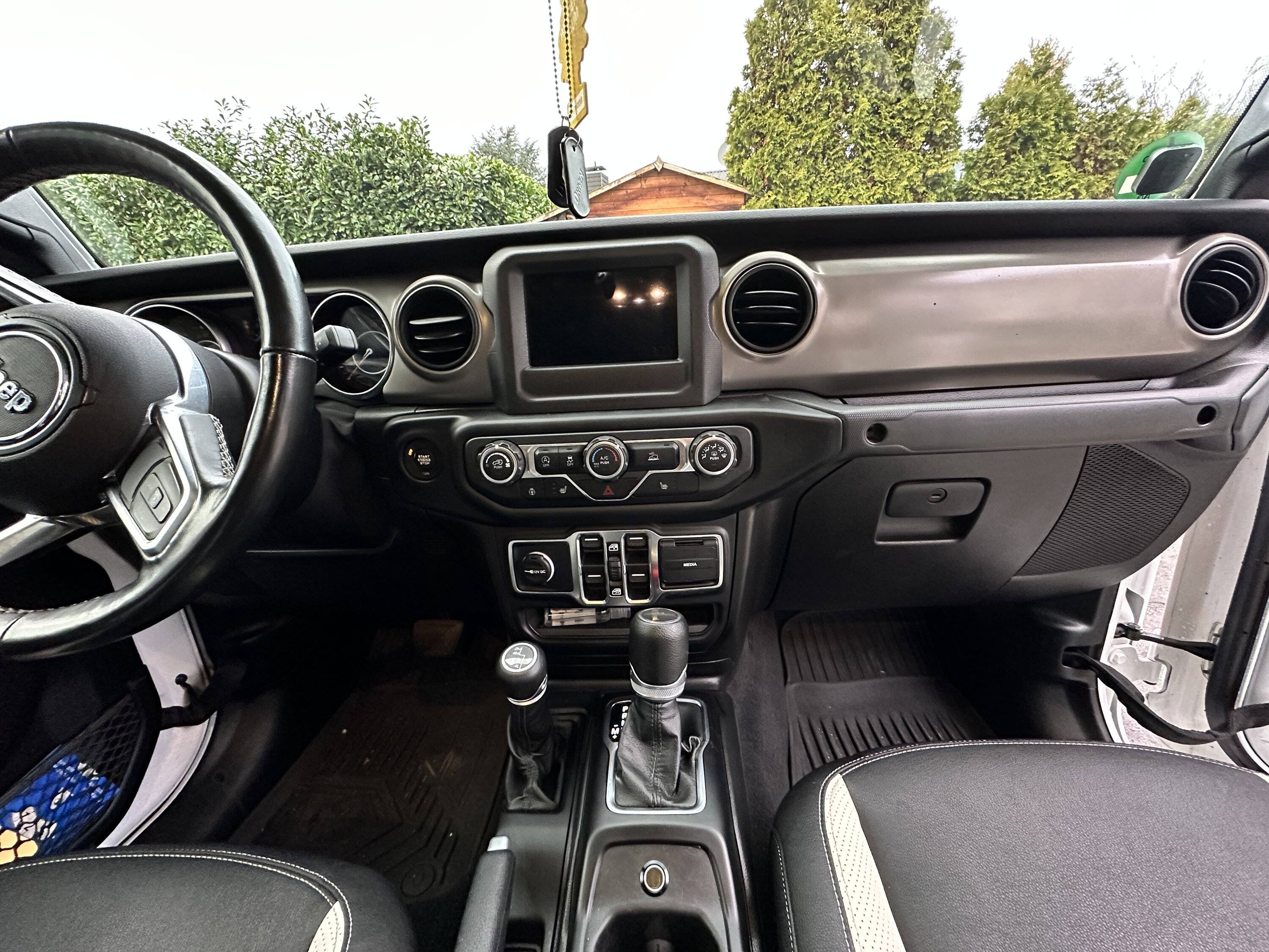

Hello again,
i small update from my Problem...
i opened the dash a saw this..
There is nothing where the air can go to the window i think.
somebody see this before?
no tunnel or something
hope u now what i mean :)
Jeep Gladiator No Air Flow on Windshield :-/ IMG_0493
Jeep Gladiator No Air Flow on Windshield :-/ IMG_0492.JPG
Jeep Gladiator No Air Flow on Windshield :-/ IMG_0490.JPG
