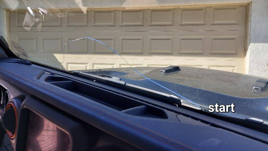

In a number of submitted photos the cracking begins in nearly the same location, looking out,the cracking begins at the bottom of the windshield slightly to the right of center. I live in Colorado and travel frequently to the Mojave desert, so there are major temp fluctuations

This issue can also be caused by a nick on the edge of the glass during installation. Several years before I retired glass company came out to the fire station and replaced the windshield on the engine. Next morning during daily checkout when the pump was engaged the windshield cracked from the right bottom corner. Had a small nick at the origin of the crack.

And it doesn't take a nick as in "there's a chip out of the edge" either. I broke a nice windshield years ago when the trim removal tool I was using touched the edge of the glass - ting! And the crack slowly crawled up the windshield. (I was not happy but it was my own doing).
When I got the trim off, you could hardly tell where the tool touched the very edge of the glass.

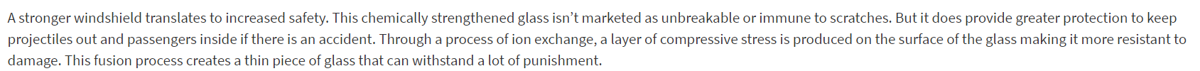

MOPAR misleads in their marketing materials.
This is the truth -
This chemically strengthened glass isn’t marketed as unbreakable or immune to scratches.

Look familiar?
