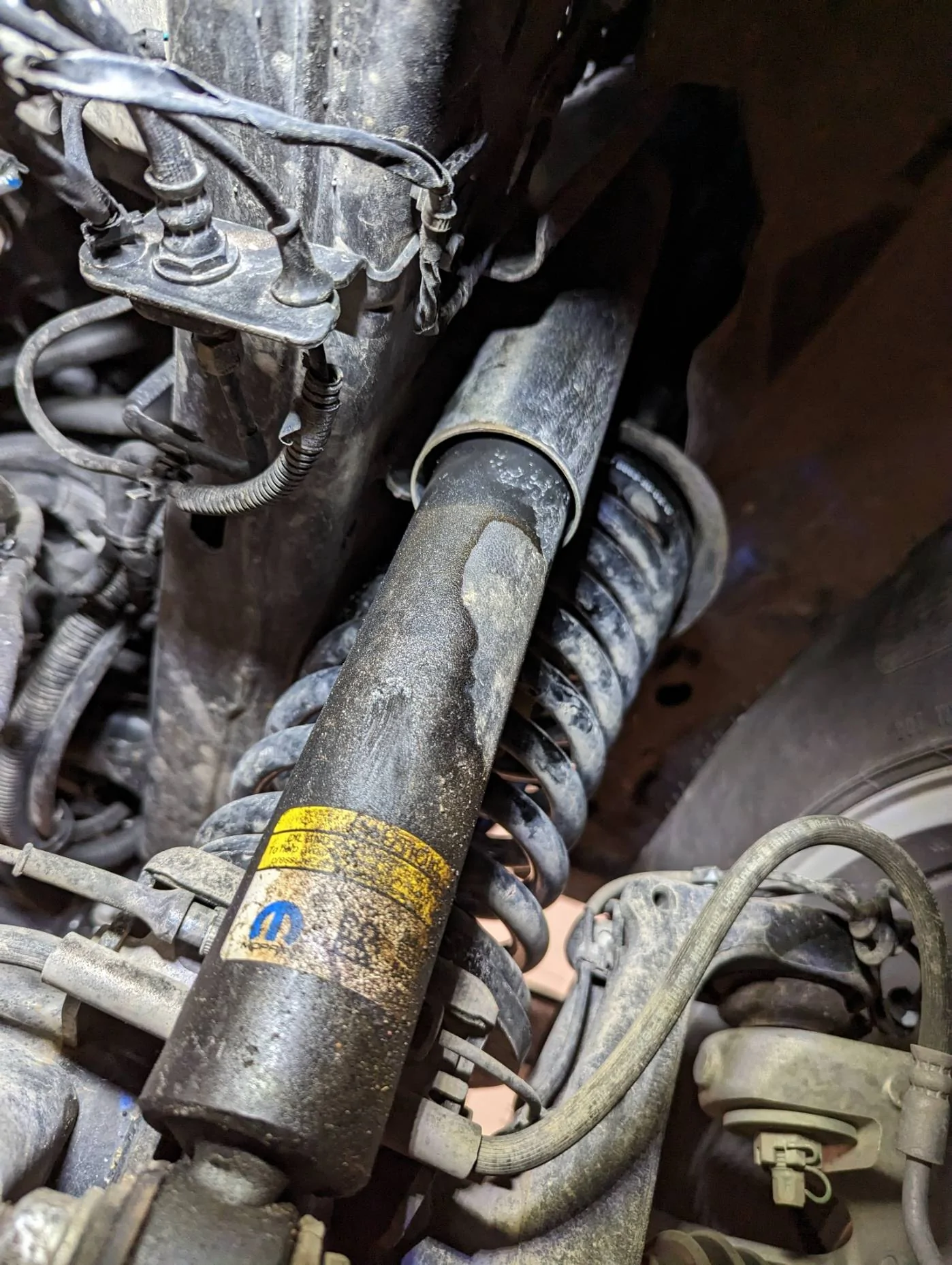

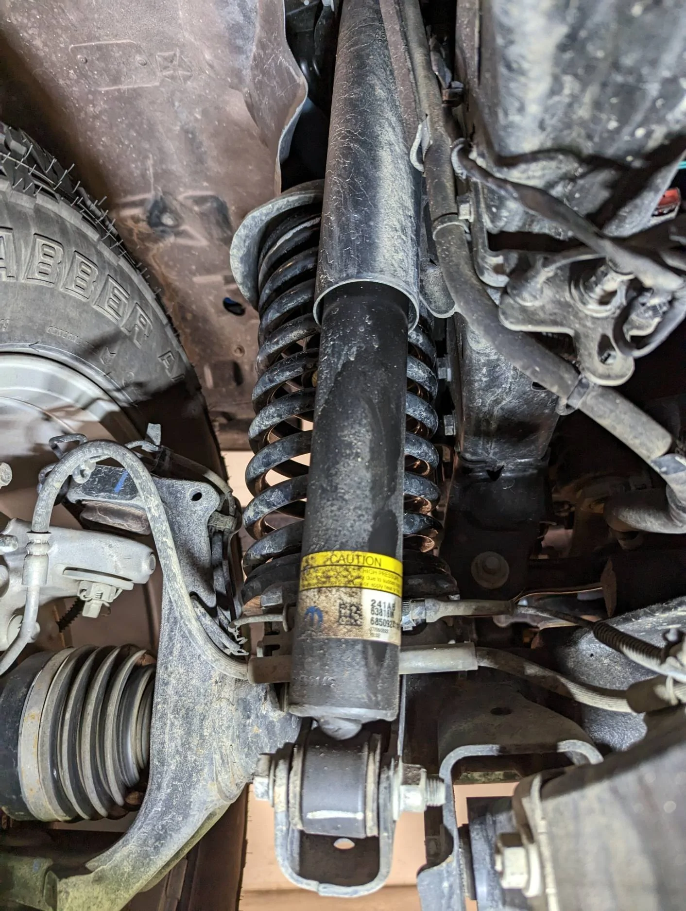

Bingo.
Front:
Extended: 26.03"
Compressed: 16.35"
Rear
Extended: 26.88"
Compressed: 16.90"
The 2"-4" shocks are
Front:
Extended: 28.06"
Compressed: 17.36"
Rear
Extended: 27.79"
Compressed: 17.41"
