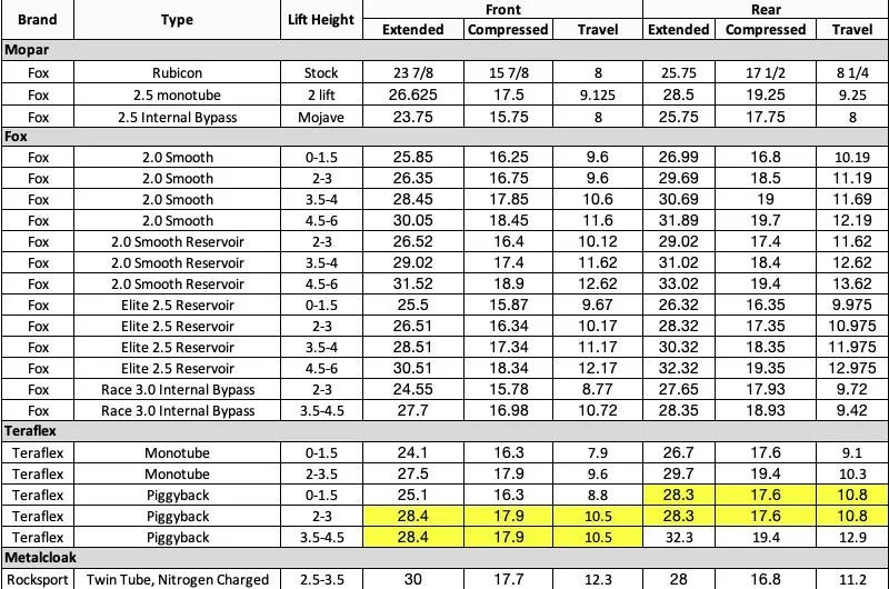

2. Just about all the aftermarket monotube shocks are going to be based off the Rubicon for valving.

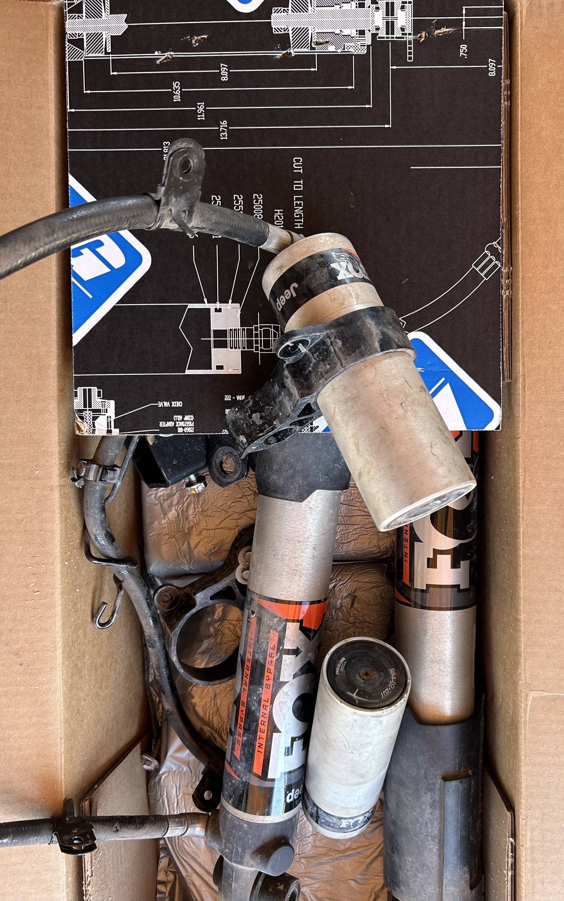

2. and that's why there's hesitation - part of the reason for this level of truck is because of the ride and I've tried to be careful to preserve that - thus my spring choices this time around compared to the 2020 which in the end didn't ride or handle quite as nice. (The max tow springs, Rubicon springs and Rubicon shocks are boxed up and stored away)

LOL - seriously - a full set - but are those REALLY better than the wimpy Rubicon Fox shocks?
They are a serious consideration but for the money - but may still work around that if I can collect a bit of what's owed me on some things. If I did aftermarket, that's probably the direction I'd go.Kind of not related but really isā¦. I installed a set of Bilsteinās on a crew cab Chevy that porpoised so badly on bridges with uneven expansion joints it felt like the front end was coming off the ground. By installing the upgraded shocks was an incredible change. While not be harsh at all, the body control was phenomenal and very controlled.
But - does anyone have them? (if so, likely not at the Northridge prices)
