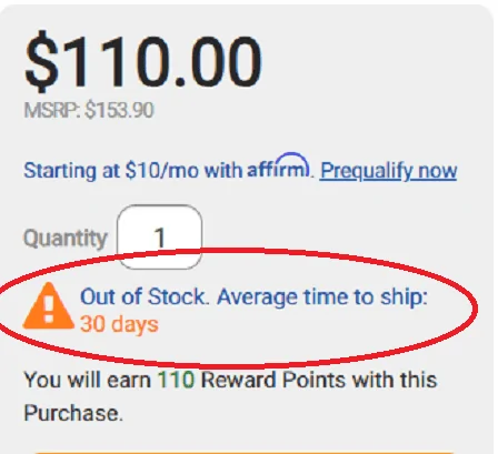

Looked on Northridge site - Bilstein shocks ->
:headbang: - this is funny, or sad -
Jeep Gladiator No shocks 1689824355298
Average time to ship is 30 days then another week after that?
Good grief.
Good grief.
